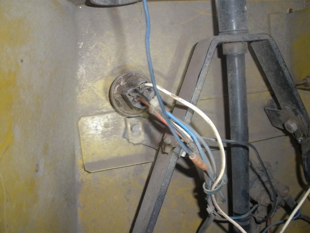

Hi,
I have an old Greenfield Ride on mower that has never been started with a key, it's always been stared using the pull rope, very tiring after awhile.
I would like to get this machine to start as it should, that is, with use of key and ignition wires to the starter motor.
It has been used by other people in the past and looks like some idiot never wired it properly, the safety switch wire that goes to the back seat has disappeared long time ago.
Can anyone show / let me know which wire goes to where? I had a look at the diagram but I cant read diagrams that well. I'm 56.

G'day Bondy and Mark, Sure looks like a bit of a rats nest. The first thing I noticed is that there are two solenoids and you only need one. In the original engine setup the one mounted to the frame was used and then the Honda was fitted that has its own next to the starter. I'd be using the new one on the engine. There also looks to be a good few cut wires and joins. Can I suggest you draw a mud map of all the wiring and how it connects and colours so we can see what you've got. It's a crummy job but it's maybe the best way of knowing what you've got. It may end up that the best thing to do is just rewire the thing from scratch.....but let's not get carried away just yet  Also, a question for Mark. I may learn something here. I thought/ assumed that the seat switch/blue wire is a magneto kill, not a starter control.

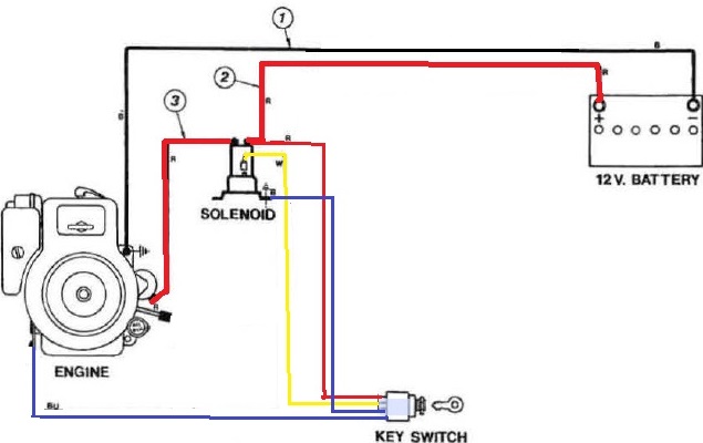

Thanks Bondy your response helps alot. I stripped back the wiring to its bare bones, so you are looking at less. ![[Linked Image]](https://www.outdoorking-forum.com.au/forum/uploads/usergals/2015/11/full-4730-25578-mark_ii.jpg) G'day prd, does this look OK to you? Its what I think it should be. You can add in the saftey switch later. Try to get it working first. So, The heavy red wires are switched closed by the solenoid, when the ignition switch is turned to start. At ignition switch red wire is switched to yellow wire (white on your machine). When ignition switch is turned to stop, the blue wires are switched together, this is earthing out the magneto, stopping spark. Can you test to see if you have 12v at the ignition switch. 2nd image, brown looking wire. If not is their a blown fuse in that wire. Is there power on any of the other wires? Remove any unnecessary wiring, it just adds to the confusion.

Whoops, Sorry Mark, I didn't see that you'd already replied before I hit send. That's nice and clear. Excellent work. That sketch shows the original solenoid. You can use it Bondy if it makes things easier for you. I like the idea of using the nice shiny new one  No matter which one you use, the wiring hook up is the same. The only thing we haven't talked about is the charge (alternator) hook up. I'd say don't worry about that right now. Concentrate on the start. The alternator is only one more wire but we can deal with it after the beastie starts!

Thanks mark electric,
I'm impressed with the simple wiring, does take the confusion out of it. I have not tested the wires as yet, will check the wire using voltmeter tomorrow. I don't think there is a fuse but will go over the wires to see if there is a fuse.

The drawing made by Mark electric is good and clear, I'll rewire the mower to replicate it.

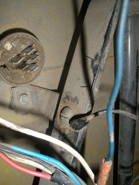

Hello prd and Mark electric, Sounds like what it is. First things first. I disconnected the original wires going to the original greenfield solenoid. I have enclosed pic of original Greenfield Solenoid. I disconnected the wiring plug that went to the key (Ignition) switch. See pic of key switch with 5 spade terminals and disconnected wire plug. Key switch is a bit dirty looking. I notice there is some wire missing from the battery end of the cables, I assume the missing cable is related to the seat switch. I could not say if the actual seat switch is still under the seat or has been removed. Will check tomorrow. I connected the positive (Red) cable from the battery directly to the solenoid on the Honda. I have left all other wires disconnected at this stage. See further pics There seemed to be a lot of wires going to the original solenoid and quite a few wires coming from the switch. Mark Electric...with reference to the less wires drawing you provided. Am I safe to assume that's the solenoid on the Honda motor or is that the solenoid on the frame of the Greenfield Mower? I've seen a few red wires on that Greenfield. I need to know where that small red wire that goes to the solenoid actually comes from. As there should only be one solenoid and not two, I've removed the original Greenfield located on the frame within the engine bay. I'll only use the solenoid that's connected near the starter on the Honda Motor. Here are the pics...It was a humid and sweaty day. ![[Linked Image]](https://www.outdoorking-forum.com.au/forum/uploads/usergals/2015/12/full-9759-25593-ignition_key_switch_on_greenfield_copy.jpg) ![[Linked Image]](https://www.outdoorking-forum.com.au/forum/uploads/usergals/2015/12/full-9759-25594-another_wire_earthed_to_frame_from_key_ignition_copy.jpg) ![[Linked Image]](https://www.outdoorking-forum.com.au/forum/uploads/usergals/2015/12/full-9759-25595-negative_wire_is_earthed_to_chassis_frame_copy.jpg) ![[Linked Image]](https://www.outdoorking-forum.com.au/forum/uploads/usergals/2015/12/full-9759-25596-original_greenfield_solenoid_copy.jpg) ![[Linked Image]](https://www.outdoorking-forum.com.au/forum/uploads/usergals/2015/12/full-9759-25597-red_wire_conencted_to_solenoid_direct_to_positive_battery_lead_copy.jpg) ![[Linked Image]](https://www.outdoorking-forum.com.au/forum/uploads/usergals/2015/12/full-9759-25598-top_view_of_solenoid_on_honda_copy.jpg)

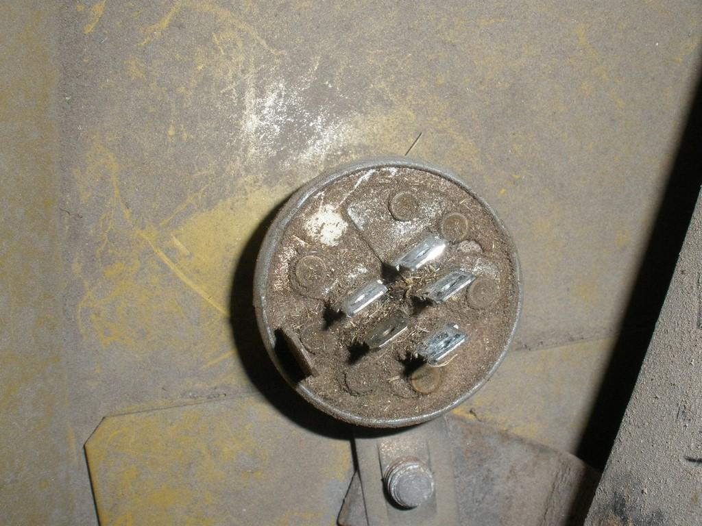

Hello Bondy, First, I never assume that a solenoid or the ignition switch is serviceable, especially on a machine that is not starting.
Yes use the Honda solenoid. Just means you may have to extend some wiring.
Watch a utube video on how to test an ignition switch, using the continuity/bell setting on your multimeter. If you clean the back of the ignition switch you may see some letters that will help.
M - magneto S - Solenoid L - lights G - Ground / Earth B - Battery
The small red wire feeds 12v from the solenoid to the ignition switch terminal (B - Battery). It originates from one of the main terminals on top of the solenoid, must be the battery side terminal.
NOTE: In my wiring diagram, the main battery earth does not have to run from the battery to the engine, it can be connected to a good chassis earth near the battery.
Also watch a video on how to test a solenoid, it will help you understand and make your wiring job easier. cheers

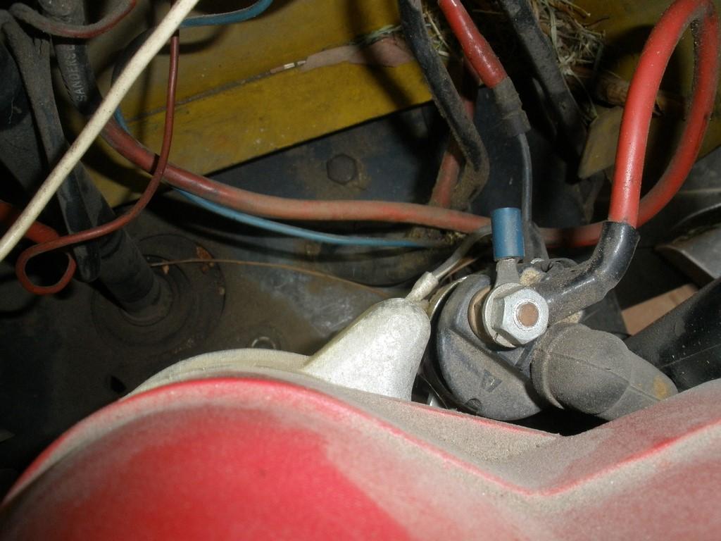

Mark, have a look at Bondy's close up photo of the Honda solenoid. I think it's stuffed. The can has been knocked and is loose?

G'day Mark and prd, Well, you could be right , that solenoid on the Honda mower is bit loose and does move slightly, I had to hold onto the top of the solenoid to stop it from spinning when I undone the nut holding the battery cable. Anyway, I've placed the red battery cable back on the Honda solenoid. Those letters on the Ignition switch was hard to find, the buggers were stamped on the other side of the spade terminals. I had to use good light and angle reflection to see them. I've marked the letters on the spade terminals facing outwards for easier identification. I'm not keen in buying a Honda Solenoid to replace the other as it looks like a pain to remove it from the motor. I noticed a black wire from the Honda Solenoid, could be attached to a white coloured wire going to the ignition switch harness. The Black wire with white stripe coming from the Honda solenoid is earthed near the solenoid. I have tested the ignition switch without wires, it's good to use. I've attached additional pics. ![[Linked Image]](https://www.outdoorking-forum.com.au/forum/uploads/usergals/2015/12/full-9759-25635-alternate_view_copy.jpg) ![[Linked Image]](https://www.outdoorking-forum.com.au/forum/uploads/usergals/2015/12/full-9759-25636-letters_other_side_copy.jpg) ![[Linked Image]](https://www.outdoorking-forum.com.au/forum/uploads/usergals/2015/12/full-9759-25637-battery_solenoid_terminal_copy.jpg) ![[Linked Image]](https://www.outdoorking-forum.com.au/forum/uploads/usergals/2015/12/full-9759-25638-black_black_with_white_stripe_wires_copy.jpg) ![[Linked Image]](https://www.outdoorking-forum.com.au/forum/uploads/usergals/2015/12/full-9759-25639-honda_solenoid_copy.jpg) ![[Linked Image]](https://www.outdoorking-forum.com.au/forum/uploads/usergals/2015/12/full-9759-25640-extra_wires_copy.jpg) ![[Linked Image]](https://www.outdoorking-forum.com.au/forum/uploads/usergals/2015/12/full-9759-25641-pat_number_copy.jpg)

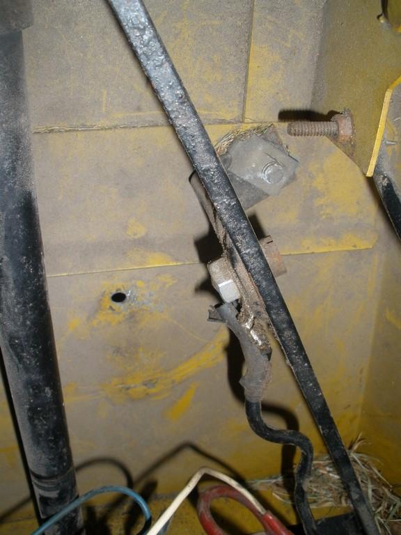

I have no idea about those other wires that are located near the oil filler pipe.
There are some wires going to what looks like to be the solenoid and the rest was just zipped tied.
There is a red wire with what looks like a fuse holder (no fuse), other wire that would connect with that one has either disappeared or been canabalised for something else.
There is another black or brown wire with a female bullet terminal covered with dust.

G'day Bondy and Mark, That bunch of wires next to the filler? There should be two wires in that bundle. One is the alternator output wire and one may be a magneto kill- I'd have to check. The one with the fuse is the alternator wire the previous owner had going to the battery for charge. You also show a fuzzy photo of a green wire and a red wire. If they are coming out of a little one inch square black cube (which I guess is the rectifier) then the red one is the alternator output I think, and should be the same wire with the fuse holder on it. Not sure what you mean by a wire from this bundle going to the solenoid. Given that the Honda solenoid is stuffed, I'd be putting the old greenfield solenoid back on and using it. That's what Mark meant by plan B  I apologise for mucking you around on this one. The suggestion to use the Honda one was based on the assumption it was shiny and new. Mark, do those switch numbers mean anything to you?

Yes prd, Ignition switch: M - magneto S - Solenoid L - lights G - Ground / Earth B - Battery
#So connect magneto kill wire to M - magneto
#Connect battery supply 12v to B - Battery (supply will come from a main terminal on top of the solenoid, battery supply side.) Should be a fuse protecting this cable.
#Connect an earth wire to G - Ground / Earth ( wire normally comes from under the base of the solenoid)
# connect a wire from S - Solenoid (this wire is run to the coil terminal on the solenoid) so, when you turn the key to start (spring loaded) 12v is then applied to the coil. The coil becomes an electromagnet and closes the main contacts, which then gives the starter motor a 12v supply.
The intent is to get the engine to start and stop from the ignition switch, then I would focus on the other circuits one at a time.
