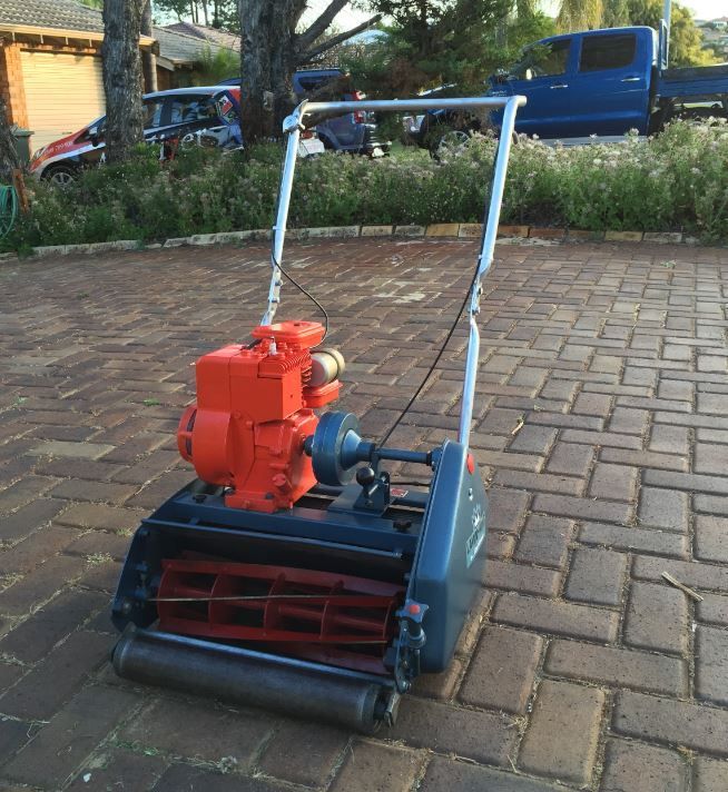

Picked up the sharpened blades & got a few hours on the weekend to start re-assembling the machine. Progress so far:
[Linked Image from i1252.photobucket.com]
Lookin' Goodly !
BB

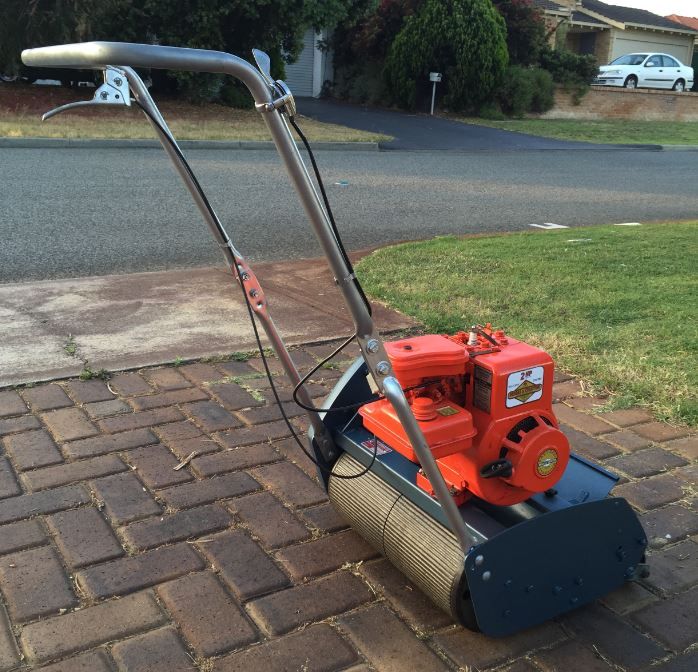

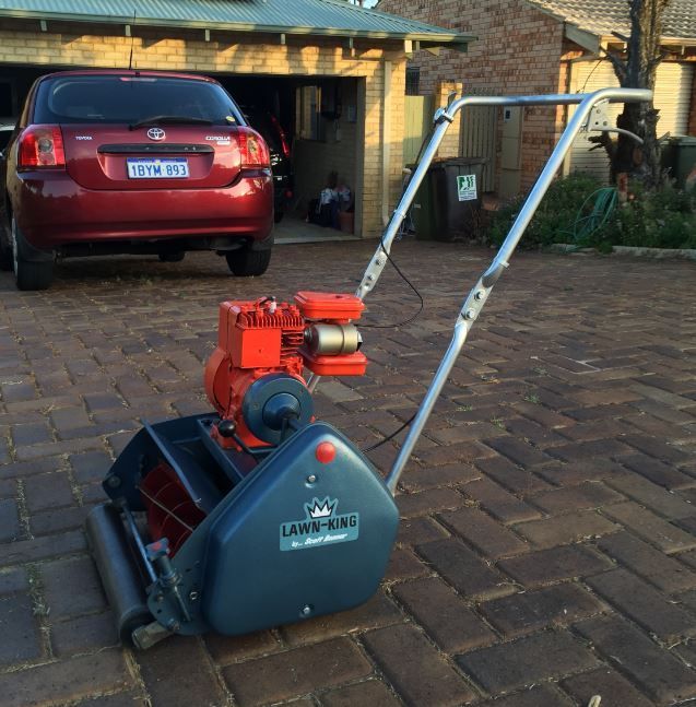

Latest snaps:
Not perfect - blue paint doesn't match the decal, but it still looks a lot better than when I purchased it.
Will post another picture when I've done the catcher.
thats come up a treat mate , great job congrats
