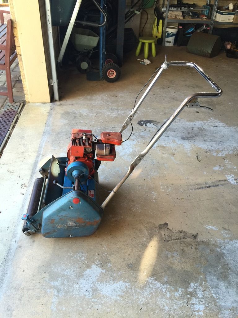

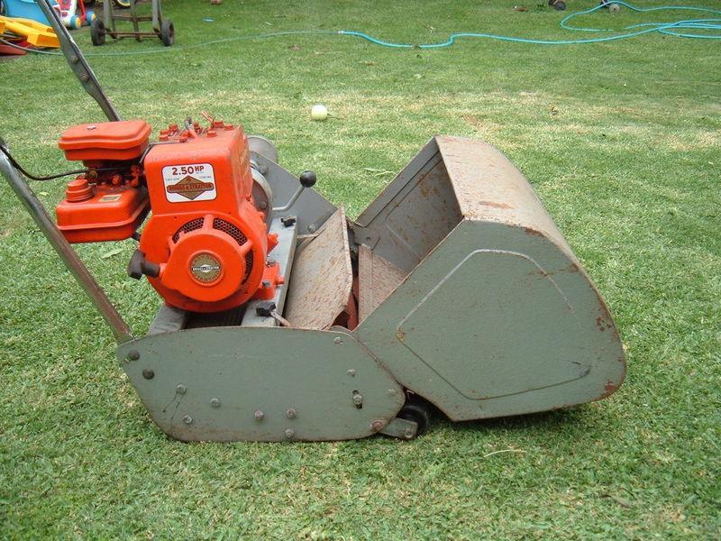

Hi there,
Being a long time rotary lawnmower user, I recently purchased the following SB for $250 - goes very well & I've quickly grown very fond of it. I understand it's called a Scott Bonner Lawn King.
[Linked Image from i1326.photobucket.com]
I recently discovered this very awesome forum (& the Youtube videos) which has inspired me to try to restore it. A few questions if I may:

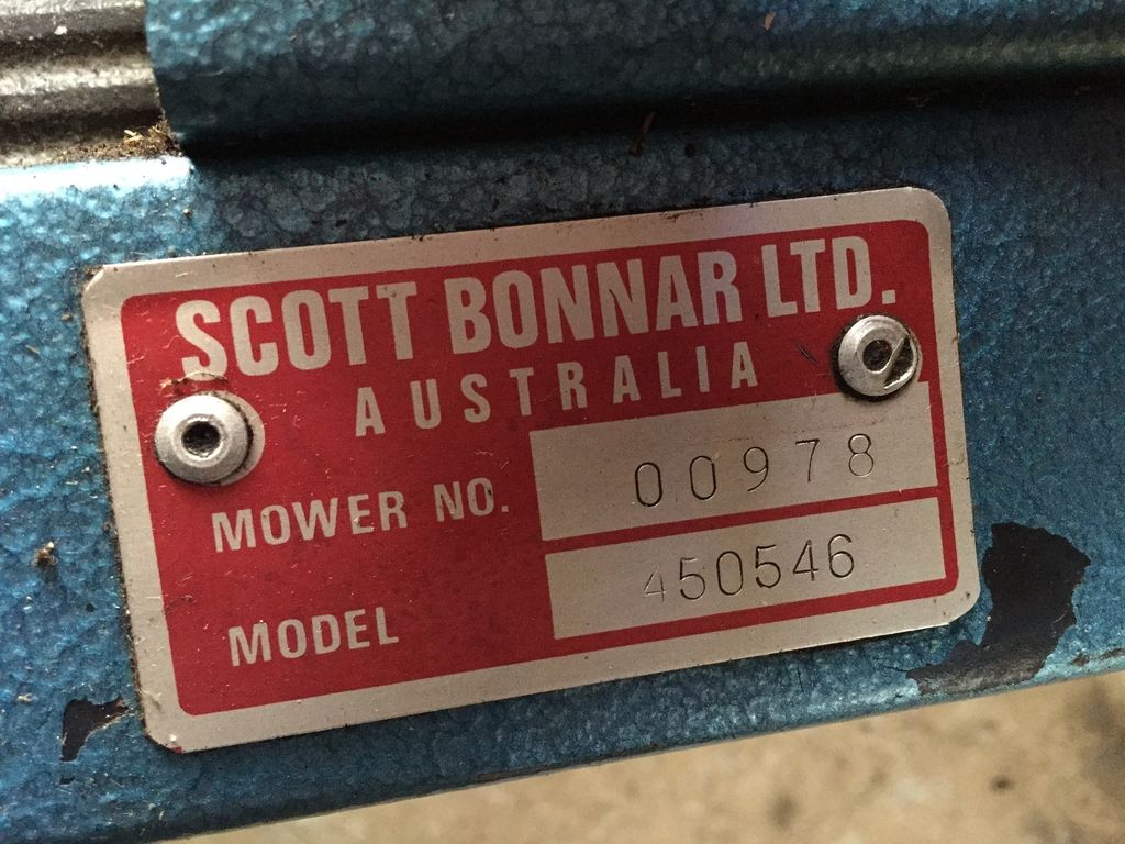

- What does the machine number indicate? age?

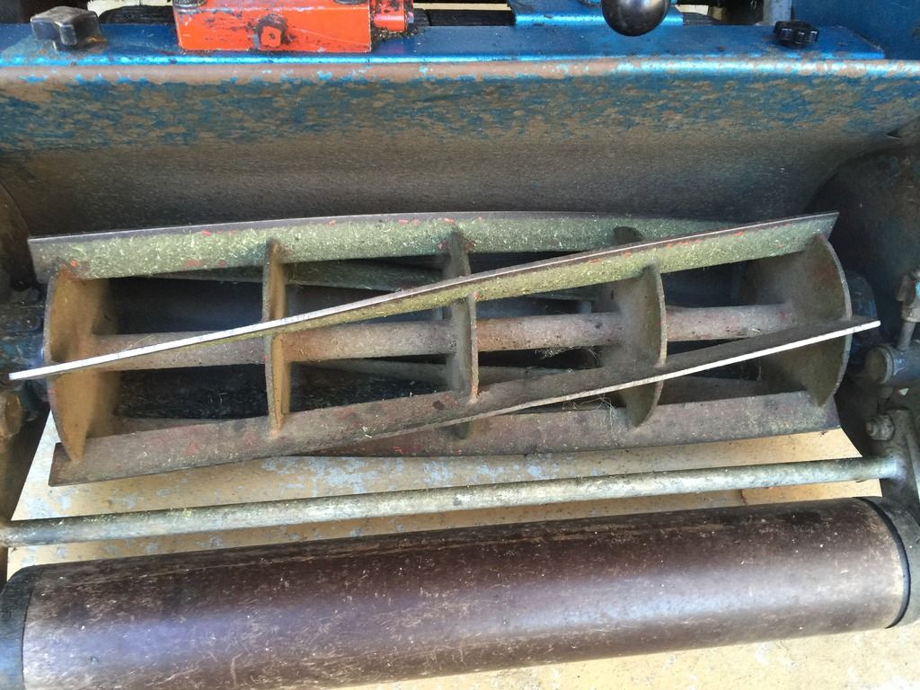

- Does the blade look like it's got enough "meat" to warrant re-sharpening (rather than replace)?
- Is there a way of removing side cogs without a gear puller?
- Is there any easy way of finding out how many HP the B&S engine is?
- What's the best way of preparing the chassis for repainting? Do you sand back to bare metal? or just remove rust / abrade & paint over with hammertone?
- Any other observations about the machine / info / help is much appreciated!
Cheers!
Hi Lewy71, and a warm welcome to the forum. grin
It's always nice to have another Scott Bonnar owner on board.
Your machine is a Scott Bonnar Lawn King, manufactured in Thebarton, South Australia, it is (what we call) a 'twin rail' engine deck with what I believe to be a 3HP Briggs and Stratton engine fitted.

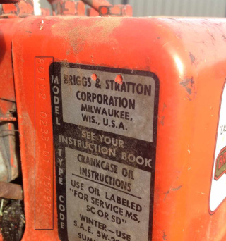

To confirm this, we need you to post the complete string of numbers stamped into the metal air cowling, which will be the Model, Type and Code.
From this we can give you the date of manufacture of the Briggs which will then give us the approximate date of your machine (as we cannot date Scotty's accurately as no records were kept) See the pic here:
Your cylinder reel has plenty of 'meat' in it, but will probably need to be re-ground sometime in the future. You may need to use a 3 leg gear puller to remove the engine (12 tooth) and the double cutter sprockets.
Please refer to our video guides that can be found HERE
For repainting, many members have the chassis sand blasted, primed and re-painted, others may just sand and re-paint. Other SB members here may give advice here. wink

Hi Deejay, engine number is 60102 0347-01 74061401.
Manufactured in 1974.
Does it tell me hp?
Hi Lewy71,
This confirms your engine is 6 cubic inch displacement, basic design series 0, horizontal crankshaft, vacu-jet carburetor, plain bearings and rewind starter which was manufactured on the 14th June 1974.
The 60102 would indicate that is a 2 to 2.5 HP engine. wink

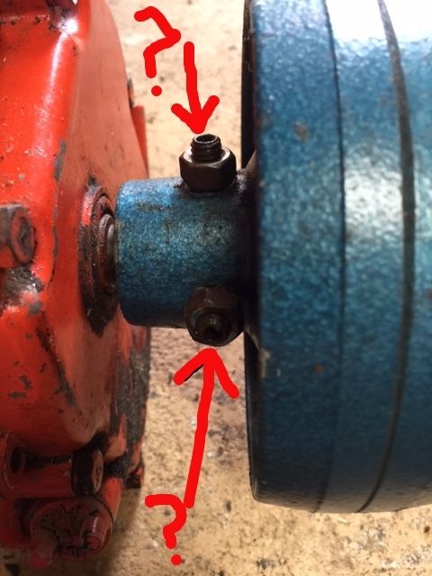

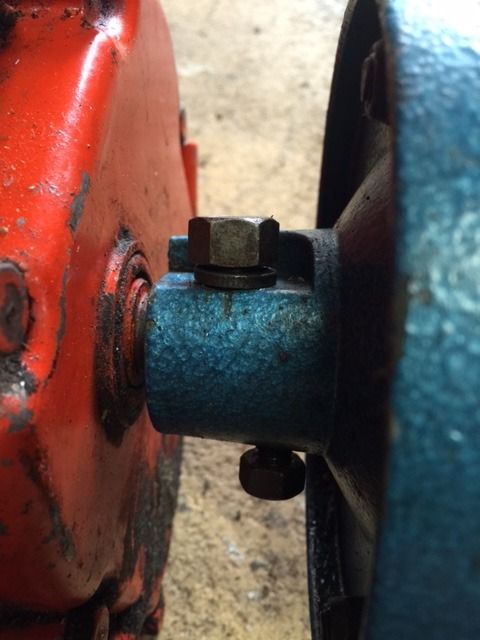

Hello again,
My SB is now in pieces, & have encountered a little problem removing the clutch housing from the engine crankshaft.
I have studiously watched your video (& read a couple of posts) to try & solve the problem myself, but no joy as yet.
My question is in relation to the 3 screws on the clutch housing (see photos below).
[Linked Image from i1252.photobucket.com]
In the 1st photo, is the cotter pin - I have tapped this in as far as it will go & subsequently have no luck trying to tap the clutch housing off the shaft.
I don't understand what the other 2 bolts do (in 2nd photo). They are 2 bolt shafts sticking out from the blue casing, with nuts on them (when I unscrew the nuts, the bolt shafts remain in place). Do you know what they are for & do you think they might have something to do with me not being able to remove the clutch?
Lewy71
Hi Lewy71,
You are absolutely spot on with those extras not letting you remove the clutch half.
This is a previous tenants idea of either fixing a wobbling clutch body or seeing the newer design and trying to copy it.
Those extra lock up grub screws are what's is pinning the body to the shaft.
You will have to undo the nuts and then use an allen key of the correct size to unscrew the grubs out of the casting.
Before you go any further with this clutch body I'll have to ask you, do you think the body was revolving absolutely true or did it already have the slightest amount of wobble when revolving ?
The body you have there looks to be the first of the die cast bodies that were substandard compared to the predecessors that were manufactured out of cast iron and thus much more robust but far more costly to produce.
Personally if in any doubt what so ever I would discard it and replace with the current style unit that utilises two set screws that pin the body to the PTO shaft at 90 degrees to each other and not allowing any play to eventuate.
BB

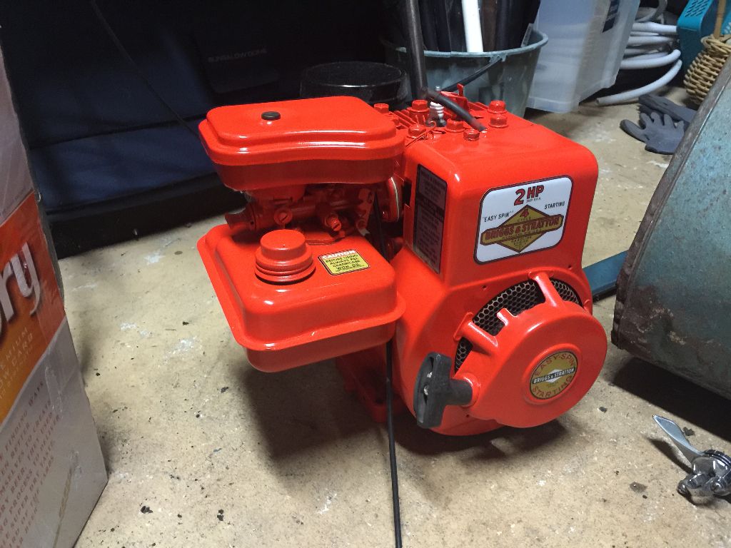

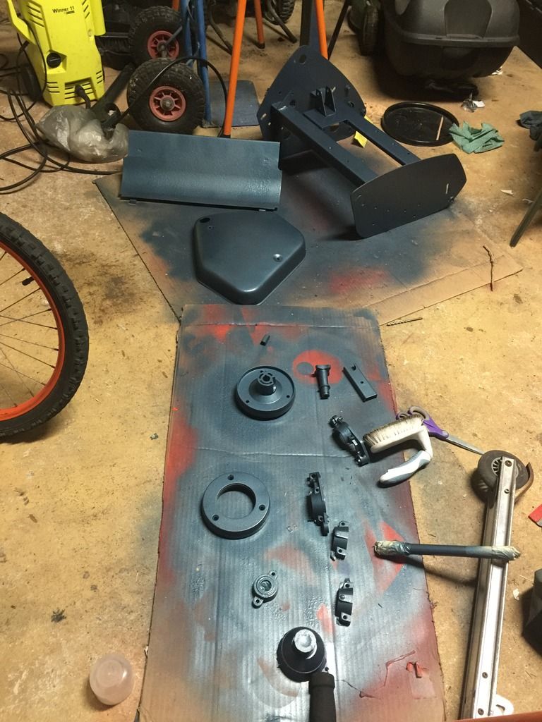

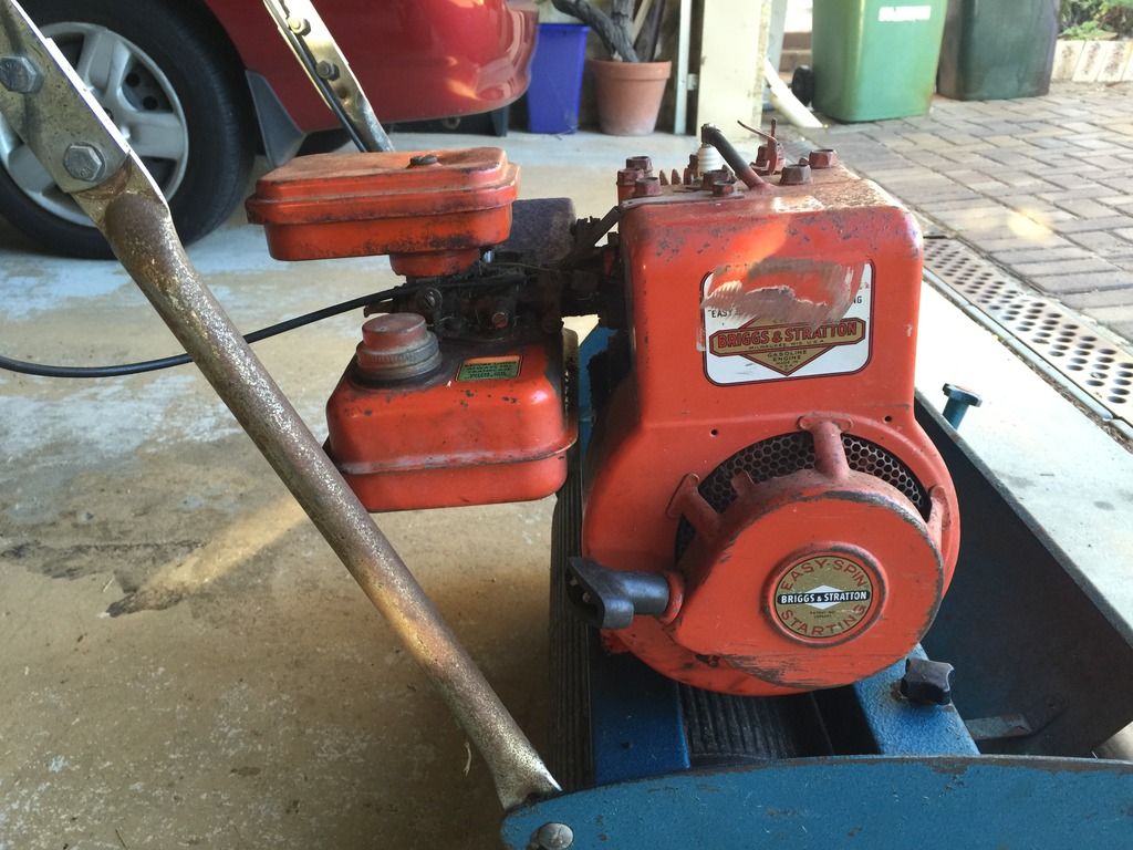

G'day,
Has been a while since my last post - footy season has kept me busy & away from the Scott Bonnar project, which I've recently had a chance to get back into again. Since I last posted, I have done a few things:
- Pulled the machine to absolute bits;
- Ordered engine & chassis decals;
- Ordered new muffler, carby/fuel tank gaskets, clutch half, thrust & cutter bearings & rubber stoppers;
- Stripped whole chassis with paint stripper / wet & dry.
- Degreased, partially sanded with wet & dry & repainted engine chevy engine orange (see below);
- Stripped & very crudely repainted cutting reel (fire engine red).
- Sprayed the chassis white knight hammer finish blue (see second photo).
The only hiccup I have had so far is one of my dogs spewing on the chassis when the paint was curing! The dog spew had acid which etched into the curing paint, so had to repaint it.
Hopefully I can get some time this weekend to start putting back together.
Have to say that I, as a non-mechanical person, am finding the process of restoring the mower very satisfying. I have been recommending this type of project to a number of my fellow white collar workmates as therapy !
Hi Lewy71,
Ah yes the Footy season, it's certainly a distraction I must admit, honestly I can't believe it's just about over again for another year and we're still right in the middle of winter weather as well.
The progress on the engine looks superb I must say, now the paint colour on the chassis parts looks a tad odd, may I ask what colour it is ? Are you trying to replicate the original "Pacific Blue" that your Lawn King was painted in or have you just chosen something that you preferred ? Which ever way it is it's your therapy and it's got to make you feel better doesn't it.
BTW the dog story is an absolute ripper but I'm sure it has frustrated the living daylights out of you. Oh well that's just how it goes sometimes, also great usage of the kids scooter, just hope he or she didn't want it while the paint was still wet as then there would've been your next drama.
Looking forward to more progress shots.
BB

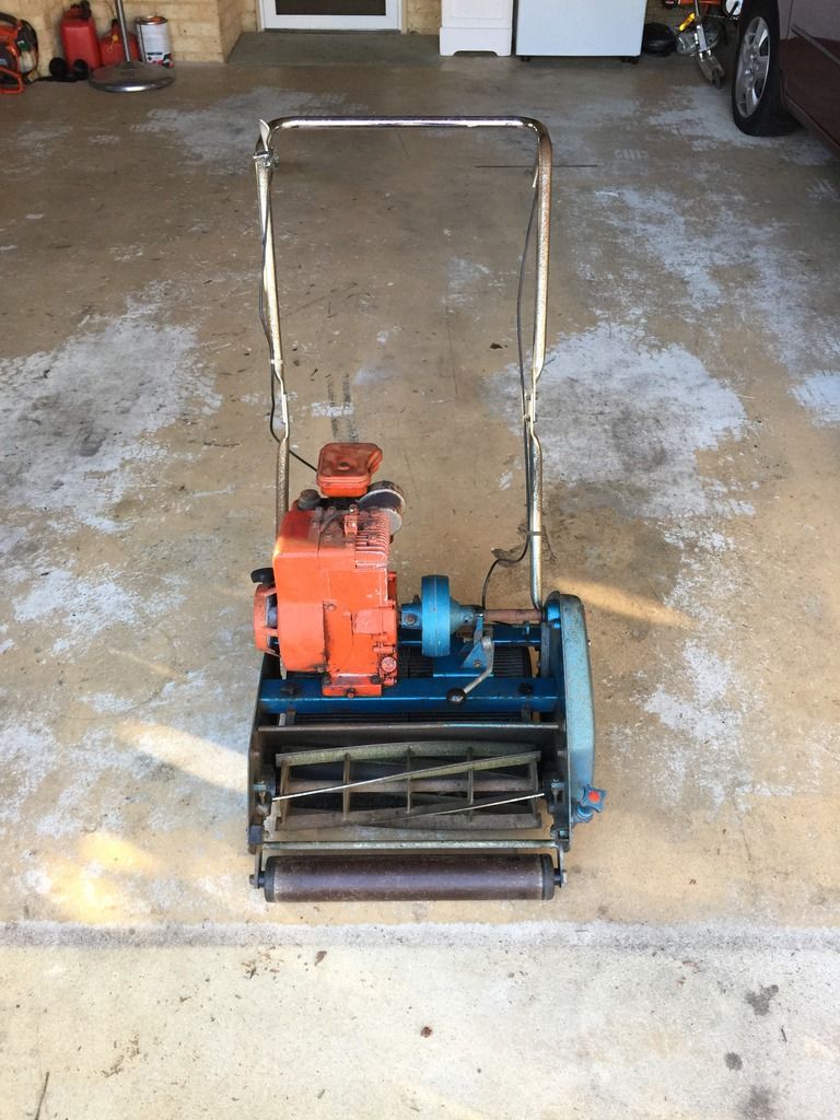

Hi there!

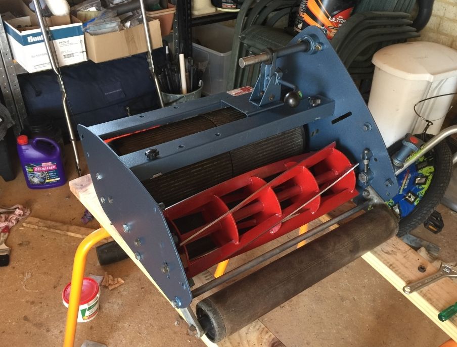

Picked up the sharpened blades & got a few hours on the weekend to start re-assembling the machine. Progress so far:
Lookin' Goodly !
BB
Joined: Dec 2014
Posts: 13
Latest snaps:
Not perfect - blue paint doesn't match the decal, but it still looks a lot better than when I purchased it.
Will post another picture when I've done the catcher.
thats come up a treat mate , great job congrats
Hello Lewy71, Mod BB and vccomm
When I look back at this restoration I see real attention to detail.
The rear rollers seem to indicate a machine with low hours, and now,
will last for many more decades.
The engine looks like it was just unpacked and fitted on the production
line! I think this is our first fully restored Model 45 Lawn King.
A real credit Lewy71.
You should be very proud of this great restoration.
p.s. Keep Dino away from the catcher.
p.s. It may be that the original decal had a transparent background.
almost all decals were clear backgrounds i found jack , and its why its even harder to copy the colours mostly even the engine ones are !
when copied its the only way i have been told by the expert (S.B ones at least)
Hi vccomm
That's good information.
It's a pity reproduction decals can not be made with transparent backgrounds.
Oh well ... maybe someday.
All very interesting.
