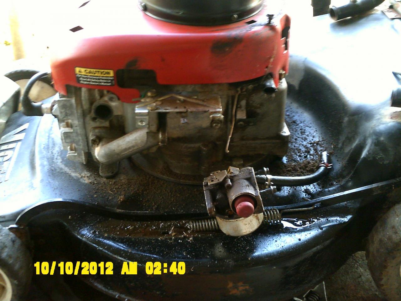

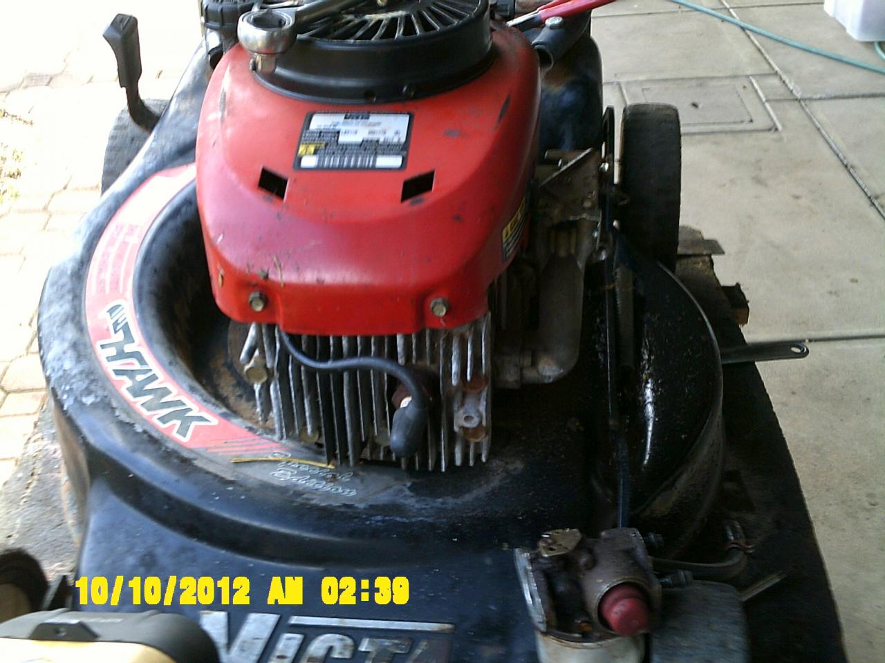

hello again , i just had this dropped off would it be a tecumseh ? i cant find anything on it so far to tell me what it is confused hadto fix the starter , it starts with fuel in the plug hole but seems to be missing a linkage for throttle somewhere . as iv'e never seen one before i'm not sure whats missing , all that is there is the one from gov' too carb butterfly , nothing from throttle control to carb blush . if i saw another i could maybe make something . thanks for any help . cheers , Dave

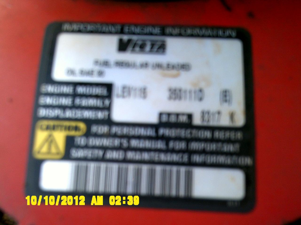

sorry about the pic's , new camera still working it out ! found it , the only thing i could find was stamped on the bottom of carb' . tecumseh yup , running well now but still no throttle , must be a realy small linkage in there somewhere . man i never seen soooo many redbacks come out of one old mower !!!!! bigshock so allgood its a runner and quiet too

http://www.partstree.com/parts/?lc=tecumseh&mn=350105D-LEV115&dn=10ELEV1202350105D-EN
Looks like LEV115, not sure on engine size. (big engine I think 4.5)

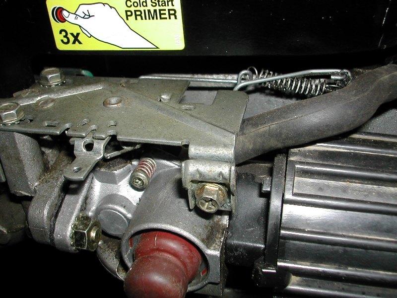

thanks for that mark . looks like a few bits missing yup only thing there now is the linkage from gov' to carb and nothing else , not throttle control at all but hard to see the bits properly . yes it does start easily but its a tad hard doing it while holding everything in place laugh i'll put it aside till another turns up . plenty of others to play with atm . thanks again for the help . cheers , Dave

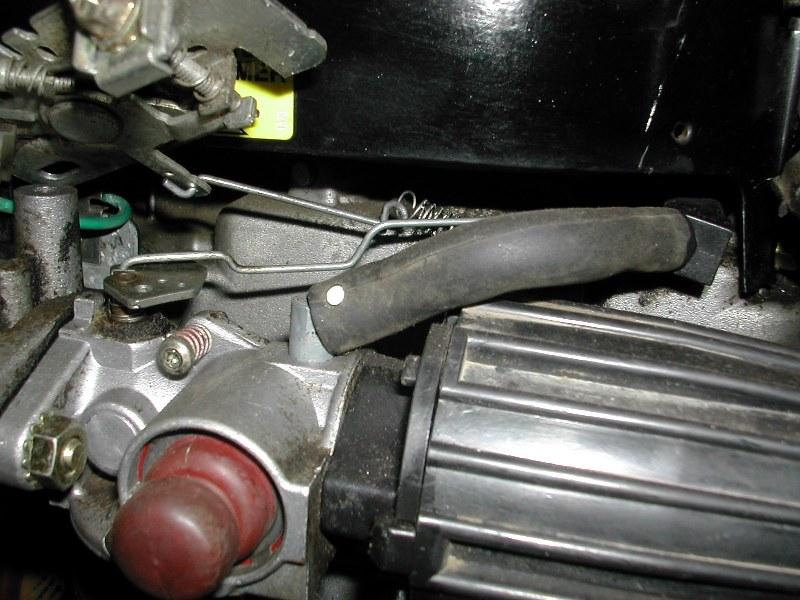

Please see images of Techumseh linkages.
Bottom image shows below the plate.
aaaaaaaaaaah similar yes . at least now i know where to start thanks mark . now i gotta go get it from under the tree , wd40'd the c*#p out of it and bug spray hahahaha never seen so many redbacks in one place before
