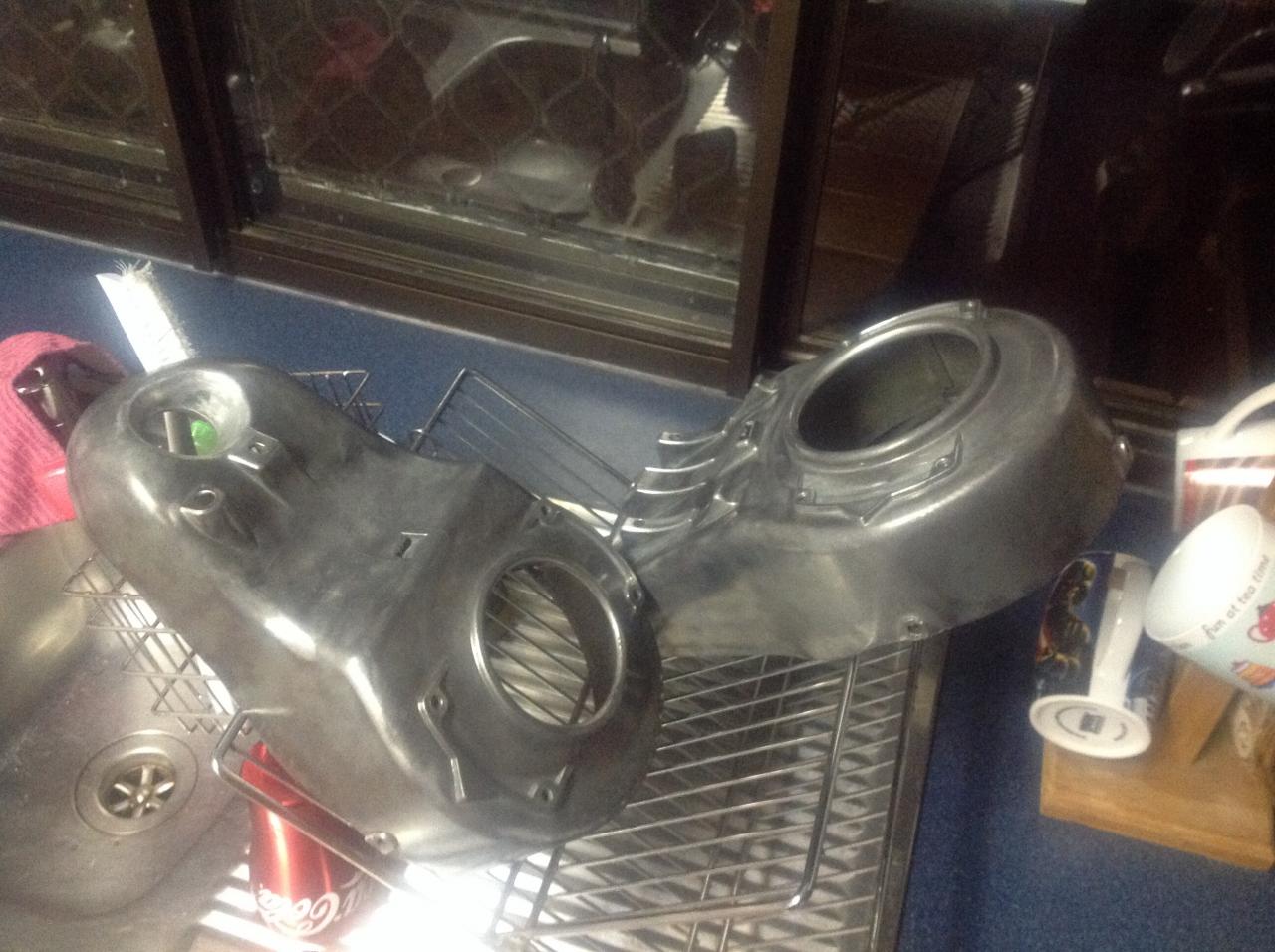

A lot of scraping and buffing this morning
Still more paint and surface rust to remove, getting there.
Wow Paul C fantastic job so far,you keep going I might let you do a couple of mine as well.
Posts: 988
Likes: 7
Seriously rethinking this whole repainting thing, it is a shame to put paint over top of these
Wife's not home :-)

i'll say mate, you could eat your dinner offa those things!!

Shiny shiny ! Tomorrow they will be grey !
