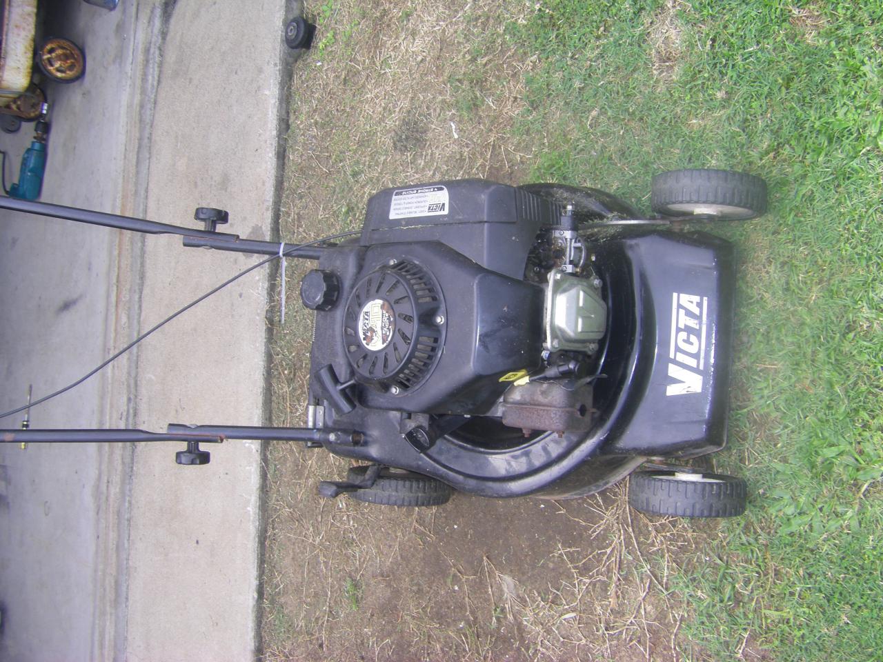

Hello,
I think this is the right forum even though the mower is not a true Honda. It is a Victa V40 OHV engine that I bought from the recycle centre. I thought it would be an easy fix but a problem still persists.
It will start first go when cold and seems to idle and rev up fine. However, after a few minutes you can hear the odd "chug", if that makes sense, and soon after it starts to puff out lots of blue smoke. Eventually it grumbles to a stop and then won't start. I have cleaned the carburettor, set the valve gap, changed the magneto and spark plug but it's not fixed. Any ideas where I should look now? Is that adjustment screw 1.5 turns out?

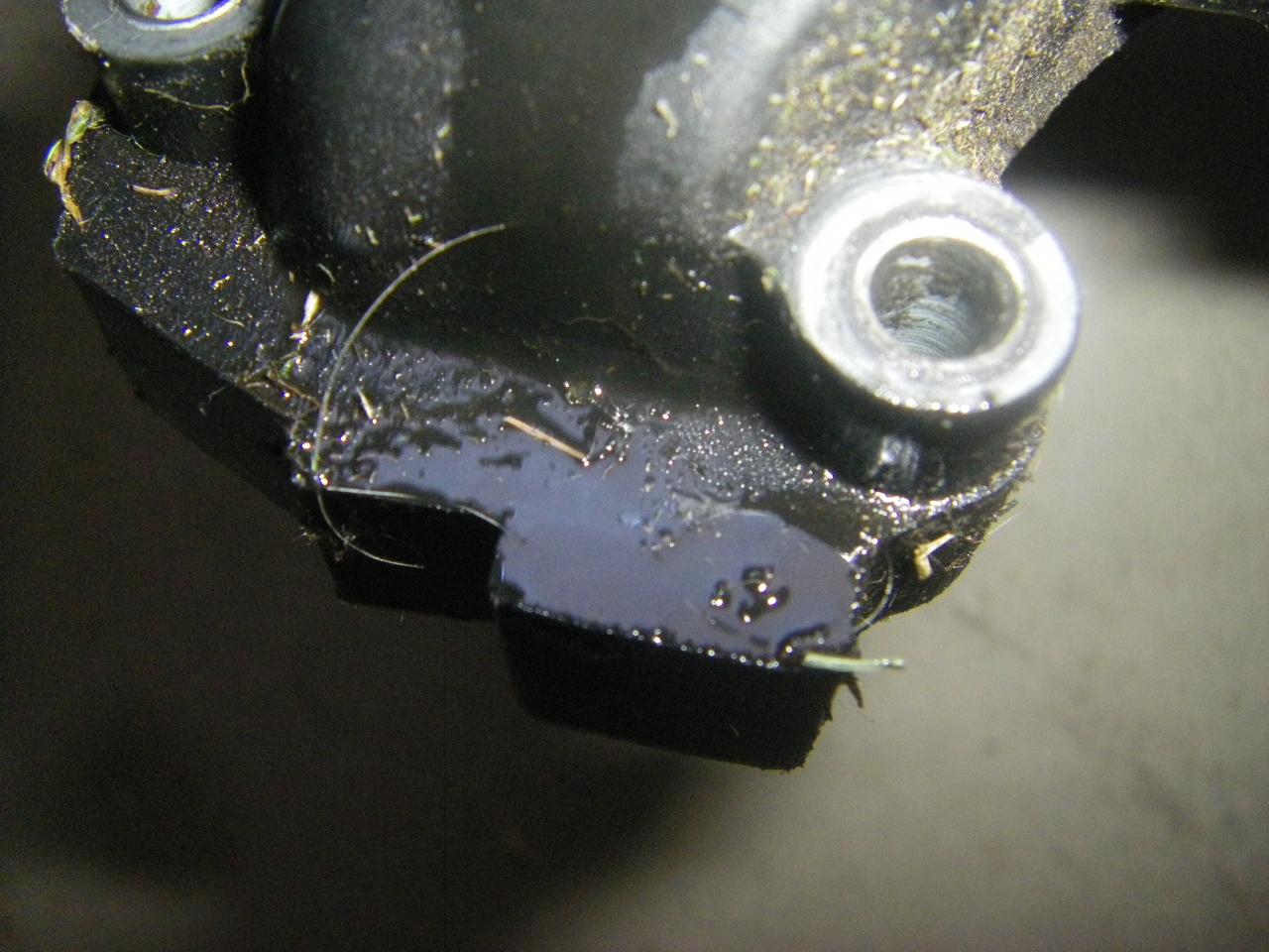

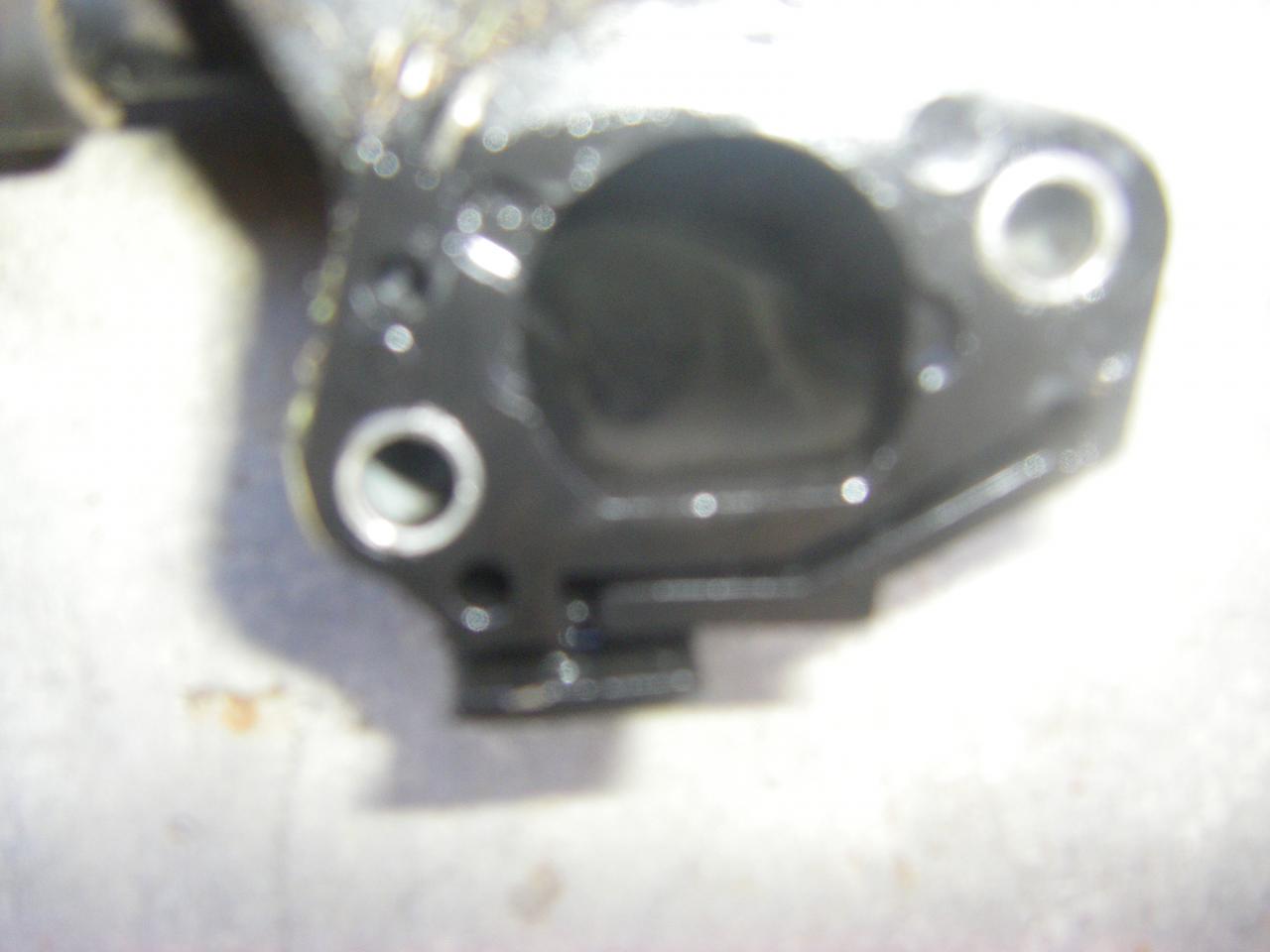

Some shots of the PCV valve. [Linked Image]
Doesn't look too bad. That carburettor repair video is very comprehensive. There's stuff to do there on my one that I haven't done.

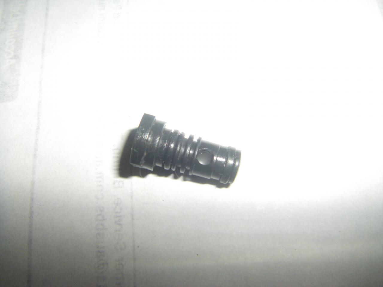

So I went back to the carburettor and, with the help of that video in the thread you referred to, this jet appears to be blocked. I don't have the right jet drill or whatever they're called so I tried some very thin stripped tie-wire and it seems to be well blocked. I also tried a pin and same result. I wonder what size it is?
I'm glad I found out where the PCV valve lives as that will help with future repairs.[Linked Image]
The blockage is at the small hole in the end. It's not visible in the photo.
That is the idle jet, Sparker. The tiny hole in the end, which is the calibrated part, is larger than 0.30 mm but smaller than 0.35 mm. On a genuine Honda it is 0.33 mm if I remember correctly, but on all the chondas I know of, it is in that 0.30-0.35 mm range. What you needed to do, was to clean it with carburetor cleaner. Now that you've hard-packed it, I can only see two choices. You can work gently on it with something the correct diameter (in other words, a 0.30 mm jet drill bit) or buy a new idle jet. If you decide to replace it, finish your carburetor overhaul first in case you find you need other bits as well. To get the parts you could go to ebay, or contact roebuck by PM.

It's soaking in carb cleaner now. I did get a very thin piece of nylon fishing line through it. I think the pin I was using was just too thick. I also found my cleaners but they were too thick too. Thanks for the links. I got everything else out of the carby and cleaned them up. Tomorrow I'll put it back together. Here's hoping.
That is a plastic jet, sparker, it can't stand sustained exposure to carburetor cleaner. I suggest you take it out right away and wash it in petrol or kerosene.
If you've been able to get something through it, you can clean it mechanically if you persevere. Incidentally, be glad you have a chonda not a Honda. Honda does not have the brass sleeve in their jets, while chondas do. I like the brass sleeve: it is more likely to still be the same size after you clean it.

Too late, Grumpy. (Sigh)....O-rings don't like carb cleaner do they. I don't have that small size. I'll have to get some, what size is it?
Neither does the plastic jet itself, sparker - it just takes longer to destroy it. I suggest you wash off the jet, let it dry thoroughly, and see if it is still OK. FWIW, to clean that jet I remove the O ring and spray carb cleaner through the orifice only, then wash in petrol. If it's actually blocked, I just put a 0.30 mm jet drill bit through the orifice.
I don't know if you can get a replacement for that tiny O ring, or you have to resort to buying another jet. You might try a PM to roebuck and ask him the question.
