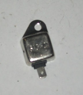

ive had a commando for about 20 years and the only thing that ever went wrong with it was a loose electronic ignition module. i replaced the pop rivet and its been good for at least 15 years

davemal, there was a reason you were advised to disconnect the ignition kill wire, and in fact it burst into song when you did so. You may well find that when you reconnect it, there is no more song. If so, it will mean that you have a problem in the kill switch, and the Victa 2 stroke guys will explain the slightly fiddly process for fixing it. If it goes that way, you'll know for sure what was wrong, and how to fix it if it happens again, in another ten years or so.

Those kill switch wires are a nuisance. Unless you're restoring the mower you may find it easier to just put in a toggle switch to replace them but I can hear the purists groaning already.
