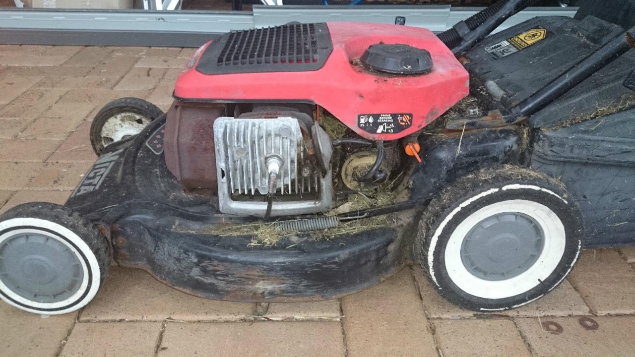

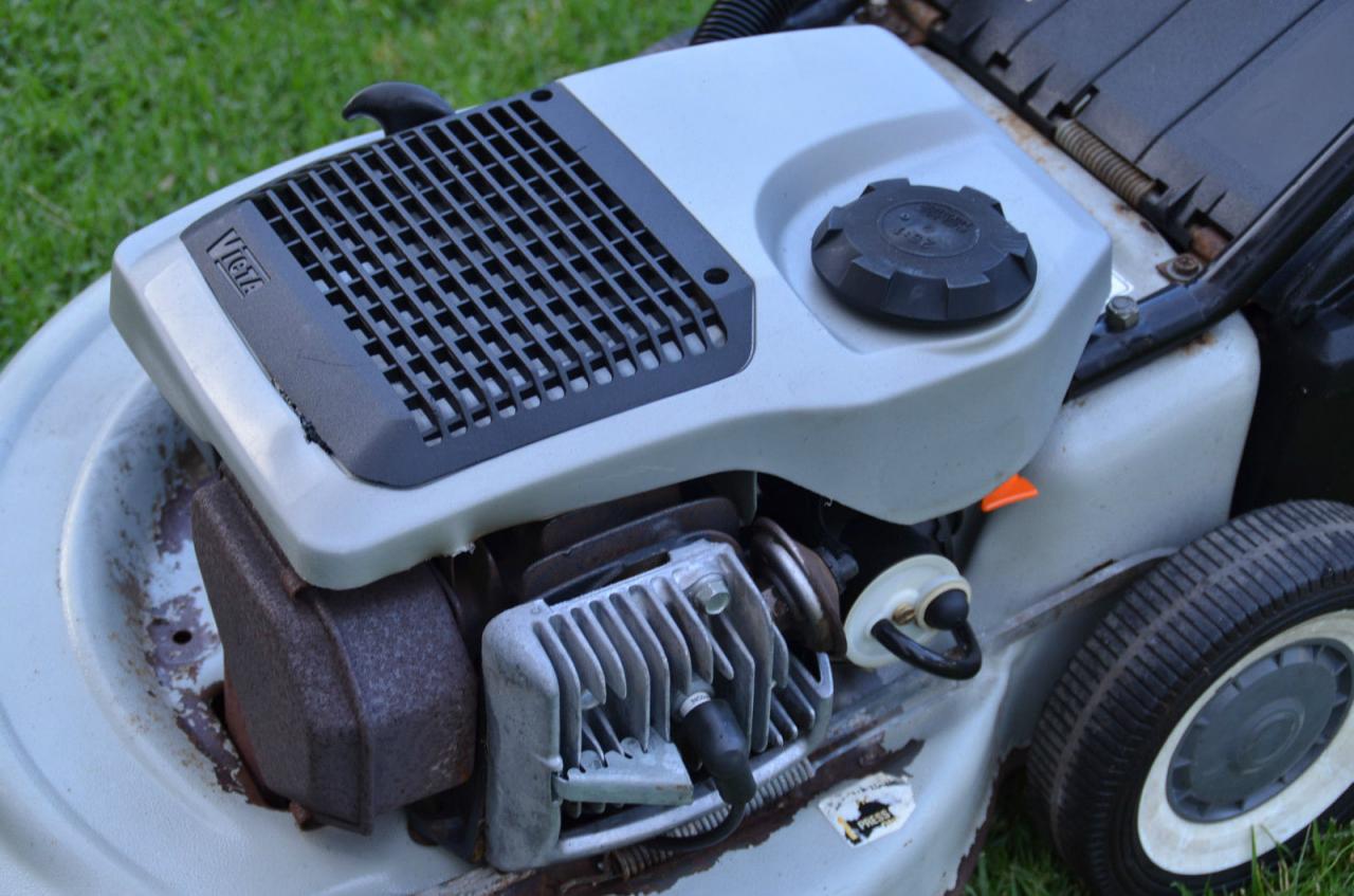

Good point i'll check its location on the original motor. I might be able to get hold of one but will be interesting to see the temps either way. I may have found atleast part of the problem, seems my cowling is missing the black shield above the muffler as seen on this mower. Also stumbled across a picture of another mower missing the shield and the cowling was badly melted.
Joined: Feb 2015
Posts: 67
Damn just found a note in the manual "NOTE - DELUXE COWL HEAT SHIELD DISCONTINUTED 6/00" Might not be the original cowling, original engine stamped 1996, original cowling probably melted lol.

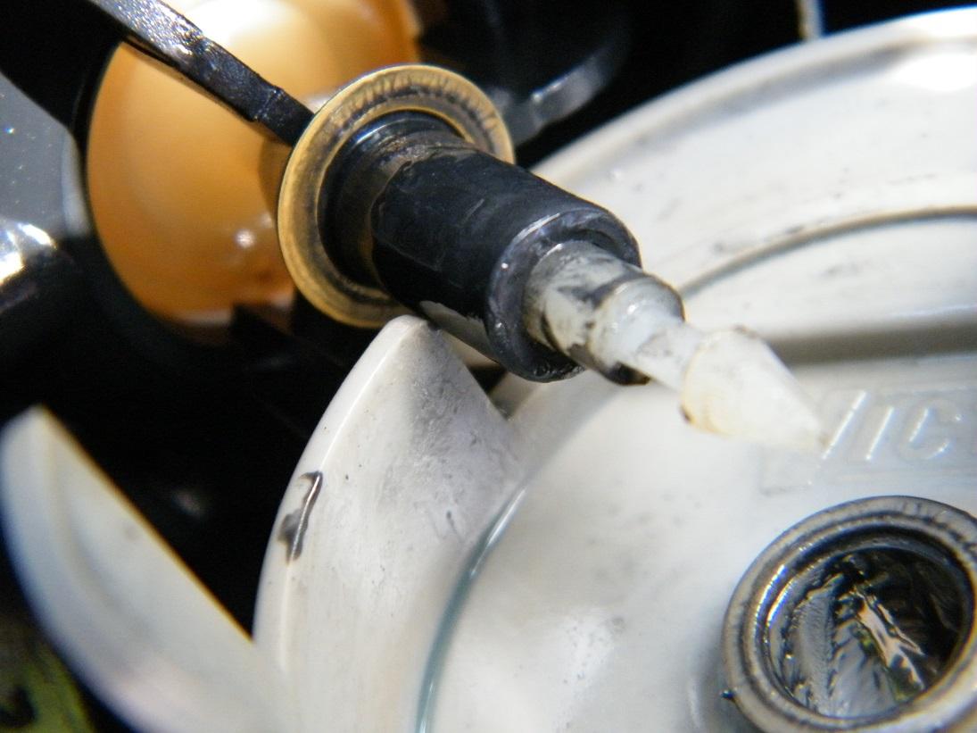

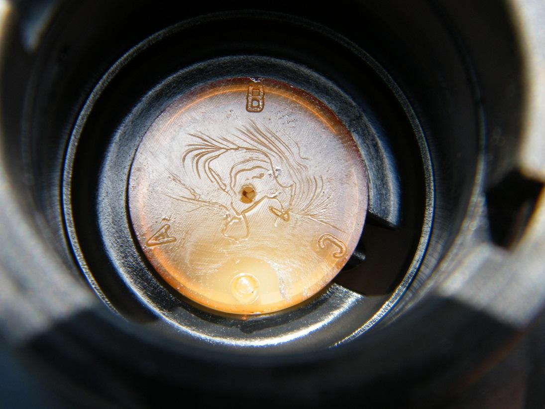

G'day Dan265 definitely keep the poppet valve on C that's the richest tune, going to A or B will lean it out more and with that comes more revs and heat...Try putting brass spacers in the carb (see pic) I've run up to two to bring revs down, yours may have one if so try two,I don't know part numbers or what Victa call the brass spacers but that's there job take any wear out and bring revs down worth a try.. As you have said with the missing black heat shield that would be why the cowling is melting.. Cheers Chris [Linked Image]

Valve is on 'C' mate. I dont think it needs the washers as it happily idles very low. Like i said ive got no vacuum to the governor, disconnecting the hose does nothing. Have tried new hose, other vacuum nozzles still nothing.

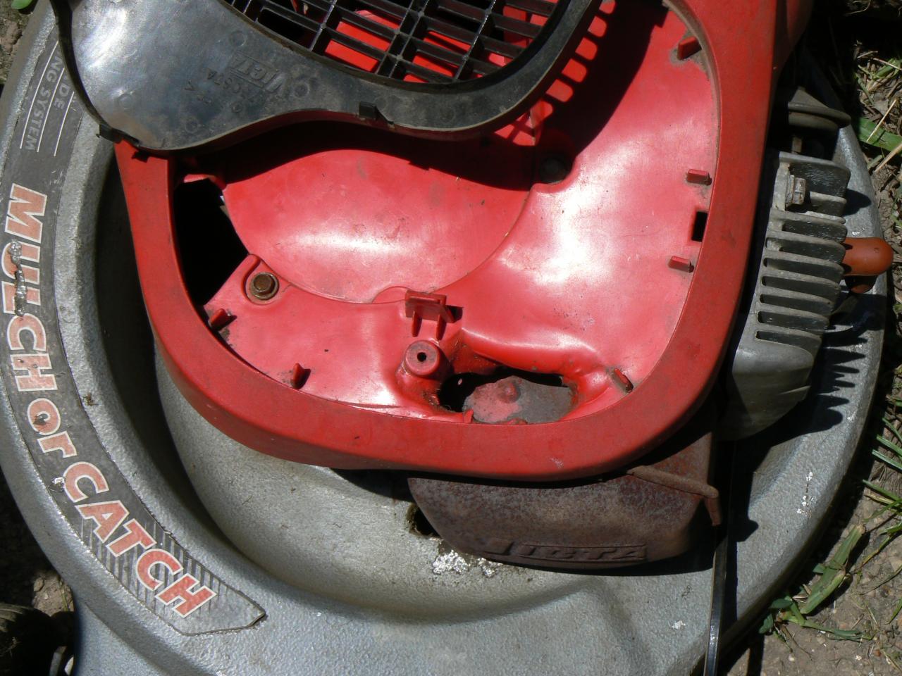

Swapped over the base from a blown Tecumseh 4-stroke as original base was knackered and noticed the cowling had started to melt over the muffler. It wasn't until I got the motor running and mowed a section of lawn that, when I had run out of fuel, I noticed smoke coming out from the cowling and found the larger hole melted above the muffler.
The mower was running at extremely high revs on full throttle, would idle reasonably low, could vary revs using the throttle and there was no noticeable blue smoke, being a 2-stroke.
Fuel is a minimum 25:1 mix, as I added the oil myself, but took a chance on a 5L tank of fuel that I got from someone else. I don't know if it is 98, 95 or E10 and they said it was for their old 2-stroke mower they had recently sold. In my mind, the fuel was too clear to have had oil in it, so I added oil to be sure it was at least 25:1. I know this was not the right thing to do, and I should have just used the fuel to clean engines and parts, but it seemed too much to waste.
Photo below shows how bad the overheating effect on the cowling is on the machine I am working on.

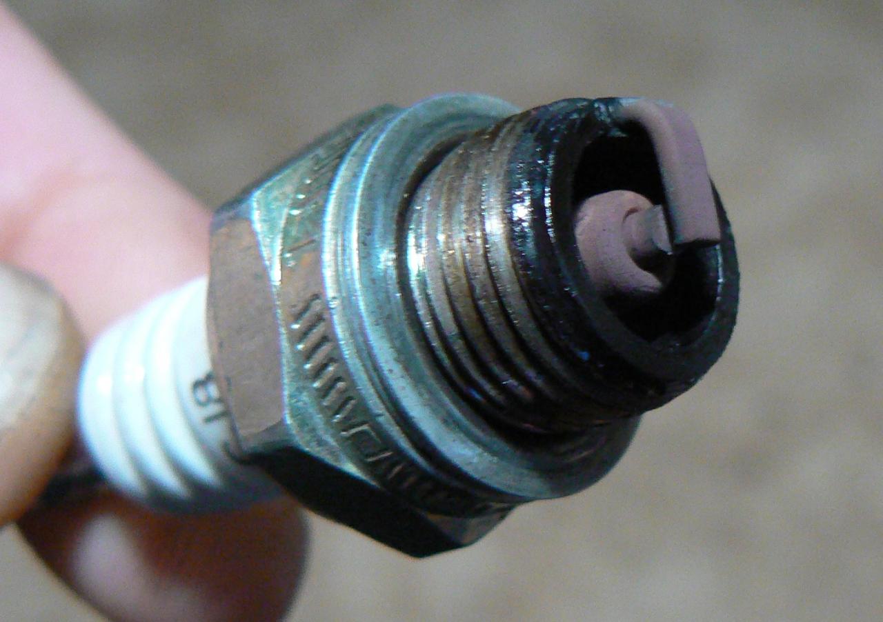

Here's the colour of the new CJ8 spark plug after a tank of fuel had been used when mowing yesterday.
Based on the colour of the plug, machine appears to be running lean so, according to the above post information, changing the Poppet Valve position to C should correct this.
Will start by: -
1. Changing the position of the Poppet Valve from A to C
