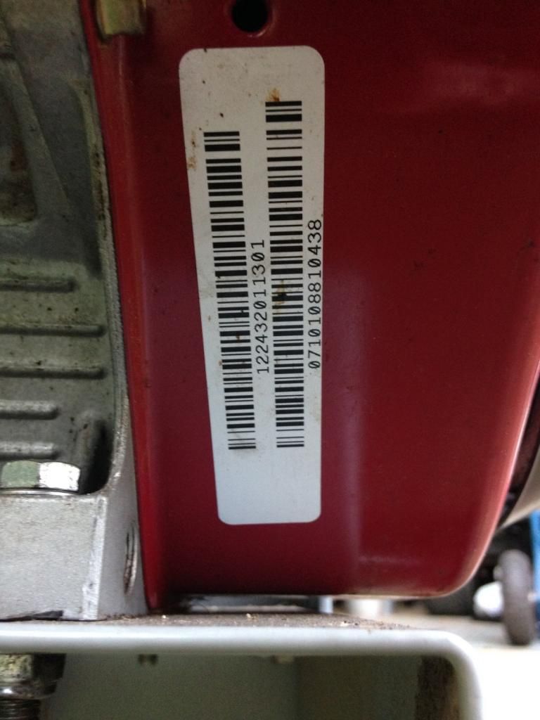

For now I have a picture of the engine numbers
I guess I just needed to see the layout of the numbers, Aldo, I'd expected them to be in the usual Model-Type-Code sequence. Model is 122432. Type is 0113-01. Code is 07101088. Here is the Operator's Manual:

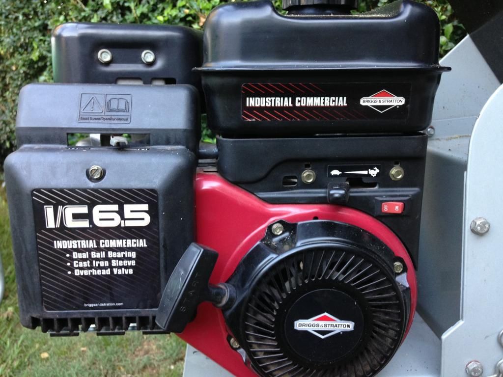

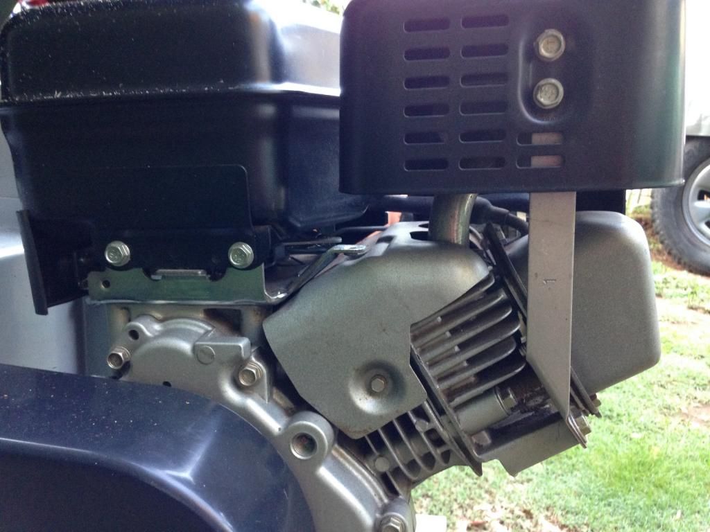

Thanks Grumpy, here are a few pictures of what I call an odd engine. I would have thought it to be labelled either Intek or Vanguard.

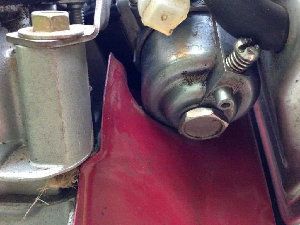

The cast aluminium bowl is hard up against the blower housing. it cannot be moved when the bowl retaining bolt is backed off

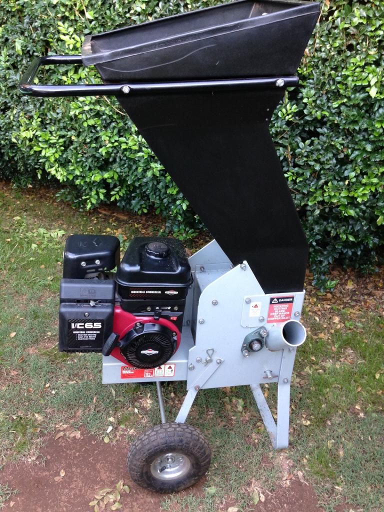

It is on a Masport chipper mulcher
Is the red steel blower housing flexible, or rigid? If firm hand-pressure will deflect it so it doesn't touch the float bowl, I doubt that it matters. On the other hand if it is rigid, it is pushing the carburetor out of position. That would potentially cause insufficient clamping pressure on the insulator between the carburetor and cylinder head. A leak there will cause lean mixture, which is what you seem to have.
Has the previous tenant removed the carburetor, and either accidentally or deliberately omitted the insulator, or one or both of its gaskets? Or removed the cooling cowl and reinstalled it incorrectly? That could cause approximately what you've got.

Hi Grumpy, I finally managed to get a look at this. Only this afternoon I removed the carb and then the blower housing. It is rigid btw and there is a shaped recess to accommodate the carb bowl. There is no give at all. There is a small rub mark on the housing where the paint has gone back to bare metal.
I removed the blower housing and judging by the bolt heads and marking etc, it hasn't been off before. The gaskets either side of the insulator look fine. I positioned the housing without doing the bolts firmly. I reinstalled the carb and then tensioned the bolts to the blower housing. There is just under 2mm clearance where before there was none. Everything seems to sit as it should.

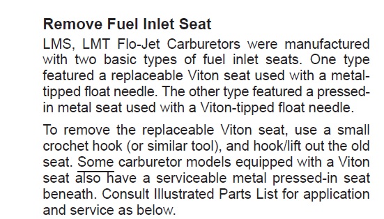

I'd say your right aldot, It sounds as though it will need more cleaning as it runs better after you've cleaned it. Does the carby have a fibrous seat? If so go gentle with the carby cleaner as the seat can be easily damaged and compressed air can dislodge the seat. Some photos of the carby would help if you can. I think it may have a pilot screw which would also need to be taken out while cleaning.
It does sound like there are obstructions in either the drilled holes in the carburetor body, or the jets. The most likely source of your problem is dirt in the passages in the fuel bowl nut, which are notoriously troublesome with that carburetor. If you didn't use a good blast of carb cleaner through there, and probe the passage after blowing out the cleaner with compressed air, it may still be obstructed. I suggest that you run carefully through this cleaning procedure:
http://outdoorpowerinfo.com/repairs/briggs_walbro_lms_carb.asp

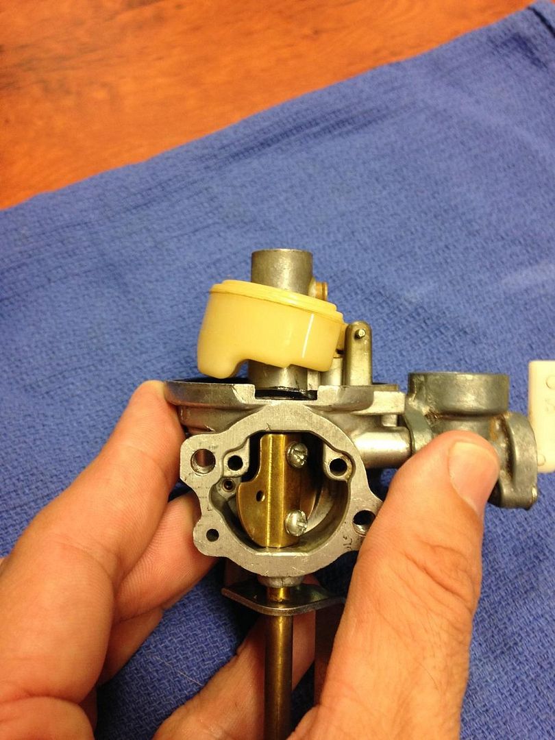

Joined: Jan 2011
Posts: 301
This photo shows what looks like a weird float angle but there is nothing in there that looks out of place
This picture shows the second hole which runs parallel to the emulsion tube but only goes 3/4 of the distance and doesn't have any openings that I could see or probe

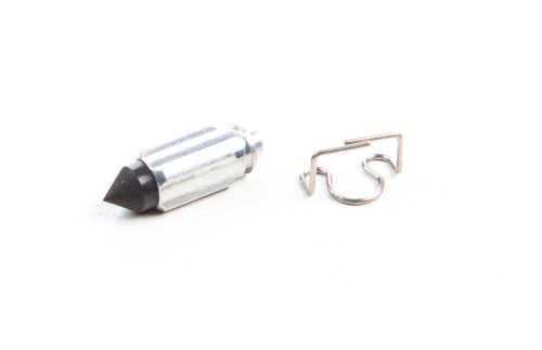

Double check your float needle setup. the spring should be fitted into float hinge area and not sitting on top of it as it needs to pull the needle off the seat area as the float drops. This might be the cause of the leaning of the engine as fuel flow would be too low in the carburetor for the main jet to work properly.
[Linked Image from ecx.images-amazon.com]
As the second hole it might be something that are using a different setup and just not finish here as it is not needed.
Are you sure you have the right float needle, Aldo? That float looks way too low, which will cause lean mixture. I think you should look at the things that set the float height: needle length, correct assembly of needle and clip to float arm, and seat position - is it pushed in all the way?
I may be wrong, but I can't remember ever seeing a simple toroidal carburetor float that was intended to be a long, long way from level. Given that the carburetor has been messed with previously, could the previous tenant have pushed in a Viton seat on top of a metal seat, thinking it should have both, when it shouldn't? If the needle is Viton-tipped, it is unlikely the seat should be Viton as well.
