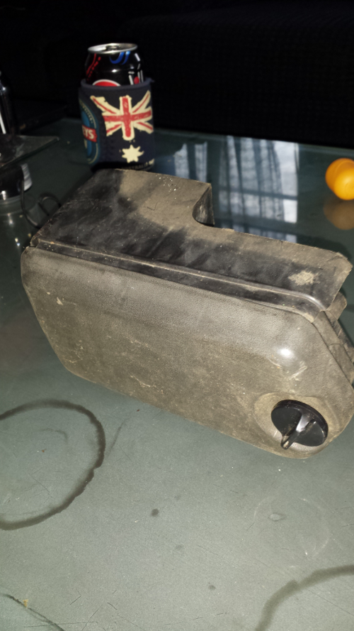

hi grumpy,
the valve cover has ohv and here is a photo of the air filter cover i do not have the starter for it will have to track one down. [Linked Image]

I recognise the air cleaner, and I should have recognised the top cowl (which is the only one on a pushrod Honda that is integral with the fuel tank), it is my favourite Honda mower engine. It is 140 cc (actually 135, but who's counting?), 5 hp, and a particularly lightweight engine for a Honda. The mower is most likely an HRU195, assuming it is 19" cut - it doesn't look like a 21" cut, which would be an HRU215.

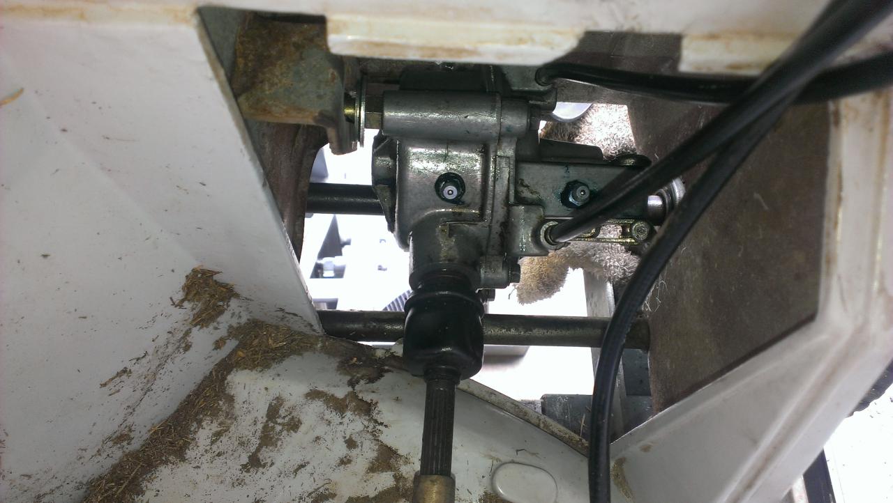

yes this machine is very heavy,
how do i attach this cable in the photo you can see the end of it the other cable that goes to the handlebar lever has a spring on it,should the one that isnt connected to anything also have a spring?

Can you put a photo front veiw of the top end of the handle bars showing the throttle and gear change levers of both sides showing all controls please. I have the gxv120 ( hru 214) 2speed gearbox. I'm not sure they are the same setup but might be able to copy.
Look at the second cable from the left in both of these illustrations from the service manual:

there is no throttle cable fitted here.
the spring on the cable going to the handlebar lever [the clutch i believe] is way too big for the other lever [gear change i believe]is there a shorter spring for this?
and where that cable attaches to the gearbox seems to be siezed as it wont move no matter what i try does the mower have to be running to be able to put it into gear?

I will get some photos from my mower of the cable setup and of the gearbox cable setup tomorrow which I think is the same as yours.

From left to right looking at it from underneath ,
Left/Drive cable linked to drive lever,
Middle/Throttle cable,
Right/gear change cable .
The cable at the bottom to the gearbox is gear shift connection , 1st and 2 nd gear choice.
The cable at the top runs back to the drive lever.
So the two-speed gearbox is separate from the axle drive box? Can you show us a picture of the two speed box, so we can understand where it is fitted and what drives it please Rob? It makes sense if they offered the single and dual speed systems as options, since they'd use the same axle drive box in both cases, I suppose.
Did Honda fit those two grease nipples on the axle drive box, or did you add them yourself?
Joined: Apr 2013
Posts: 336
Yes Grumpy, I did put those two grease nipples there and there was only need for one. It is still filled with gear oil I just put them there so if I need to change the oil or want to put grease I don't have to pull the whole axle off again and everything else that goes with it ,eg cables.
The gear box is one with two cables, I'm not sure what you ment. [Linked Image]
Sorry Rob, my error. I missed the third cable at the top of the last picture in your previous post. I thought the one that follows the drive shaft toward the engine, must have been the speed-change cable. It must really be the engine-speed control cable on its way to the engine. So, there are two external levers on the transmission housing: one for clutch and one for low speed or high speed. In your new picture the one at the bottom, on the drive-shaft side of the transmission, operates a bellcrank which operates a pull-push rod going inside. I take it that moves a sliding back-gear to change speed. The one at the top of the picture (the back of the transmission) must be the clutch? It is all about as complicated, and as neatly executed, as I'd expect from Honda.

Pretty strongly built, this is in the position I would pull the gearbox apart , held in a vice up this way . Less chance of any parts to fall out.
Can you show us the speed change mechanism Rob? It looks as if the input shaft drives the shaft with the smaller gears and the step-down in shaft diameter, and that shaft goes through the end of the housing and can be pulled and pushed axially, or perhaps it is spring-loaded so it only has to be pushed? It is evident that the sliding gear is the one on that shaft.
I like the O ring seal right around the housing - that is a similar concept to the way Honda seals car engine sumps. Pity they don't use it on mower engine crankcase covers as well.
