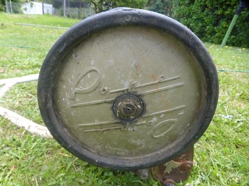

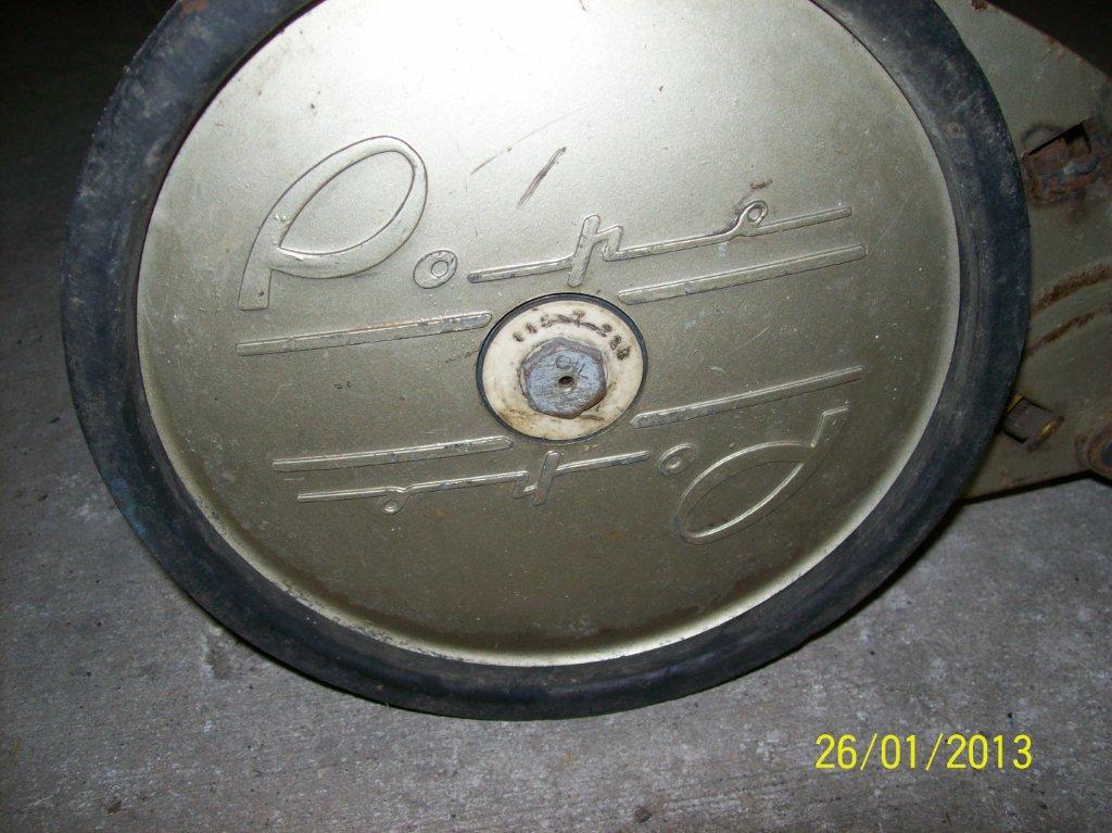

I recently bought an old push mower (non-engine) 2ndhand. I *think* it is a Pope Wimbledon model. It has 7 blades and I've included pics below. It doesn't seem to cut the grass properly. As in, I can't get it to move properly (as opposed to it moving fine but not cutting grass). I've also included a link to a youtube vid to show what I mean. I'm guessing parts are not on correctly or not adjusted correctly. Everything I've read says that these things should be nice and smooth to push when they work.
I have two main goals here:
1) Get it working correctly and well
2) Potentially restore it to a nice shiny condition, rather than what it is now.
If I could achieve either of these through this forum I'd be wrapped. So, basically I'm asking whether there'd be anyone who'd be willing to guide me through one or both of those things either here or by PM? I'd need a fairly patient person (!) since my handyman knowledge is not the best. I don't know the names of the parts, or what certain bits are for. I really want to get it in good working order so I can use it.
Well, I'll post the pics and video and go from there.

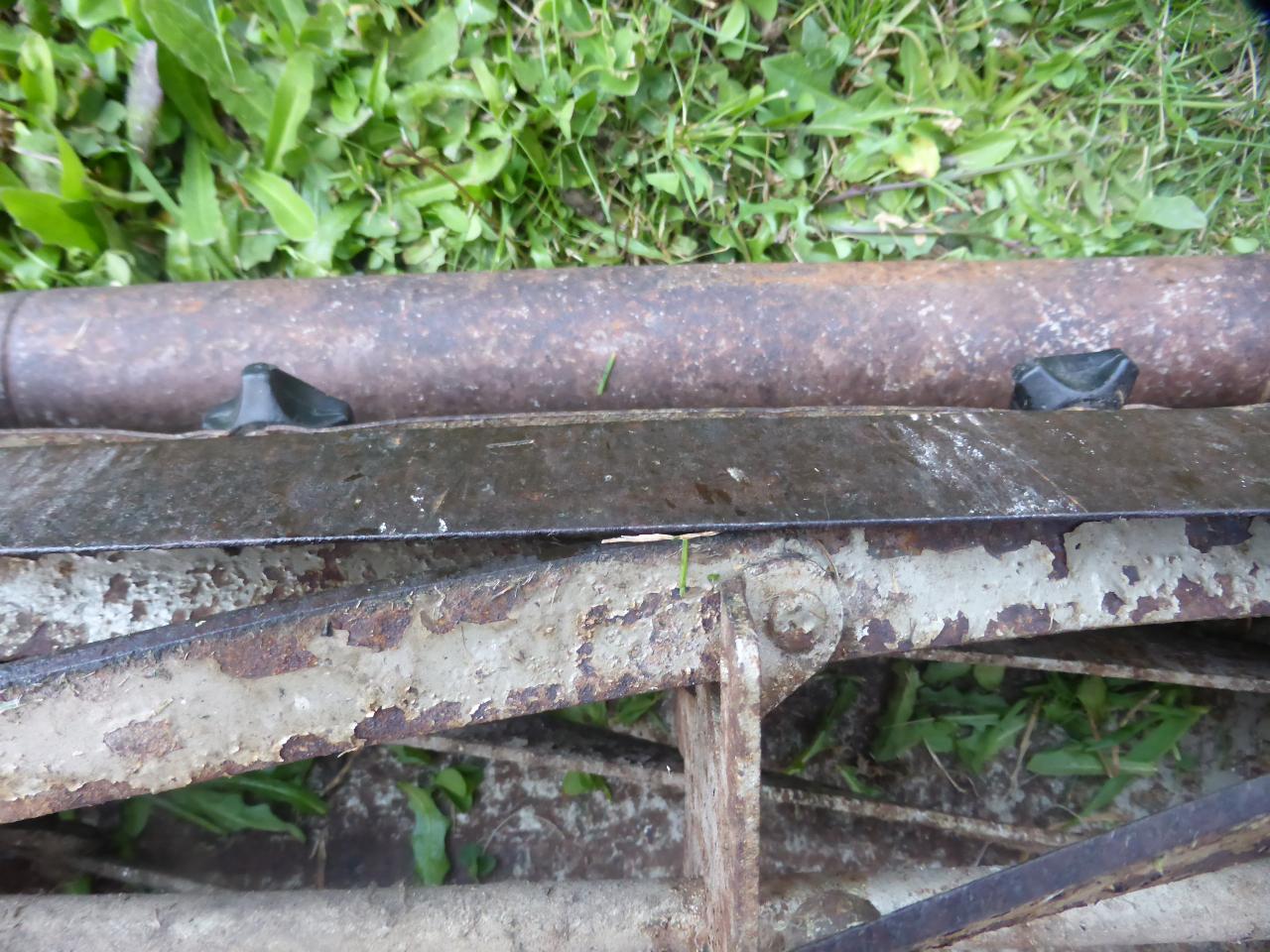

The most obvious thing that really stands out from you photograph(s) is
that the sole plate and its bedknife is touching on the ground. This is a big no-no.
In your photo (reproduced below) the height is set to the absolute minimum.
Go back to the manual and set the height to at least half way by loosening each knob
on the roller brackets. Your machine is skidding along the grass.
The sole plate should not touch the grass at all. The back roller should.
The next step is then to post a close up of the reel and sole plate taken
from underneath from the front of the machine. We need to see the condition
and thickness of the bottom blade or 'bedknife' and reel or 'cylinder'

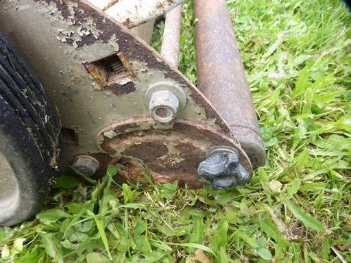

I looked under "Adjustment of Height of Cut". I went to turn the black knob on either side, the ones you've put the red arrow towards. The left one, the knob just unscrewed right off the screw. The right one didn't budge. Are they what I'm supposed to be turning? If so, it seems like they've totally jammed up.
Likes: 311
Hello user101!
Okay, I'm thinking ...
I'm still thinking ...
'Internet sensations' have been made out of less than this.
What you have confirmed is that the roller was set at the lowest setting in the Video.
The above picture (with my infamous red arrow) shows washers that shouldn't be there anyway.

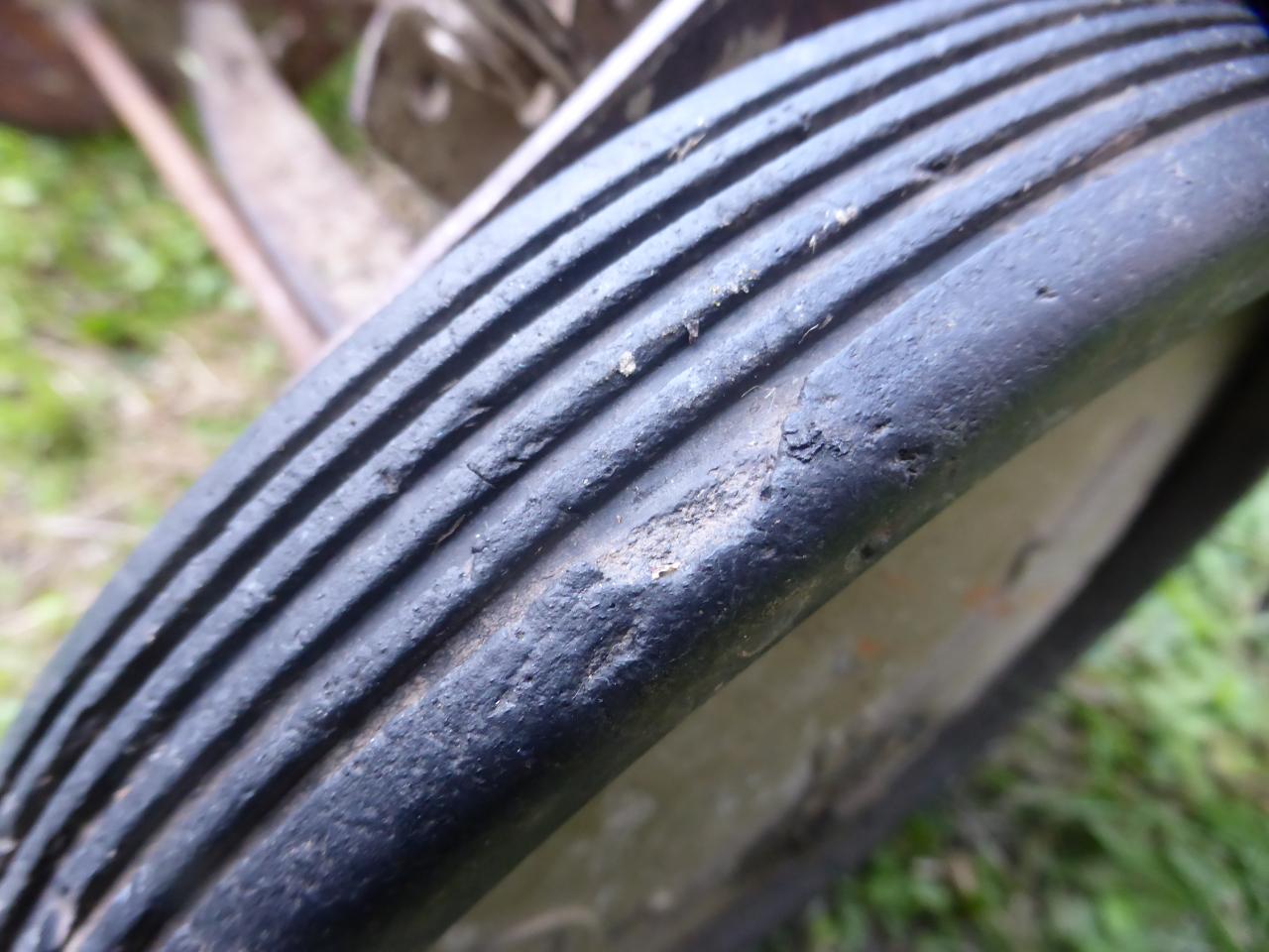

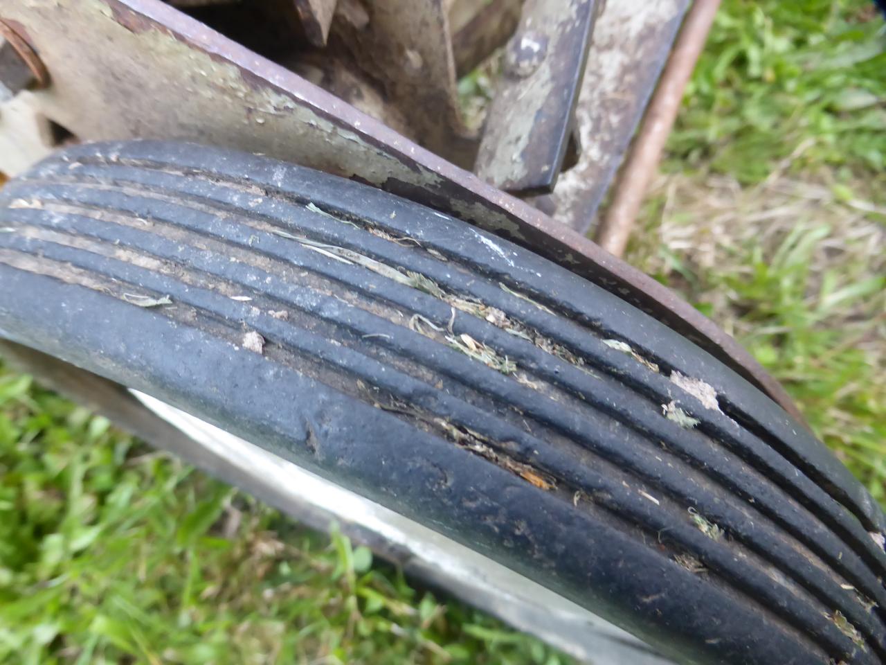

... Let's change tack, and assess the condition of the bottom blade and tyres.
Can we have a close-up of the bottom blade taken from the front?
Also, can we have a close-up of the condition of the tyres? There seems to be some damage.
This will help in assessing how to proceed in this matter.
JACK.

I've included some pics below. I hope they're the right thing and angles. In order to adjust the height, can I try some wd40, or is that a "no-no" or just not worth it? I'm guessing the presence of the washers indicates that the height may be somehow "permanently fixed".
Likes: 311
Hi user101 and ODK Members & Guests
They're great photos that tell the story here. To address this, this won't be an easy or short post.
I'll take the issues in turn: You said:-

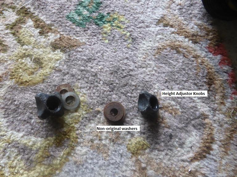

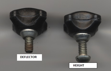

I think not, the washers were added because the knobs have just worn out.
The knobs seem to be beyond their service life, and the washers were added to secure the brackets.
The Wimbledon used four of these fasteners: two on the rear roller brackets; two on the curved
plate behind the reel (or cylinder). The difference was in how the screw was inserted:
The best way would be to simply grind off the heads of the bolts and free
the bolts from the roller brackets. Replace them with the better, deflector bolts and knobs.
[assuming the brackets are in good condition]

Looking at your recent photographs, I do not think this machine is economic to repair
as a regular-use lawnmower. The bottom blade is worn out and the reel (cylinder)
does require re-grinding. This is very expensive.
Second, the tyre rubber is clearly deteriorating. New replacement parts are not available
for Pope Wimbledons.
The bottom line is: unless this machine has some sentimental value, meeting your
objectives may not be economical.

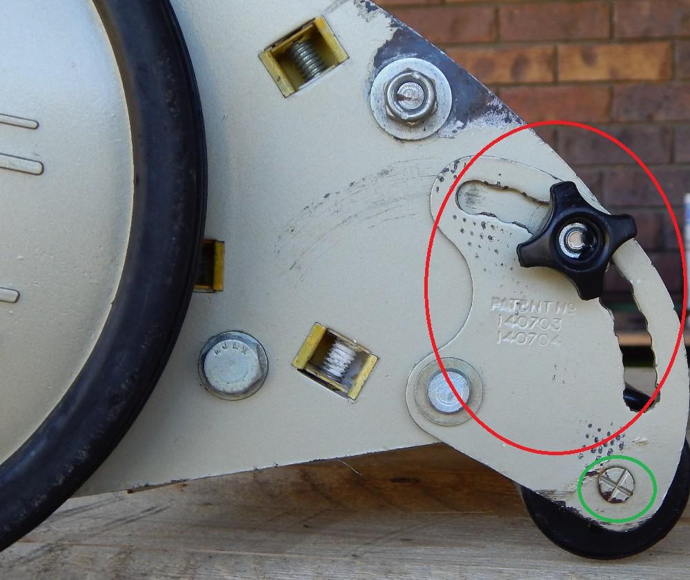

So, lets deal with the primary issue I identified (height):-
As Gadge said, the adjuster bracket (9) has notched serrations in it for quick
height adjustment. Knob/nut (18)has a chamfer that meets the bracket to set the height.
Your photo shows washers; suggesting that either the bracket is worn, or the knob/nut chamfer.
Whatever case, the low height of cut will greatly impede use of this mower.
We need to loosen the fasteners and adjust the height; so that we can exclude height of cut
as a factor in the machine being difficult to push - and cut grass.
Note that screw (17) is slotted (for a screw driver). Have you tried loosening the screws
this way?
JACK.

Jack, according to your diagrams above, I note that I don't have any slotted screw (17). It's just not there. All that was there was those black knobs sitting over the bolt-thing.

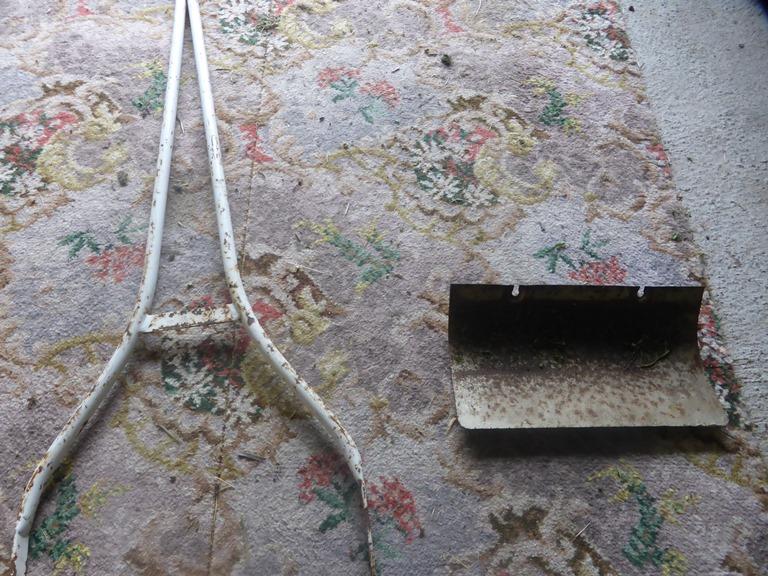

For now, what I'm going to do is include the photos I took of the parts disassembled, in the order I disassembled. I will comment after each one and then await further thoughts. If anyone needs better closeups of anything, just let me know.
the handle and deflector plate
these are the knobs which go on the bolts which somewhere should have slots for a screwdriver but don't. Also the washers which were noted before.

I get the impression I'm supposed to be able to put a screwdriver in this part and remove it, in order to remove the height adjuster thing. But I don't have one that'll do it.
At the end of all this, I fear we are still no closer to being able to adjust the height!
Bottom line: if the general consensus is that I am better off writing this off and buying a new or newer mower, just let me know. I'm starting to think that myself.
As for you last picture and whether you need a undo that pin.NO you don't,that is just a pin to hold the front roller on.The only way to remove it is to cut it off,but once its off it won't go back on,unless welded,so unless it is very worn then just leave it there.
Sounds like you have gone to far to soon and now you got yourself all flustered.That happens.
I think there was too much focus on the height adjuster there not that hard to adjust.The first picture CyberJack put up on the right is the height adjuster you can see the teeth and the different settings to where the front roller sits(Inside the red circle in the picture below).Also there is another adjuster near the blades but too late now.
Also there (In the green circle) is the non-removable pin for the roller in your last picture.
