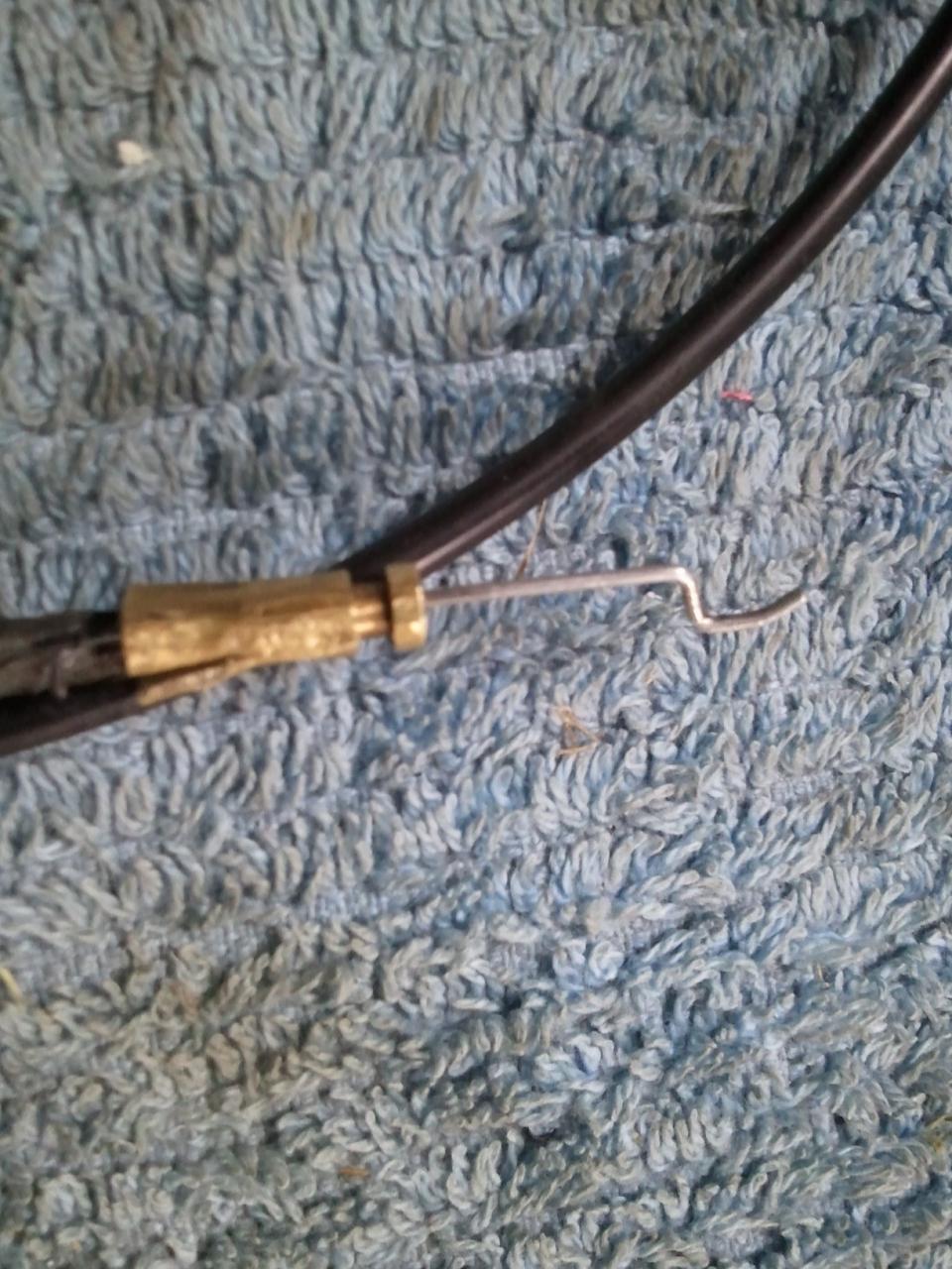

Hi Blumbly, thanks for you reply.No kinks in cable, but brass end piece pulled away from outer cable and I tried to push back on then squeeze with pliers but I made it worse and cracked i

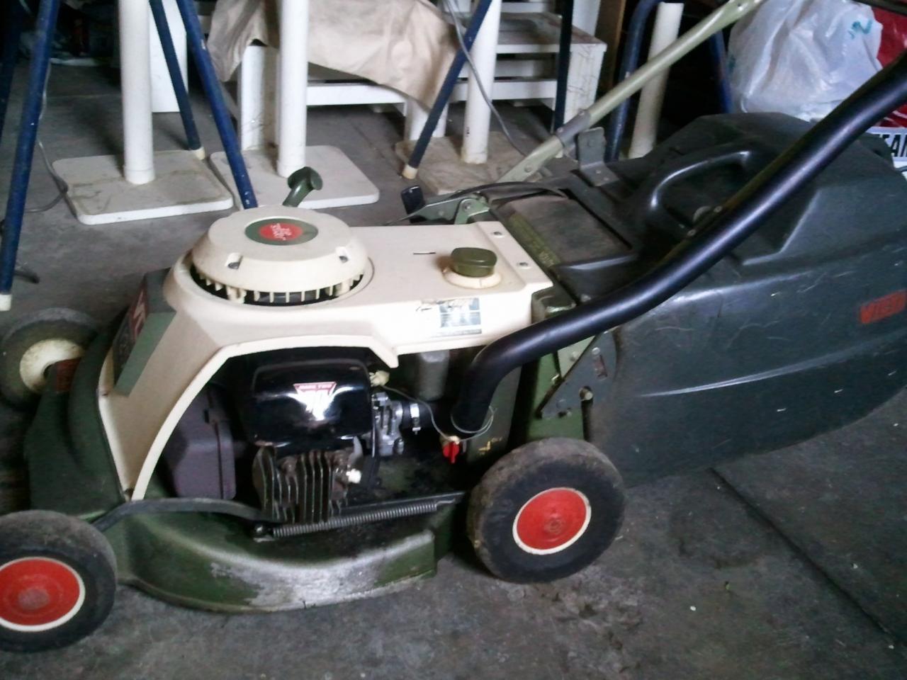

(See picture attached) ... Also, there is no paint left on cable to identify. Picture of mower also attached.
...Thanks [Linked Image]

Nice old girl there pjay53.
A VC-125 Mark I victacode V97 from 1971-72.
Also some great advice there too.
I might even get in touch with them,to see if I can get those hard to find ones.

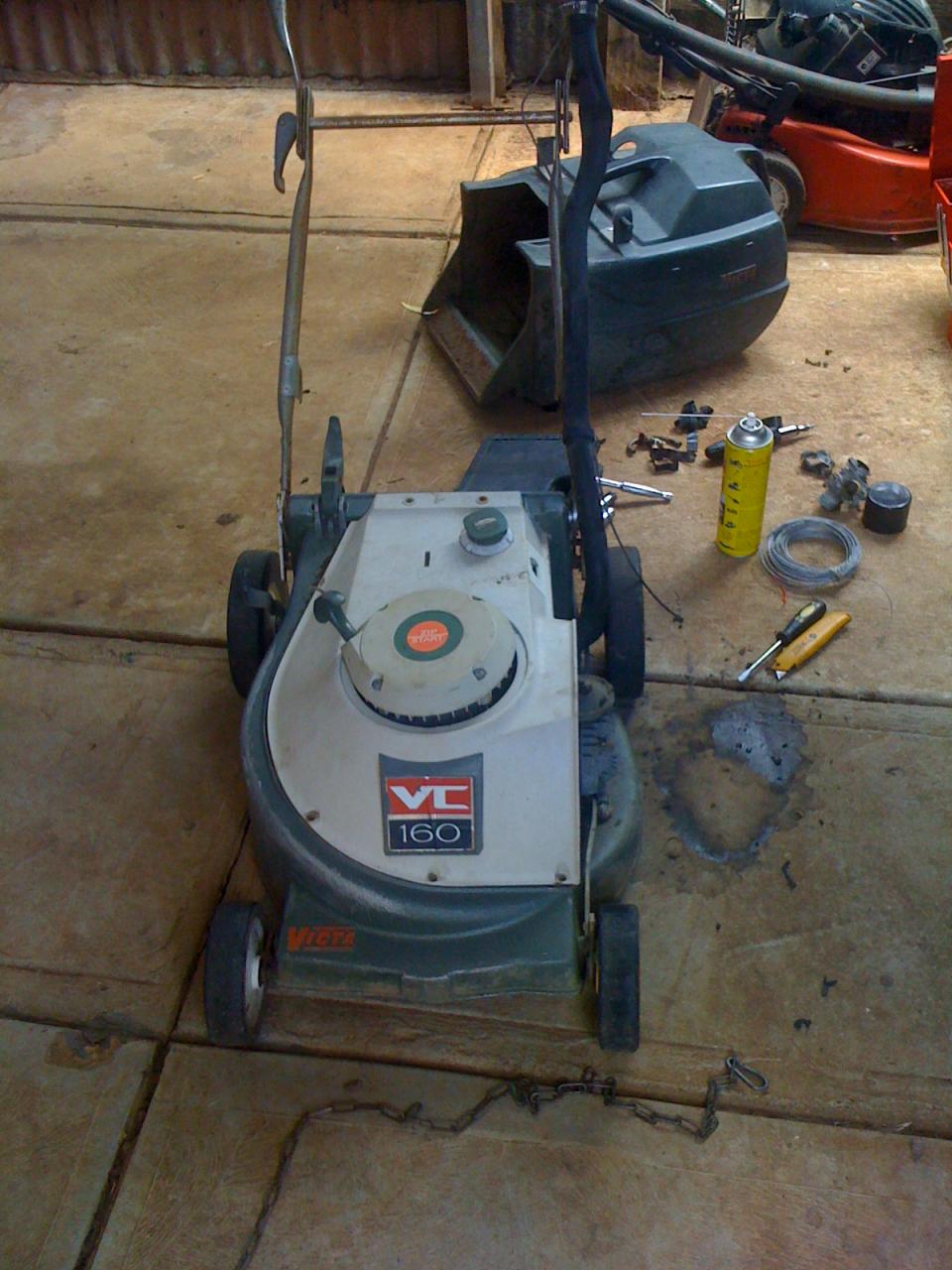

Posts: 325
just worked out how to up load a photo.
here is the mower... [Linked Image]
Yep ihatewetsocks a VC-160 Mark II for sure original engine number should be 5271 or 5272 depending on year made.Model number 71VJ victacode V96.
Sounds like your going to part her out.
