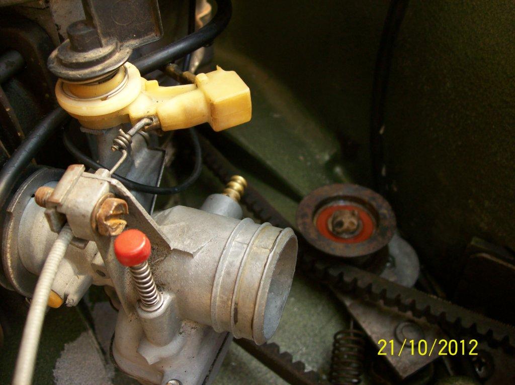

Like this it was.
Unfortunately for you I don't have nearly enough of my own so I can't spear one for you.You will find that a lot of the air tubes off other models will fit.Like a VC-Sports and VC-125's are the same hose.Really not sure if new ones are available.If they are hey please let me know as I do need a few.

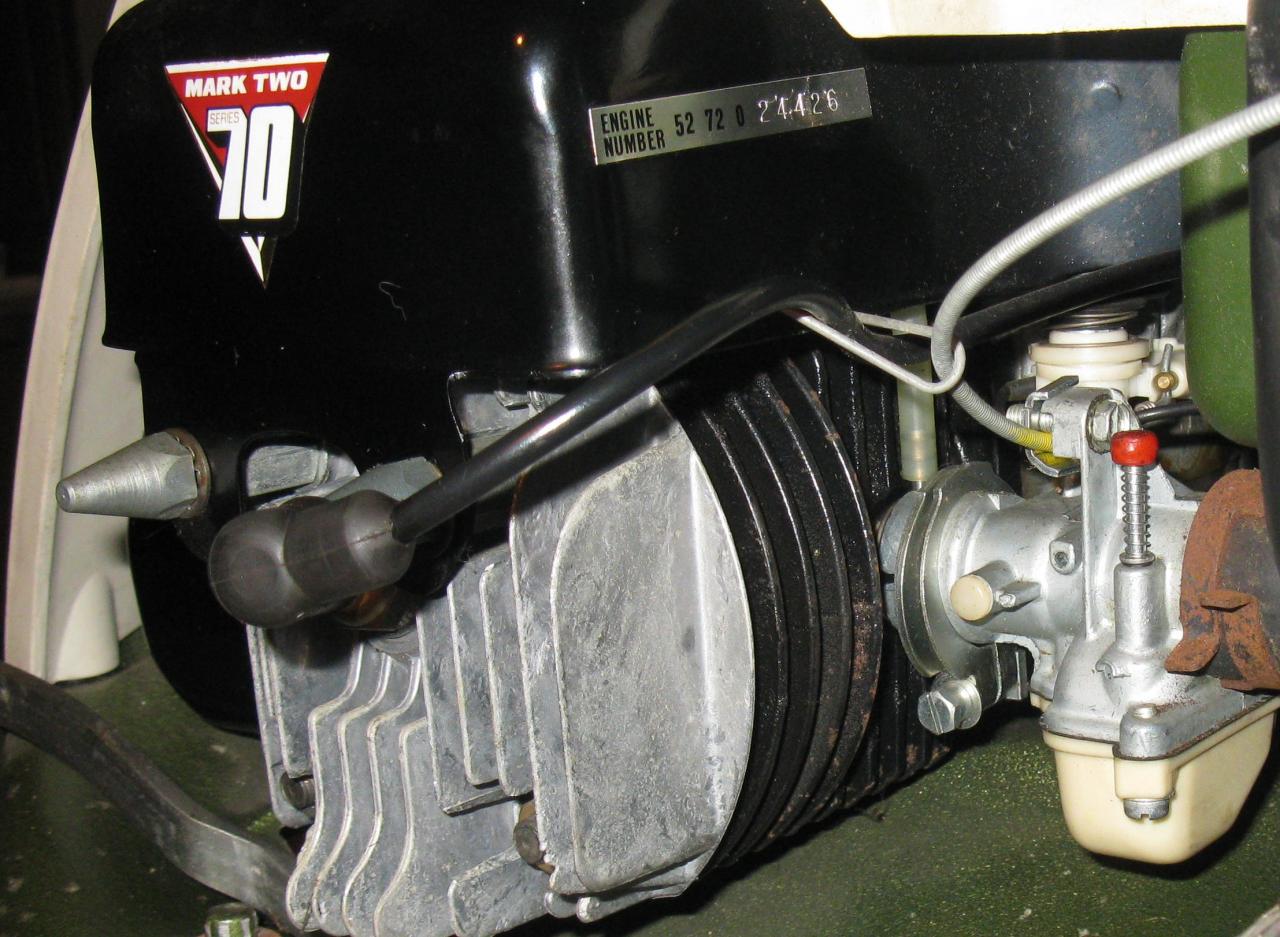

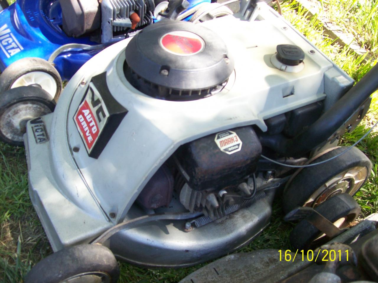

OK sounds like you may have a VC-160 Mark I and a VC-160 Mark III.The Mark I should have been a Vicatcode V80 being produced from 1970-71 engine number should start with 5270 or 5271 depending on year made.G3 carby alloy fuel bowl and an Impulse starter.Should have looked a little like this.
Your second mower sounds like a VC-160 Mark III from 1972-73 engine number would be 5272 or 5273 depending of year made.Victacode indeed is V111 G3 carby.It could have either had a alloy or plastic fuel bowl as Victa were changing to the plastic fuel bowl around that time.
My Mark III came with a alloy so I just left it on there.They have the Zip Starter on them.

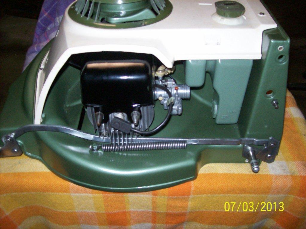

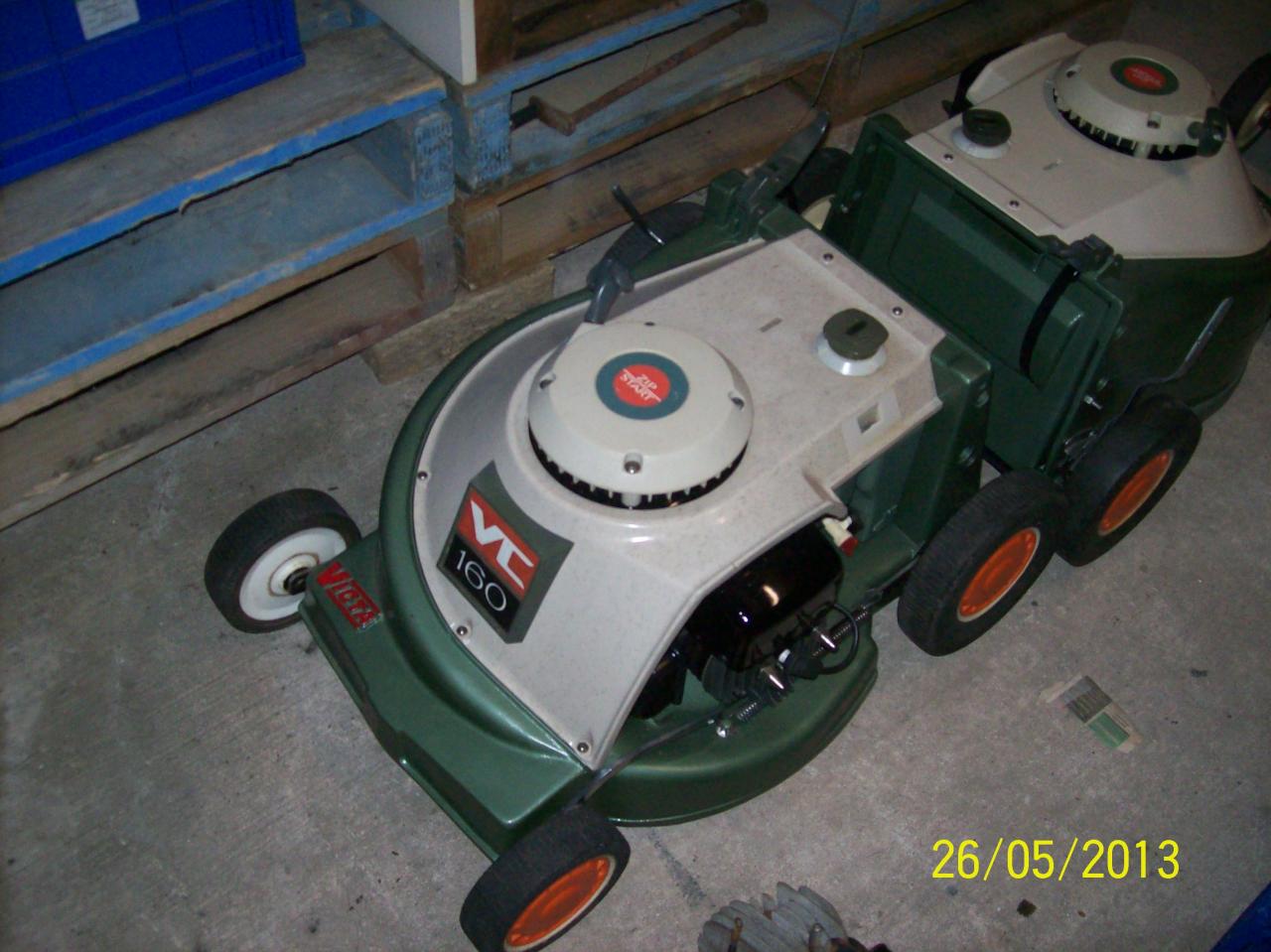

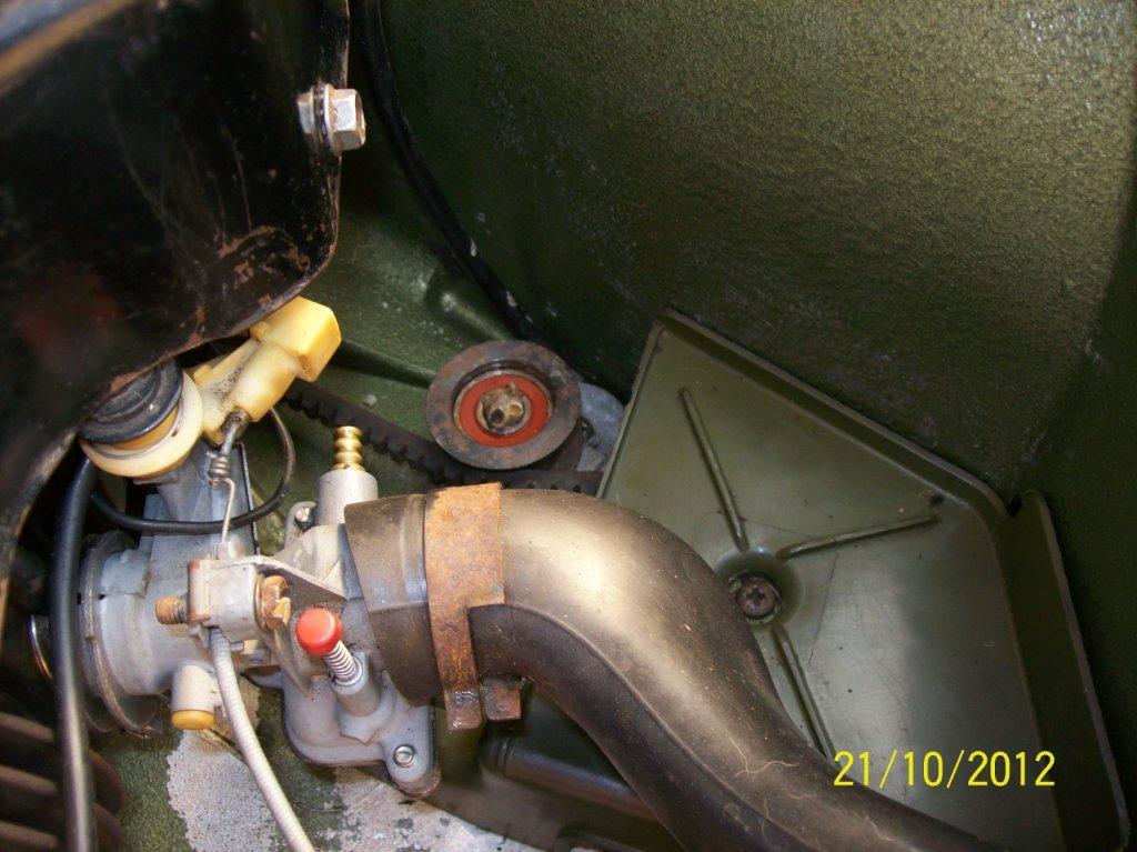

Here is a picture of a N.O.S mower from 1972 with the plastic fuel bowl.
and mine one with the alloy bowl both correct for this model.
The only other different's is some of the Mark III's had the casting on the bottom for the auto drive belt.Most didn't have it but some did.Here's mine that does.
Generally they look a bit like this.
As far as the work your doing on the engine,as I restore each mower I always go for the standard size bore.If I'm doing an engine and find an over-sized piston and bore I always put that aside and use a standard bore.I guess because I want them as close to factory as I can,and also I guess because once you start going down the oversize road you do start to run into a lot of cost,and I mean yes we love them,but how much do you really want to spend on them?
So if it were me I'd keep it standard.

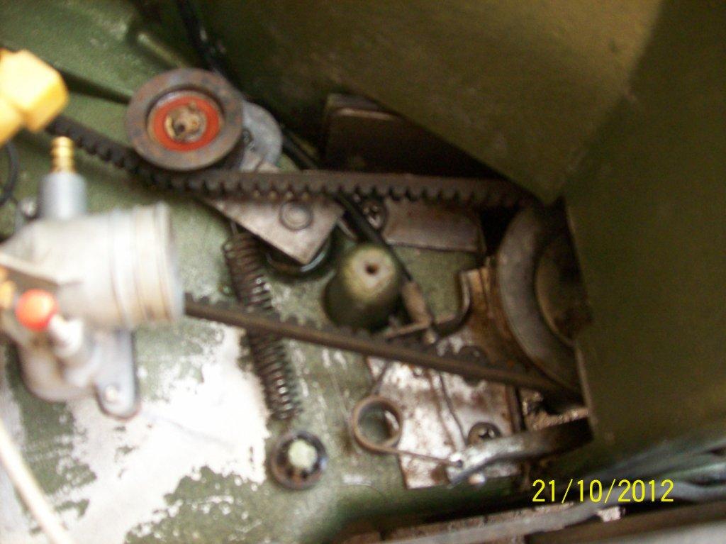

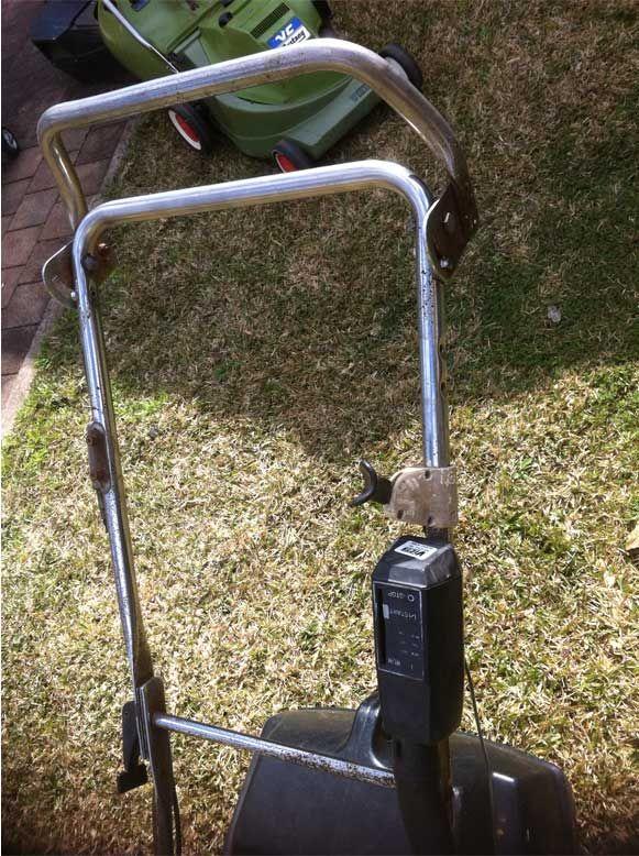

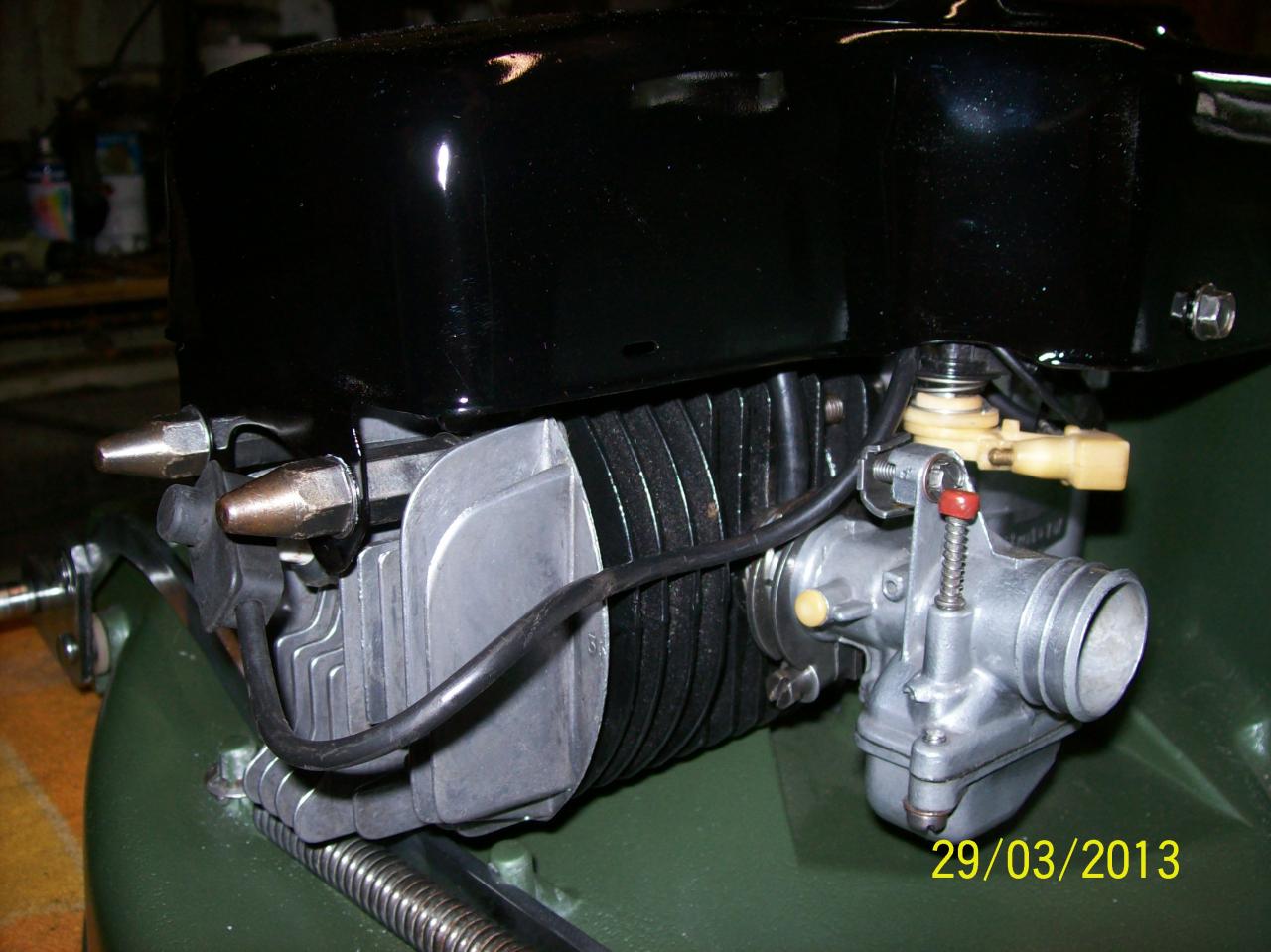

Arh cool that would be a VC-160 Auto-Drive Mark II 1973-74 engine number 10673 or 16074 depending on year of manufacture.
Should look a bit like this.
...and have a handle like this.
Second from the left is the Mark II.
Good work you should have great fun with that they are an awesome mower.
The belt when it is one should look like this.
If you need me to measure any of the belts just let me know and I will get it done for you.

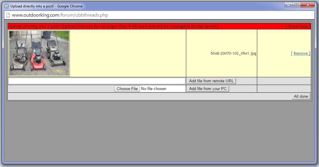

OK it's all fairly easy to upload pictures.You just have to keep the file size down and not make them to big then.I had the some problems when I first started.There are a few ways to solve this problem.One is by using paint then selecting
resize.I have in the past taken it from 100% to 40% it then is a good size and knocks the file in half.You could take it down even further here is the same photo resized at a different percentage.
This top one was resized at 15%.Took the file size from 1.25MB to 55.2KB.You may not need to go that small.
This one I did at 40%.File size from 1.25MB to 484KB.So that one is properly the better size.Once you have the size then just save as JPEG.Then you should be able to upload your picture with no problems.
When I do multiple pictures I use my e-mail program as it can resize really quickly,much quicker than paint can.
There other programs out there that can do it,but I won't confuse you with them as they all have a different ways of doing it.The simplest program sometimes (As is this case) are the easiest and the best way to go.

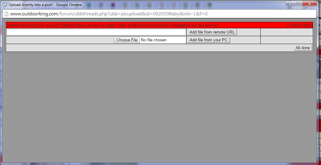

OK then when you want to upload you simple press the upload button.
Looks like this.
Then a window will appear.
Like this.
Then you click on choose file find the picture on your computer then click on that.
Then click on add file from you PC.
Then if the file is the right size it will then up load that picture.
When it has uploaded you will see it appear.
Like this.
Then you will know it has worked.
Just keep adding photos as you like until you get to 15.I think is the maximum it will allow to put up in one post.
Then click on all done,and your pictures will be uploaded.You will see in your posts lines like this,
[img]https://www.outdoorking-forum.com.au/forum/uploads/usergals/2015/02/full-5048-20062-102_0941.jpg[/mg]
This just helps to let you know it has worked.You can check by clicking Preview Post and it will show you if it has worked.

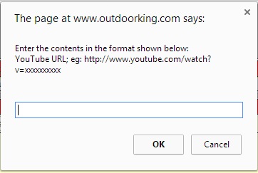

Videos are similar,except you click on,
Choose where your video is.In this case I use YouTube.
So it looks like this.
You then get this window,and type in the URL or web site address and click OK.
Then the window will close and you will have your video attached as you can see below.

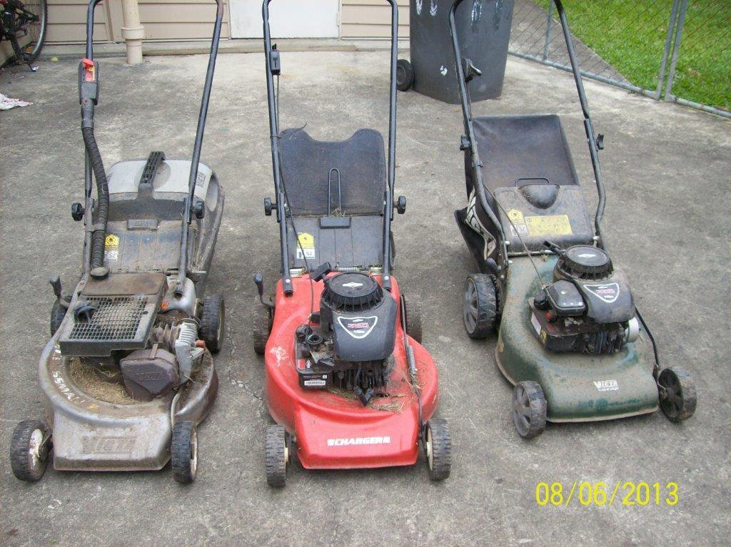

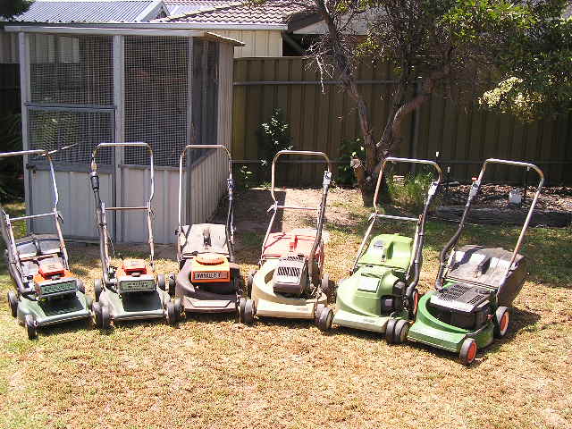

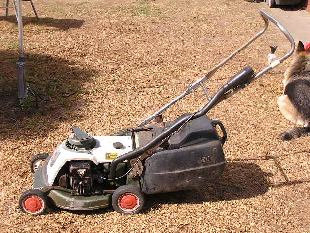

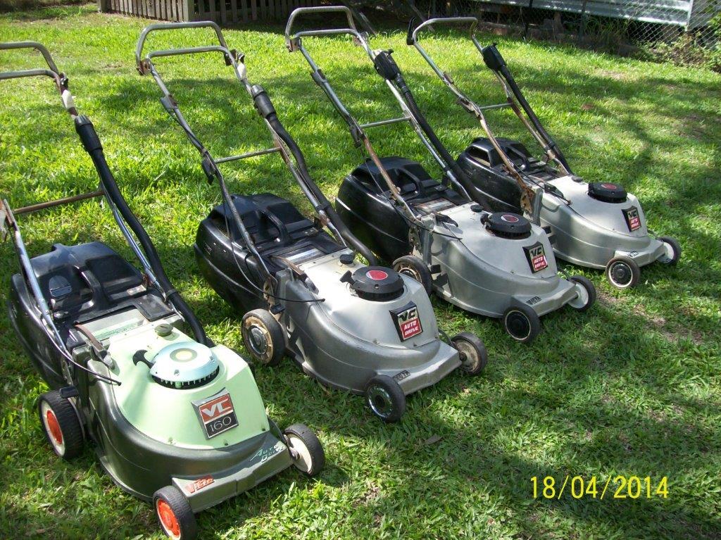

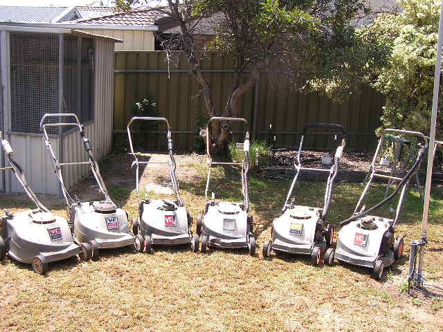

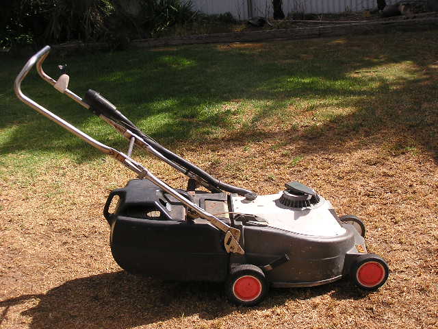

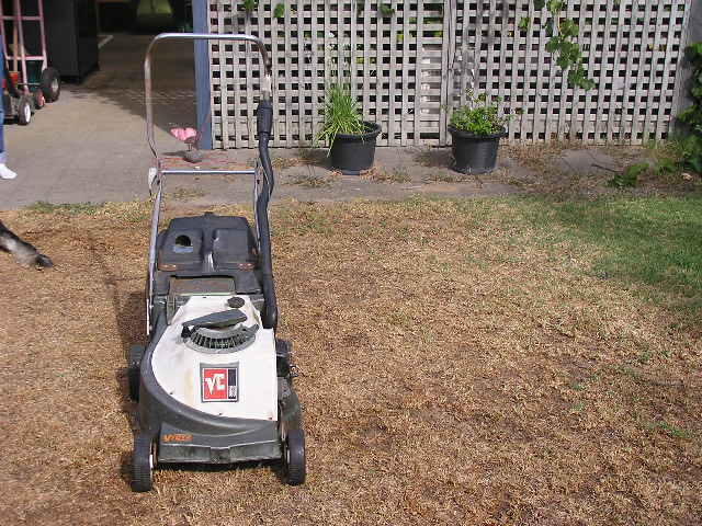

Well here I go. Ive just taken a couple of photos of what I have to date. First is my VC160 collection in various states of serviceability. Two V80's, one will be used as a "spares" machine the other will be a working example. I do have the impulse starter surrounds in the shed. The same can be said of the two V96's. The V111 is in Excellent mechanical and deck condition EXCEPT the handle bushes are so worn that they lean back so far the catcher falls off !!I will turn up some new nylon bushes as time pemits. The VC Autodrive is nearly finished except it starts but won't keep running for more than 10 seconds at a time. It has had a full engine rebuild including the later NOS crankshaft with the roller small end bearing. I suspect a faulty ignition coil as the carby is A1. I've ordered two new ones plus some condensers. When it is running it sounds excellent -very quiet mechanically. I fitted an M32 drive belt and I am also very pleased that the drive system works as it should.
The second photo shows the rest of the collection( so far) including two V147 "store brand Corvettes". I was lucky enough to get a brand new old stock catcher for these as both originals are lousy. Both have had little mechanical work done except a carby and fuel tank clean and air filters. Both start and run just like they should. The first could do with a set of starter pawls. The next one was my first - a Sunbeam LawnKeeper 160 G4.This was in excellent condition deck and catcher wise but has had a carby kit and complete engine overhaul. Runs like new but as with all the early G4 carbs is not as easy to start as those with the primer bulb. A nice mower all the same. Next is one of my prize items. The Victa Supreme 170cc twin. I have only had this for a couple of weeks and have done nothing at all to it except fill it with fuel and mow my lawn ! It is fairly "grubby" and when time permits I will clean it, overhaul the carby, clean the tank and fit an external inline fuel filter (something I do to ALL my mowers). This mower came with two spare engines, one complete and intact, the other in pieces, AND 3 spare ignition coils. I was surprised at how easily this mower starts usually first pull, and how smoothly it runs.
Next is a mid '90s Power Torque mower salvaged from the gutter, complete with excellent catcher. This mower had obviously been looked after for many years as it was in excellent condition deck / catcher & handle wise. The engine was clearly worn out so a recond engine was bought from my local mower shop for less than $100, which was cheaper than having it bored /pistons/ rings/ bearings etc myself. A carby kit finished it off and it now runs like a Swiss watch. I have to have one Power Torque model in my collection and the alloy deck clinched it. I like this mower. Lastly is a Mk 2 VC Mustang. This was given to me by my local mower shop owner after my request for a secondhand cylinder head ! It was traded in on a new mower. Again, all I have done to this one is steam clean the whole thing, clean the carby and fuel tank, fitted a fuel filter and away she went.
As you can see I have a few projects up my sleeve but the main one is the Autodrive, then the VC160's in order of manufacture, V80, V96, V111.
Wombatini. [Linked Image]
Dunno what's more Impressive, the VC Collection or the Essay...
Great collection Wom! An enjoyable, frustrating, challenging and rewarding time ahead....There is nothing better than seeing a complete lineup of models on Display....
The VC is fast becoming the modern collectors mower of choice for restoration as I think it intersects perfectly at the point of Vintage classics and modern advancement and styling.
Enjoy and please keep us updated on your progress
Maybe one day I might delve into this very popular machine....One day:)
Awesome collection wombatini.Love the VC's.We have come up with other names for the VC-160's instead of using the victacode.Not sure where it came from,but it goes.
VC-160 Mark I (V80)
VC-160 Mark II (V96)
VC-160 Mark IIIA (V111) and
VC-160 Mark IIIB.(V111)
The difference between the VC-160 Mark IIIA & B is the B was set on a Auto Drive casting.
If you have a look and my VC-160 restoration page that is the one my Mark III is based on.
It does make it easier and there other differences between each model as well.

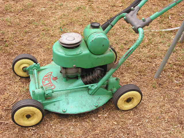

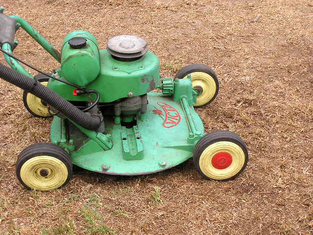

Another day, another Victa. This time it is a late 50's or very early 60's Victa 18 with the fixed non recoil starter pulley. This has issues and does not run - YET ! No spark is the first issue. Crook ignition coil although somebody has recently fitted a new condenser. The points were great insulators !! Crankshaft bearings are real rough - does any one know the types ? And seal sizes ? I'd like to get the bits before I dismantle it.It has quite good compression though. I really think I should concentrate on getting the VC's 160 Mk1 and Mk 2 going first - what the heck !
Wombatini.

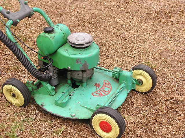

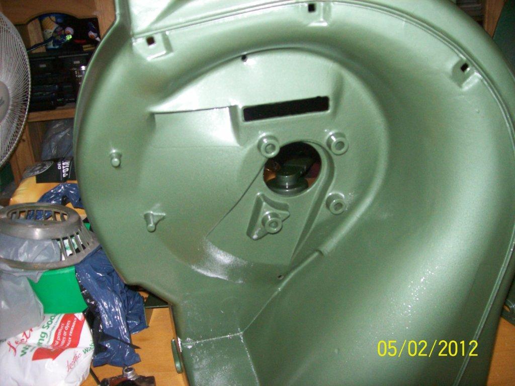

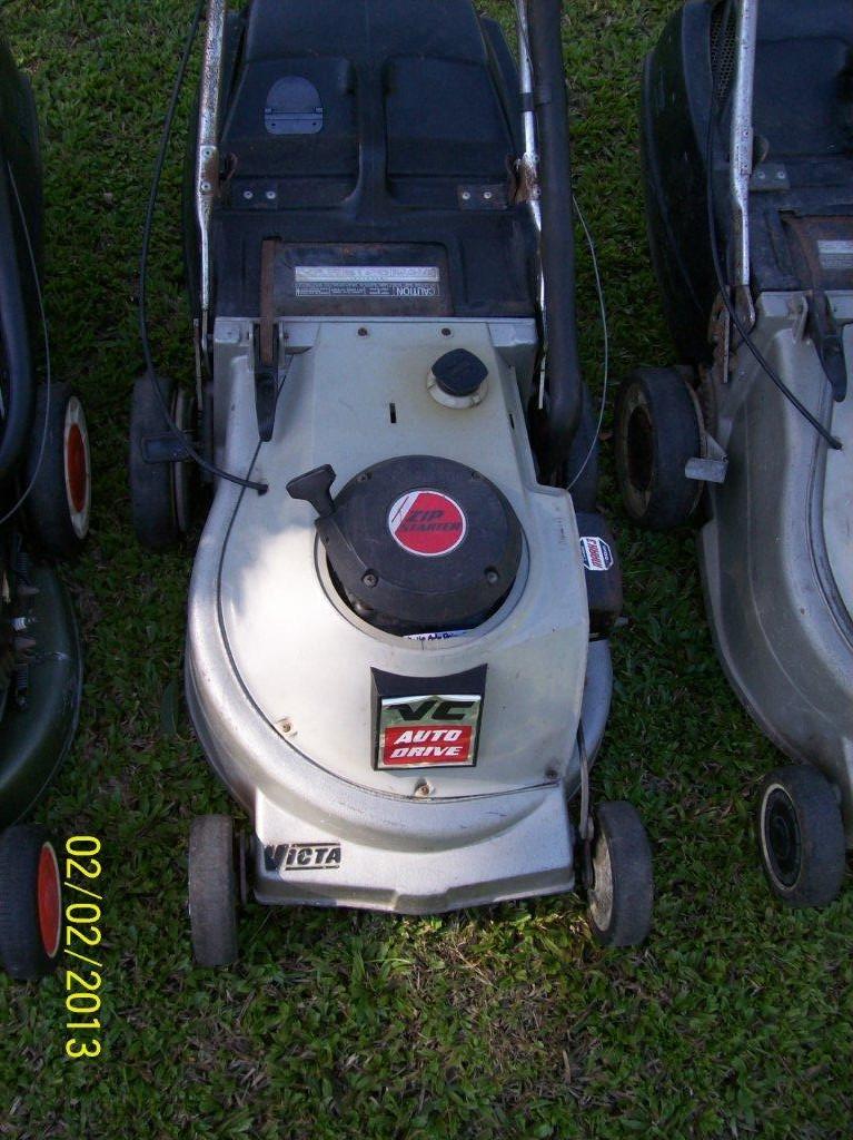

G'day everybody, An update on the VC160 MKI. She lives again ! Started to dismantle her yesterday arvo and was quite surprised and delighted by what I found. Somebody has recond this engine in the not too distant past. There were hone marks on the bore, the piston ring grooves were extremely clean and the rings were as new so they were all just cleaned and refitted. Also, the bore is standard. The lower crankshaft bearings were knackered due to a totally stuffed lower crankshaft seal but there were no seal wear rings on the shaft. The whole engine was cleaned and new bearings, seals & gaskets fitted, I gave the cylinder a light hone and assembled the engine and refitted it to the base. Carby was cleaned and overhauled, new air filter etc. She started after the 4th "wind up" and idled beautifully. I ran her through the rev range over a 10 minute period and then let her idle for 5 minutes before running at full throttle for a further 5 minutes and then idling again. She does not "oil up" at all. Very quiet mechanically. She will probably do another 40 years without trouble. Previous owner said she (65 YO widow ) bought it new in 1970 and got rid of it because it would not start. Wonder why ???!!! All I need to do now is get a set of blades as the local mower shop does not sell the "old style" blades any longer due to no demand.
I have done nothing to the old Victa 18 as yet [Linked Image]
but I will do so shortly. In the meantime I will turn my attention to the VC160 Mk II as this is not yet running & I'm not really sure of it's condition, but I do have a "derelict" machine to pilfer parts from if required. Stay tuned smile
Awesome VC-160 Mark I there wombatini,especially with the starter cover.It all looks fairly original except maybe the fuel tap ,it should be white with the red knob,and I can't quite see the hub caps.They should have Victa on them I can't quite see them properly to tell that,but everything looks good.
It's have to find them that original.
Well done.

Hi Blumbly, Your right about the fuel tap - it's a new one. The old one leaked when turned off even after cleaning it and putting new "O" ring on it. The hub caps are original I think as they do have VICTA on them and are the reddy orangey colour. I do have one question though. The impulse starter cover - were they made in two different heights ? I ask because the winder slightly scrapes the top while turning. The base is sitting fully in it's recess in the dress cowl. I have two of these covers and they are both the same. Another question - I have taken to fitting an after market inline fuel filter to my mowers, hidden from sight if they can be - but I find they seem to restrict fuel flow and make starting harder and in some cases starving the engine while running. What seemed like a very good idea may not be at all ? I always filter my fuel as I fill the tank anyway - overkill ???

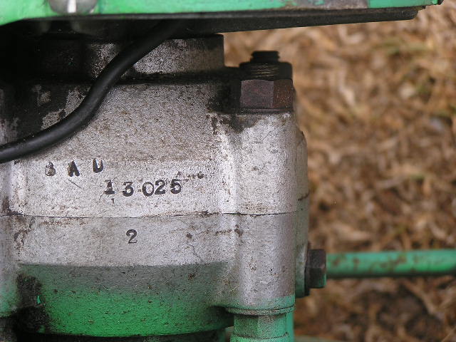

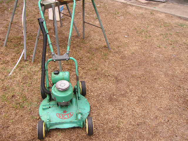

Is anyone able to give me a positive ID on the old Victa 18 in my photos ?
Wombatini.
Hey Wom,
Ill leave the VC questions to the experts smile
As for the filters, im assuming your using the tiny inline ones from auto shops? The problem with these filters on a mower is that the fuel is gravity fed and may not have the pressure required to push the fuel through this type of filter. The Victa tap should have a filter integrated and is made for a gravity feed system. If you add another filter your going to restrict it greatly. If you cant freely/easily blow through the inline filter, then don't use it.
In regards to your 18,
As it stands its a Model 4 Standard" with a later Model 5 Series 3 engine. Snorkel Air filter and tap are Non factory fitments.
A big bonus is it has a good set of AM wheels, that will save you quite a few dollars in your resto.
Correct engine serial for this Model can range from 110,000- 300,000+. (This includes automatic serials)

Like this filter on top of the brass fitting.
That really should be all that is needed,as anything else will restricted the flow.
The cover for the starter was only ever one size as the VC-160 Mark I was the only mower it was fitted to.I guess that's why they are becoming hard to find.
It will most likely be the dress cowl is sitting a little to high.As the starter as you know is bolted to the engine and perhaps the dress cowl is a little higher than it use to be.
Is the dress cowl plastic? I only ask as the originals were some kind of fiber glass,but not fiber glass (I'm not sure exactly what it is made of) and the later replacements were plastic as were the VC-160 Auto Drives,except the Mark I.If it has been replaced with a plastic one it may have warped as the plastic doesn't age well.
So have a look and try to see if you can fix it as you don't want to have to try and get another one as they are getting hard to find.

G'day HT6 and all,
Been a while since my last post (minus the bugle Ha Ha !) In that time I have stripped the Victa 18 and overhauled the engine with new bearings and seals, rings etc. Would love to get it running but the ignition coil is buggered and I cannot seem to track down the old type with the flying primary leads. The universal coil will not fit. Any suggestions ? Also got an old, early / mid 60's Victa Cortina 2 machine the other day, complete bar catcher. Aside from the height adjuster being broken it is quite good cosmetically. I pulled the rear axle and height adjuster from a wreck and fitted it so now it works OK. Cleaned the carby & tank, fitted a new spark plug. Hey Presto, started first pull and ran very well. Yes I did say PULL. Some philistine has fitted a Zip Started to it instead of the impulse starter. Since I happen to have a spare impulse starter and drum I thought I'd fit it - OH YEAH !!! The 3 tangs on the flywheel had been filed off so that put paid to that idea. However, she dos run nicely so until something turns up to rob the correct parts from, she'll stay as it is for now. Since the lawn needed mowing anyway I used the old Cortina 2. Does any one know if I can still get the air filter for this mower ? It is the model that sits in a housing bolted to the front of the crankcase with a rubber tube going to the carby and the choke on the air filter housing. I'll post some pictures shortly.
Wobmatini.
Posts: 16
Hi Blumbly, Yes I am starting to agree with you about my "extra" filtering. All my restores have the original tank filter but may be I'm being over protective. I have removed several of them due to fuel starvation issues. Live and learn ! All my VC160's have the fibreglass look-alike cowls and I think I've found the reason for the scraping - the starter mount bushes are the wrong side of the mounting lugs, raising the starter by about 1.5mm. This is how I found them but it was obviously wrong ! Will rectify shortly.
Wombatini.
Yes even that kind of difference with that starter will make the difference.I'm glad you found the problem.
