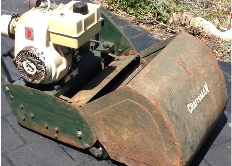

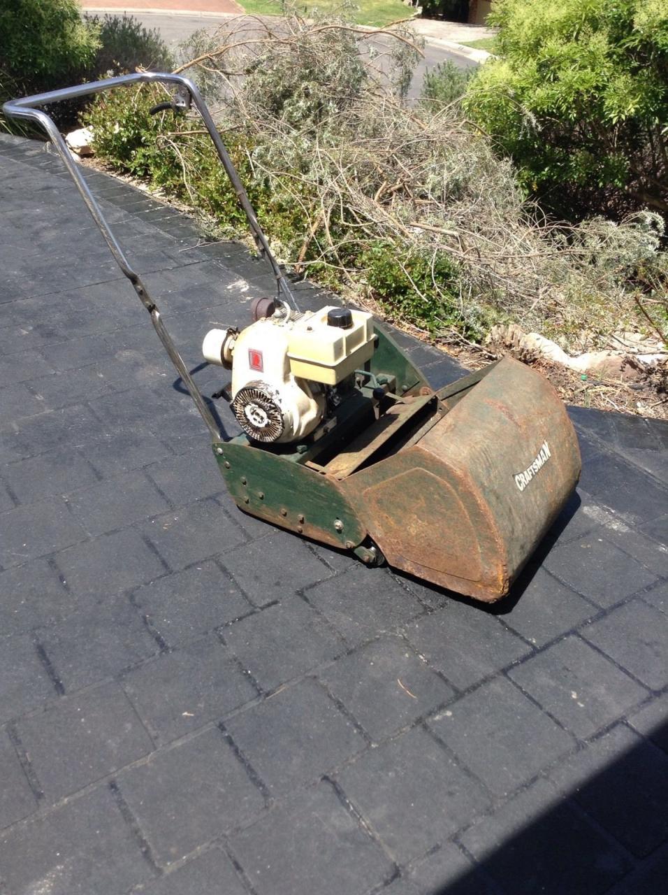

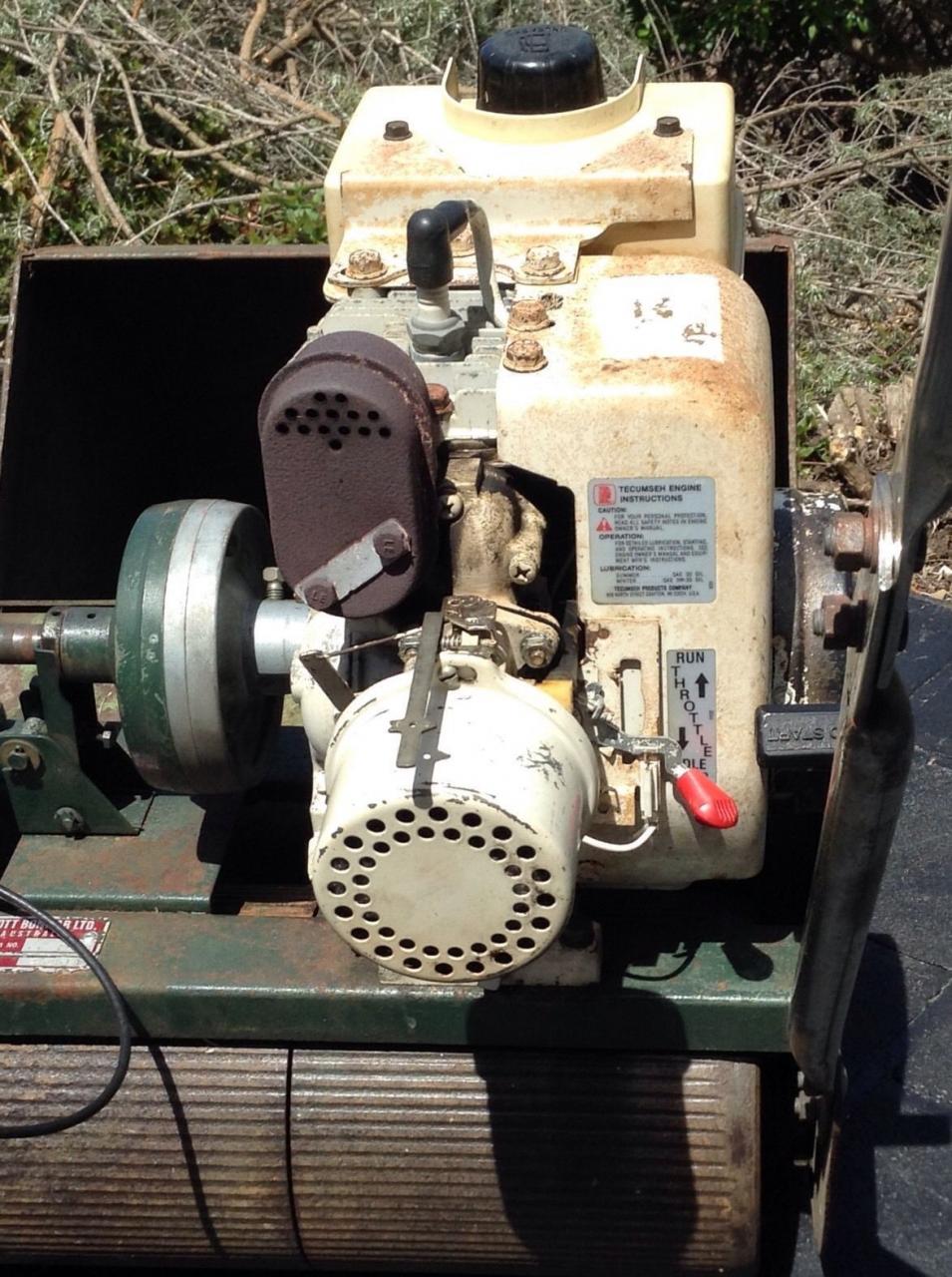

Hi to ODK Members and Guests,
Global moderator CyberJack has discovered this machine that has just been sold on eBay; it is enigmatic and an unusual find...an Scott Bonnar Craftsman... I have never come across one before, and we are most interested where it falls in the SB lineage.
We can from the pic, we can deduce this about it:
It is a 17" machine, manufactured in Thebarton, it possesses the Series 2 Model 45 chassis, so that puts its date of manufacture after December 1975....and that the engine has been replaced with the new inner clutch half to suit the PTO of the Tecumseh.
It has the pram handles of the Lawn King and appears to have been re-painted at some stage...It may not have...
It is a shame that we don't have a pic of the ID plate so we can see the model number.
We know that "Craftsman" was an MSSA brand...so was the machine a store brand...I think so. wink
Does any member out there have any further info on this enigmatic machine? we would like to know a lot more...
Here's the pic:
G'day folks;
It hasn't been sold yet; the seller is running a bit of a 'Dutch auction' it seems - reducing the starting bid in each relisting, after starting high. It's located in Rouse Hill, NSW for anyone interested. Interestingly, the seller has an actual SB45 also for sale, also with 3hp Tecumseh engine.
As Deejay says, 'Craftsman' was the brand MSAA used on the 'house brand' mowers that were made for them. Initially by Australian manufacturers, but in the MSAA's latter years they seem to have had an agency arrangement with the US Sears Co., who have long owned that trademark for the US market.
The Tecumseh engines do look pretty correct for mid-1970's too, from what I recall of the units fitted to some of the Mobilco-imported Ariens tillers of that time.
It would also have been around that time, that James N. Kirby [and Villiers] discontinued local engine manufacture, following the Whitlam government's removal of import tariff protection on small engines.
We might as well have the two useful ad pics up in full resolution:
Hi Guy's,
I don't think that the engine is original also another give away is that there is no speed controller on the Handle Bar and only on the engine itself. All Scott Bonnar mowers had speed control at your hands and not down at the engine.
One thing I've just noticed and that is I think we can roughly time date this machine to around 1974 as it has the newer style ID plates but is running the two plates one on top of the other just like the last Brass ones did around that same era, so this would be a very early Series 2 Chassis.
There are a few things that don't add up and this makes it really hard to positively identify this machine without any reasonable doubt.
Hope this adds to the bigger picture
BB
Hello DeeJay, Gadge, BB and ODK members,
I waver between being a Doubting Thomas and smelling a rat on this one.
I share BB's concerns on this one.
If this machine is genuine, it will have been made for MSAA.
Victa, Rover and Masport were making Craftsman lawnmowers for this organisation.
However, I can't find evidence that Scott Bonnar were.
Does anyone know whether there was an SB rotary Craftsman?
That front decal looks more suited to a rotary base...
It certainly isn't "Craftsman .. by Scott Bonnar".
BB, it's got to be late 1970's, given the release date of the twin rail machines.
[Administrator DeeJay has put that at December 1975]
And what's that rubber grip doing on the hair trigger?
I think this machine is illegitimate or a pretentious gold & white digger.
I think we need more evidence.
I will not smile unless more evidence is forthcoming!!! frown
All very interesting.
JACK.
No craftsman rotary Im aware of Jack....Just curious, what are you trying to find out? This mower is identical to the one I scrapped and mine was a craftsman...it had one red alloy plate on the rear rail and one brass and a 2.5 briggs. It did not however have an SB sticker ..is the date wrong for an SB? Is this your confusion? Just curious is all:)

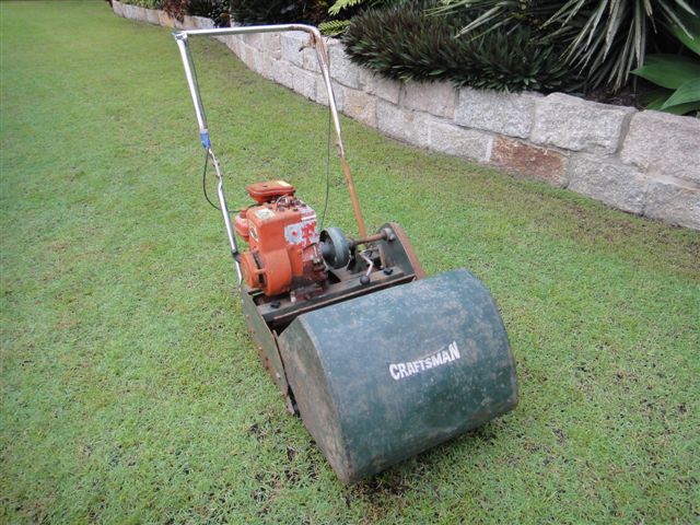

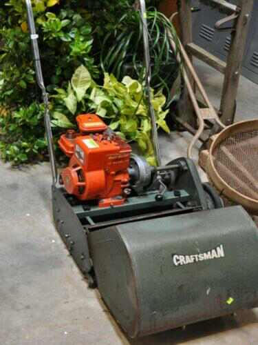

Another photo of a Craftsman for the record. This is from an auction site in Adelaide.
Sir Chook
That's fantastic Sir Chook,
That seems to heavily support my theory on the Briggs being the correct engine and it would've been a 2.5 HP unit as well with the small tank.
Can I ask what site you found this on ?

Here's a pic from a past thread of a 1977 Briggs engined 'SB45 Craftsman' example:
I guess it's also just possible that someone was making aftermarket SB catchers back in the 70's, and using the Craftsman brand on them...
The last two image examples are Identical to Mine also...:) Just cant remember the date. Its probably some colourbond fencing now anyways...RIP.

In Sir Chook's picture it would appear that SB used 45 green for a branded mower.
Second, SB removed thier own name from the catcher decal - something they did not do
for the 33 or 45 Lawn Kings. I guess it would be nice to find out what the chaincase
decal looked like on the 45 Craftsman.
Second, Sir Chook and Moderator Gadge's photos confirm BB's contention that the regular
B&S engine was used. No special colour scheme for the 45 Craftsman.

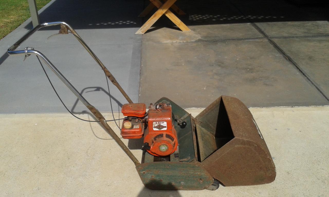

I am Brand new to forums (first one ever so I will need to get my head around things as we go along).
I have recently purchased a Scott Bonner (Craftsman) with a 2.5hp B&S engine as described in the posts above.
It is a fairly rough rust wise but seems to run perfectly - Starts 1st-2nd pull every time.
I have been reviewing your site for the past month or so and have found the info to be extremely helpful.
I have some photos of my B&S and could post if required (when I learn how too!)
watson28711
Hi Watson28711, and a warm welcome to the forum.It's great to have another SB Craftsman owner on board, as we all like to learn new things and tinker here. grin
We would like to see some pics of your machine, as this will help the archives. wink
Instructions for posting pics can be found HERE
Any questions that you may have please post to this thread.
Joined: Dec 2014
Posts: 7
Hi Deejay & ODK Members,
Thanks for the welcome
smile
Deejay thanks for the instructions on posting a picture this will see if I get it right or not.
Hope these pics help the archives should you require anything more specific yell out and I'll see what I can do.
watson28711

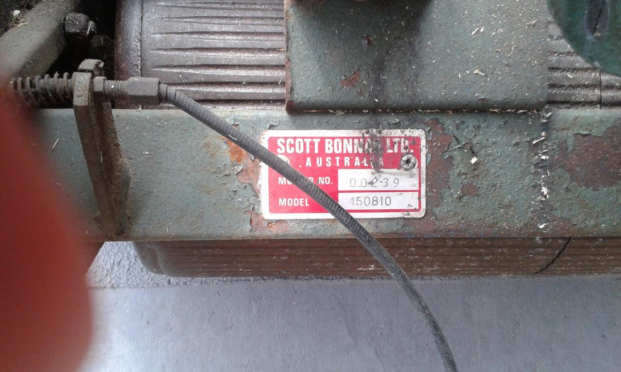

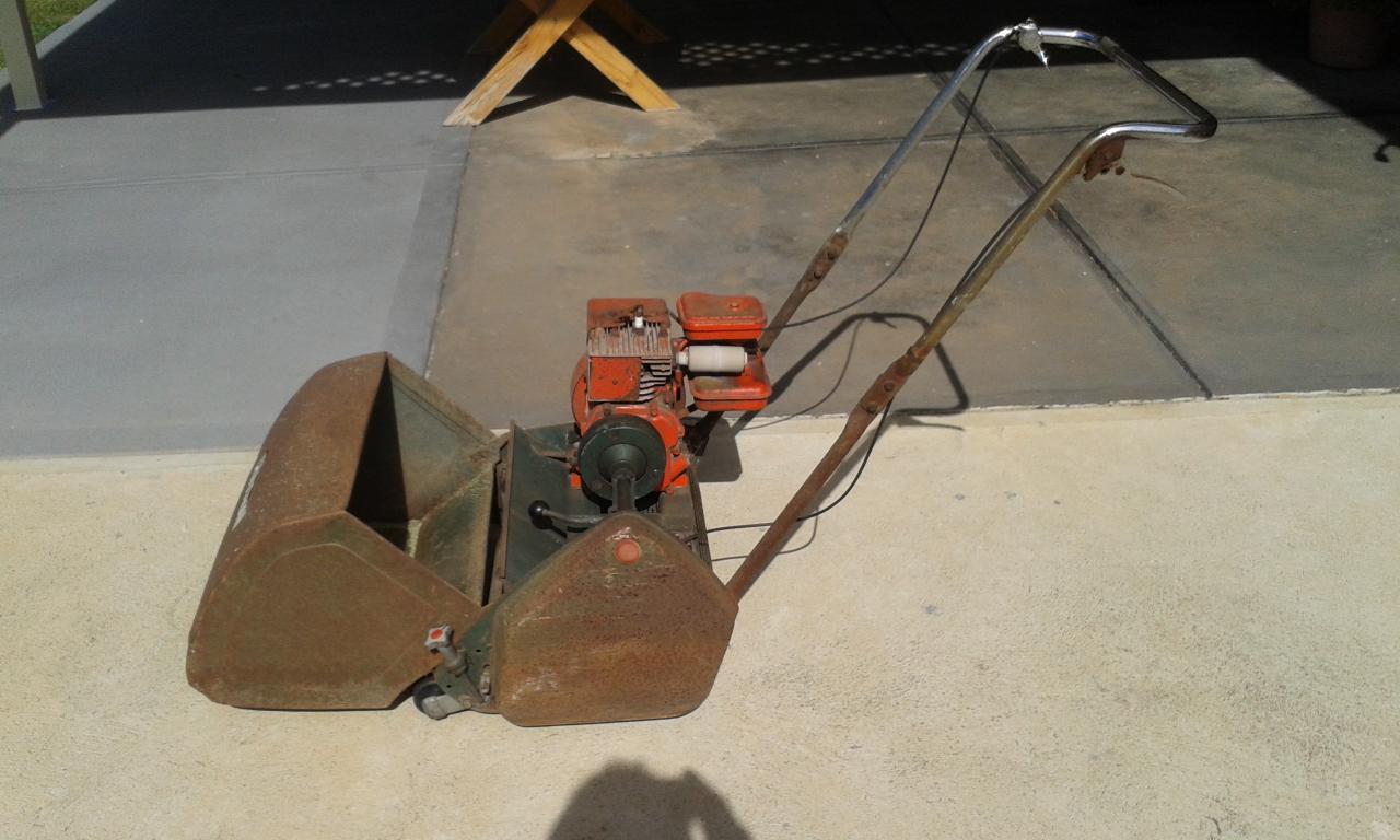

Hello all
I picked this machine up today, looks very original to me ( chain case and deflector plate have been re painted or replaced as well as engine side of cutter clutch). Engine dates as 75. Not sure if this ads any further information to the topic.
wce
Hi wce
Many thanks for the record.
The maker's plate goes to your mowers provenance.
Another one is saved.
All of the 45 Craftsmans seem to have just one model number: - 450810
I guess SM adopted the 'pram handles' to save a few dollars,
but that design concept was favoured by SB on earlier machines.
Ideal for straight, open areas, those handles were perfect for
maintaining straight rolls of turf [e.g. tennis and bowling lawns]
