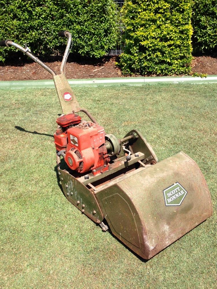

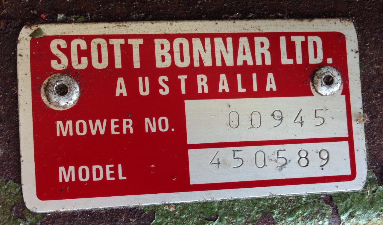

Hi I am new to the forum and I have just bought a Scott Bonnar Mower#00945 Model 450589 to do up. Thought you all might be interested, the Mower has been sitting in a garage for the last 25+ years and I am going to attempt to restore it. I am not that handy but I am going to give it a go. I am sure from what I have seen on the forum there is plenty of knowledge in here and people willing to help out with advice, I think I may need some along the way.
Jaycee
Hi again SB Obsession,
We would like to help you restore your Model 45, but to help us we will need larger pics of your machine, from different angles, including the cylinder reel and bedknife blade, and the inside of the chain case, ( which is on the right hand side, looking from the front) with pics of the sprockets where they are not covered by the chain.
Instructions for posting pics can be found HERE wink
This will let us access the condition of the sprockets and chains, and the overall condition of the machine. grin
Here is a pic showing good detail of the underside of a Model 45 (Series 1) mower chassis, to give you an idea of the size....
Could you also please post the complete string of numbers: (Model, Type and Code) that are stamped into the metal air cowling of the Briggs engine, from which we can get the date of its manufacture, and model information...this will also help us determine a rough idea of your machine age, as you cannot establish a Scotty's age by the model number or mower number. wink
Joined: Jan 2014
Posts: 36
Complete String of numbers : 80202 060702 76060803
Hi SB Obsession, and thanks for posting the Model, Type and Code. Your Briggs engine was made on the 8th June 1976 and your machine most probably manufactured later that year. wink

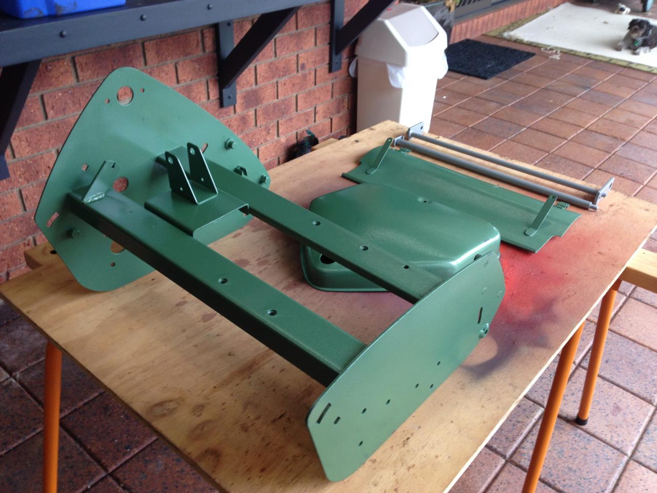

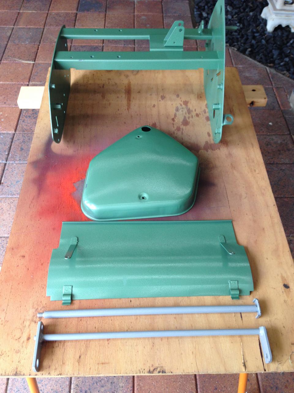

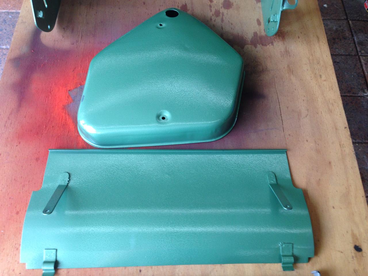

Hi see below photo's frame parts painted in Septone Hammertone Green couple of items will need repainting as they have been marked already mad
Hi Jaycee,
Nice work thus far mate, it will look like a bought one when finished. good1
When you take your reel and your soleplate complete with the bottom blade attached to the engineer ask him to supply a new bottom blade and fit it for you. Do not attempt to remove it yourself, you can crack the cast iron sole plate and they are $$$ to replace. wink
