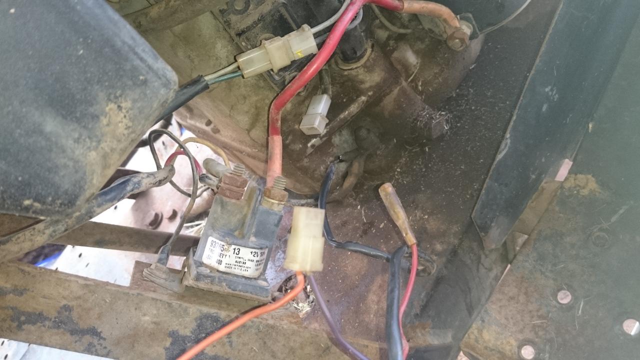

Joined: Sep 2014
Posts: 47
very nice and informative thread.
I have the same engine and the battery is not charging and neither the hour meter working.
we can see that the ac/dc is not connected.
neither the orange from ignition or the purple wire going to hour metre.
this is not the original engine and obviously they didn't do the modif properly.
how can i fix it?
thanks
Jerome
Joined: Sep 2014
Posts: 47

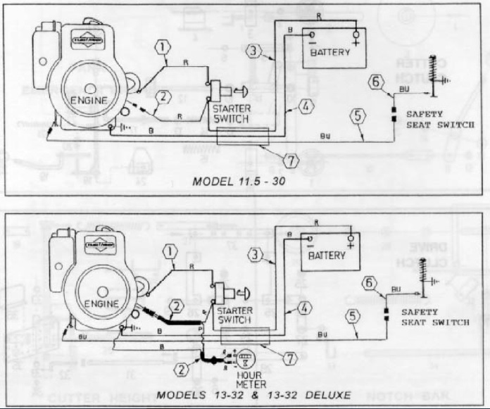

the drawing i have is not really clear.
*Now if i connect the orange wire from ignition directly to DC output, will i charge the battery this way?
*Also i don't understand where they take the positive power for hour meter looks like a red wire from the body (that doesn't make sense.)
That diagram does not make much sense by itself. It seems to be just part of the mower's wiring diagram.
The Briggs engine has a single wire that should be black, and a pair of wires that could be various colours, that connect to the mower itself. The single black wire is the kill wire: its only job is to stop the engine when it is grounded. People sometimes make the mistake of connecting this wire to +12 Volts when the engine is running: don't do it, that will destroy the ignition module.
The other pair of wires are the alternator output. They are connected together at the alternator, but one of them has a diode in it somewhere along its length - usually near the output connector that connects to the mower's wiring harness. The wire with the diode supplies DC, the one without the diode supplies AC.
If your engine has an electric starter, there will be a heavy wire from the starter motor. Most likely the mower's wiring will have a solenoid to operate the starter, but this is not a part of the engine.

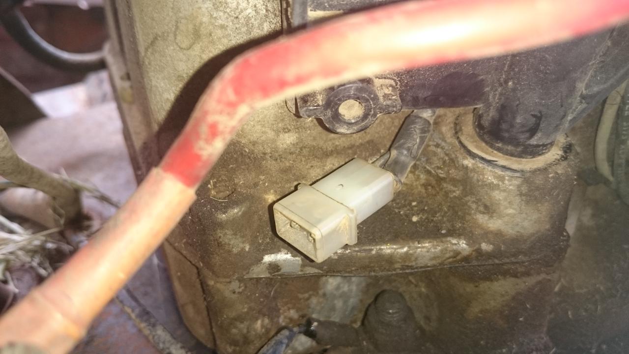

Joined: Sep 2014
Posts: 47
[quote=Iceman][quote=Gadge][quote=Iceman]
In this picture could you please tell me where the orange wire is connected.
I believe that the wire with red terminal and diode goes to the key switch and the other with black sleeve should go to 12v+ pin on hour meter.
Can somebody confirm this is the correct way to do it.
I definitely have a diode connected on the red output wire (DC output) and nothing on black output Wire (AC output)
thank you all for your precious information.
jerome

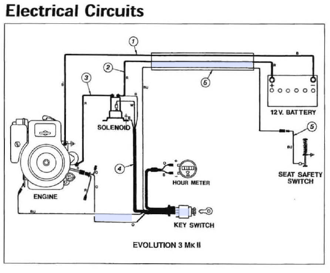

Here is the wiring diagram for a Greenfield Evo 3 Mk 2:
As you can see, it is not exactly wired up like a 787, it is pretty rudimentary stuff.
Here are some Evo 3 models, including one with an hour meter:
Can you match one of these diagrams to your mower?
Joined: Sep 2014
Posts: 47
Thanks grumpy.
no nothing like this. But my mower is Evolution 2000 MKII with 15.5HP B&S.(originally B&S 16HP)
here is my configuration. just with harness 5 and 6 messed up by previous owner.
I successfully connect DC output directly to Key switch so now its charging at least and also I connected the Hour meter to key switch to.
So the clock tick now as soon as i turn ignition on. i don't really worry so much as i don't leave contact on if I'm not mowing. i may Add a Diode later on so the hour meter will only tick if engine is on.
Cheers.
I think you were very fortunate that the previous tenant did so little damage to the wiring.
Joined: Sep 2014
Posts: 47
yes i know especially when everything else on this mower is assembly up side down... this one was an easy fix. but only because of this forum.
thanks again guys.
jerome.
