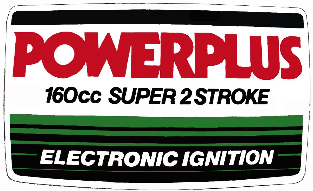

Thanks Blumbly, I think using that and the previous pic I can make one up. Seems to be
POWERPLUS
160cc SUPER 2 STROKE
ELECTRONIC IGNITION
I have already re made the "SELF PROPELLED" Sticker - came out well. SO I can rob the colours from that.
I will post all of the decals when finished.

Her ya go Duke.
Have one in pretty good nick to do up one day, not self propelled though unfortunately. Looking for one.
Posts: 16
Andy
Oh Bushie you'r a Champion!
They will be easy to use for rehabilitation in Photoshop.
I think I have the lot now.
Will post em all soon!

Here is a pic of my remastered decal for the Power Plus.
Wadda ya think?
Have to work out how to get it laser printed and then waterproofed? Any ideas on that?
