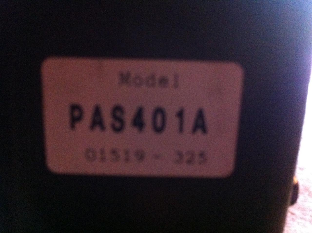

Posts: 445
knuckes grazed, I was a bit lazy on the last post. I actually do take photos of a lot of things I fix and I have included one below. This is the order the roll pin and springs came out.
Been so busy fixing other mowers, havent gotten back to this one yet.
Look forward to any comments. Tonight I will check the links you provided so thanks for that.Note the roll pin in the photo is slightly damaged. The top washer seemed like normal washer. I am assuming in this case the friction washer might be warn causing the pawls not to throw out.

Thanks for the tips. I searched the model and couldnt find the starter via Parts Tree but I found a very similar one which confirms the position of the second washer similar to the advice provided by mark.
Can anybody confirm if the washer that goes under the retainer is a special type. Gagde I think you mentioned it was a friction washer. I just want to make sure I havent got things mixed up. I have a feeling the friction washer is so warn the starter wont engage.

Jaffa, what's the engine model number?
As mark's diagram shows, the wide end of the brake spring should bear directly against the retainer [aka dog plate].
Plastic/nylon washers belong in two places. That is, between the retainer plate and pulley, and sometimes between the pulley and housing as well.
Definitely not against either end of the brake spring. That should have metal against both ends.
As its name implies, that's there to provide drag on the retainer, so that it spins slower than the pulley, when the cord is pulled. The lugs on the retainer will then push the pawls/dogs outwards, if the retainer is correctly installed.
