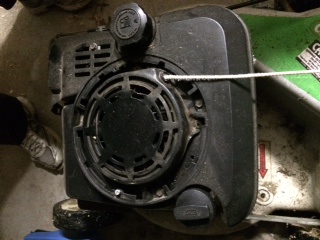

Got a photo, not brilliant but best I could do. The cowling is rivetted on so I'm guessing I have to drill out the rivets in order to get to the pull start mechanism.

A better photo. [Linked Image] Is it a Masport style?

Tiger, Dont drill out the pop rivets. Take the fuel tank off and then remove the cooling shoud. You will be able to access the starter from the inside of the cooling shroud.
If you need help repairing the starter just ask, but I am sure you will be fine.

Thanks Jaffa, I kept thinking about why you'd need to drill out the rivets just to change a starter cord, only just got this one and it's a little different to others I've worked on. Appreciate your help cheers2

Got the starter sorted out but not getting spark, will start anothet thread.
