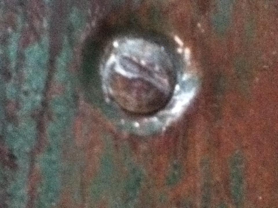

This is one of the screws on the chain case. Any ideas of how to unscrew it since it only bends when I try to unscrew it. [Linked Image]

Impact driver will get her moving....if you dont have one, get someone to smack the back of a conventional flat head screw driver whilst load applied. Good luck !!
