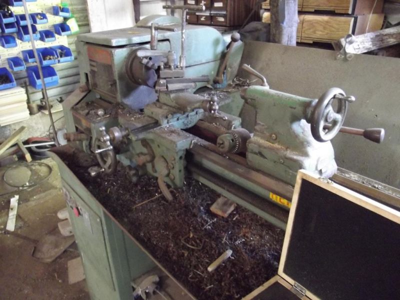

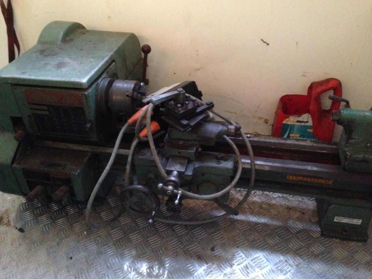

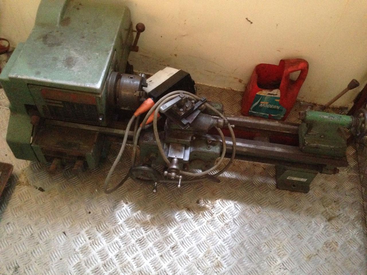

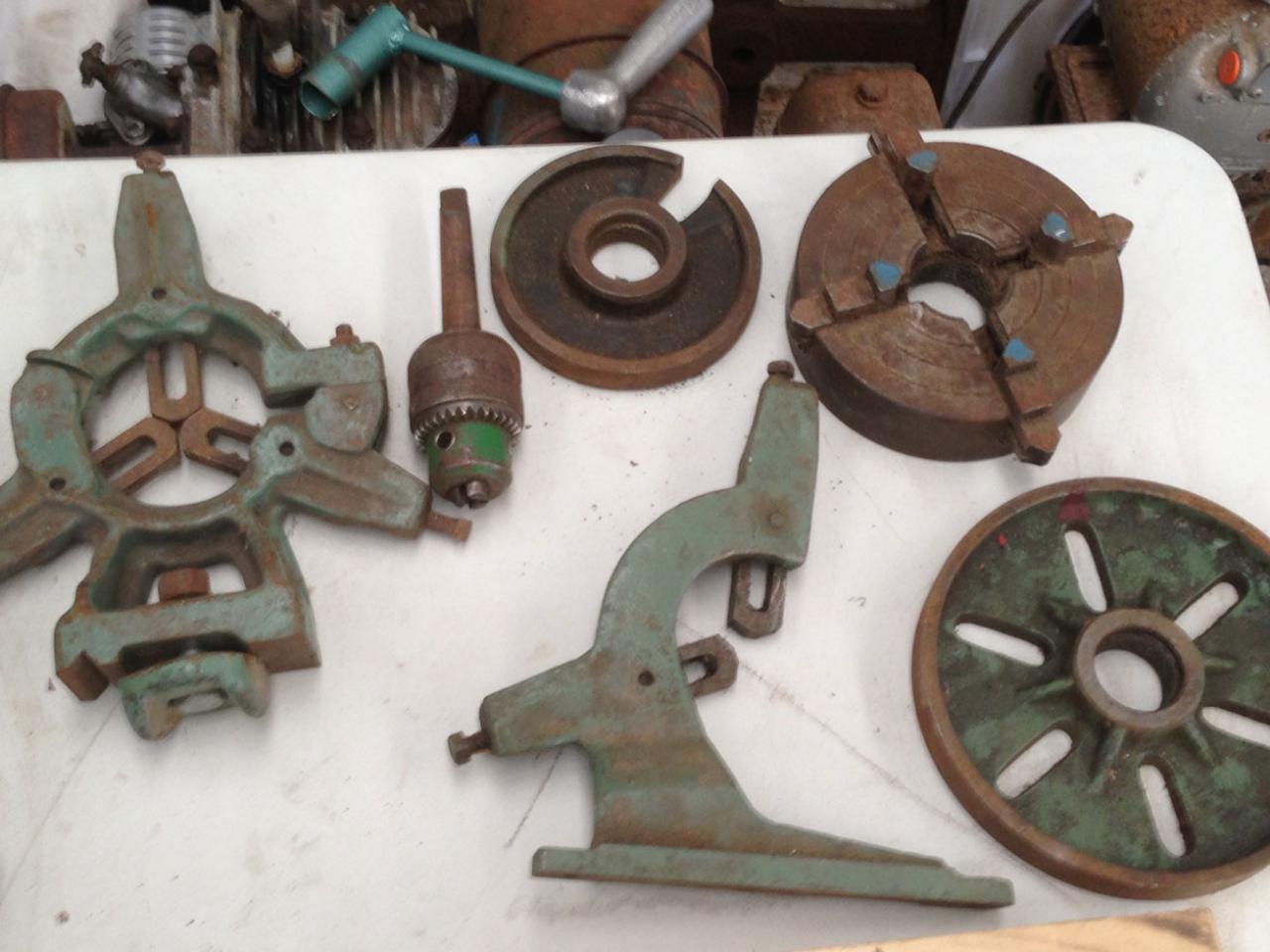

Hi ODK members, I thought I would put up some pics of my latest acquisition seeing how i have got plenty of time (did the back in carrying it to the trailer) lol well not that funny actually, any way I have been looking at quite a few of the chinese machines and doing some reserch on them and it seems quite a lot of them need something doing to them to get satisfactory results (only going by what I have found on the web) so I have not jumped in and bought one, then I seen this on Gumtree for a grand, so did some reserch on these (Hercus 260 ATM) and only found good things about them, they are used extensivly in schools and Tech colledges, Parts are still readily available and are solidly built (bloody heavy), I am a complete novice at metal work lathes and will start reading all I can now, and a couple of my mates are OK with lathes so they will give me a couple of tips as I go along, so any advise from anyone will be great also, I will mainly be doing just smaller stuff like axles and bushes etc to get started. so here it is, the first coulple are from the gumtree add. it came with a full set of tools and a spare 1/2 hp motor that does not seem to have the correct mount on it, and a lot of other lathe bits that I am yet to learn what they are for.

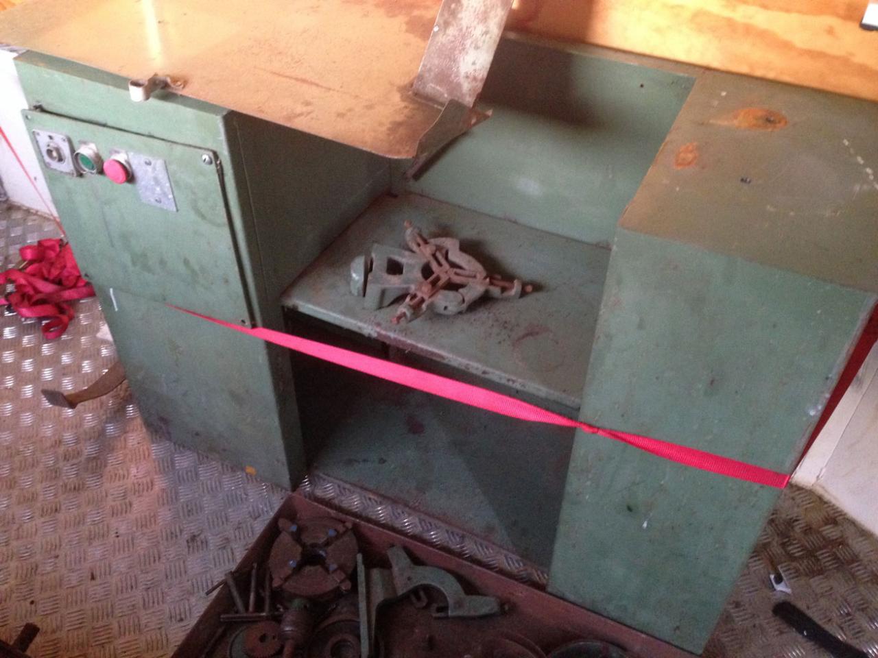

even the cabinet has some weight to it.

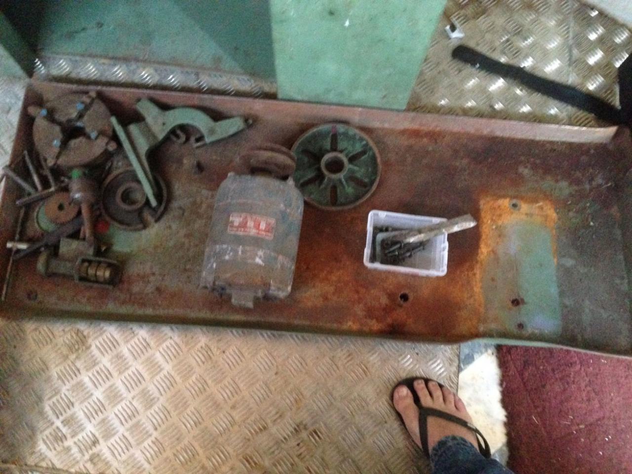

Some of the bits that came with it.

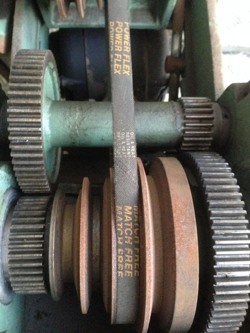

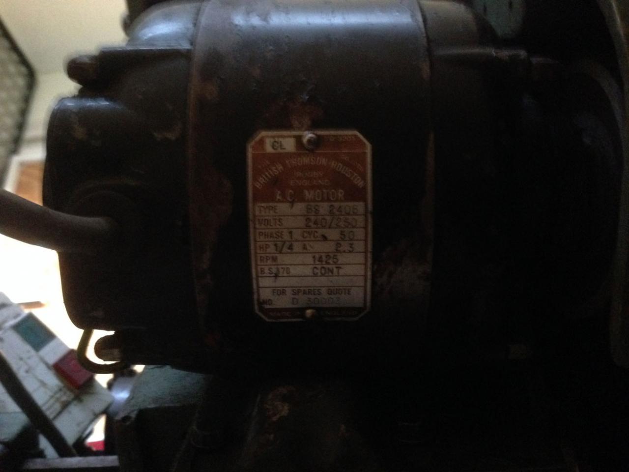

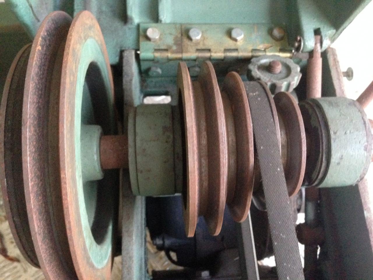

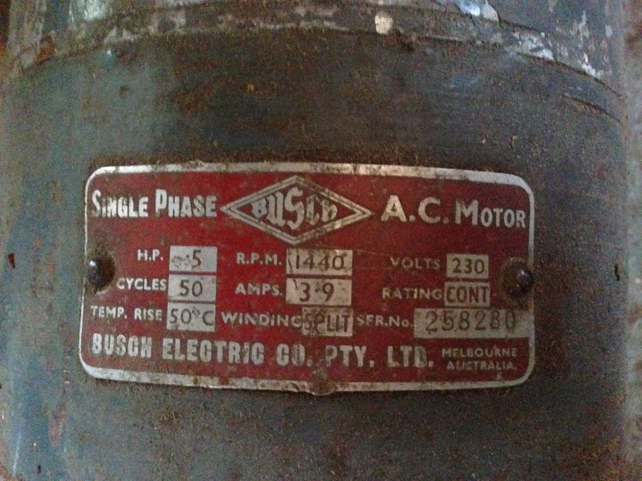

it only has a 1/4 hp motor on it at the moment, I am looking at getting a 3/4 - 1 hp 3 phase motor for it wired to run in Delta and running a VSD/VFD (variable speed/frequency devise) so it can be run on 240v and save changing gears, well that is the long term plan anyway.
this is the plate on the spare motor.
she needs a good clean up and will most likely give it a coat of paint as I am putting it back together, now were can I fit this in the shed lol
Looks like you got a good score there, jonesy.
It's one of the later Hercus models, with the quick change leadscrew gearbox and power crossfeed. Sometimes these have been caned a bit if they have been in school service, but they usually only require a bit of attention to the main spindle bearings and a cleanup. As you say, a solid and well-built machine.
Where you did really well is in getting 'all the fruit' in the accessories. I spy fixed and travelling steady rests, threading dial, and both drive dog and turning face plates, as well as the 4-jaw independent and tailstock chucks, among those bits!

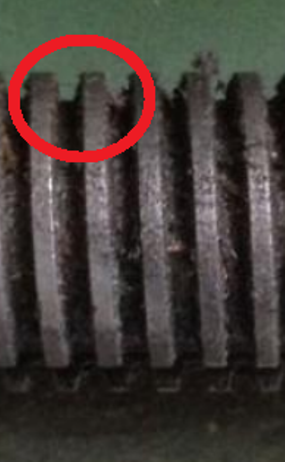

You might inspect the first 6" or so at the left (headstock) end of the leadscrew. That is the part that gets most of the wear, and if it hasn't been kept clean and lubricated each time it is used, it may show damage. Just compare it with further down the screw, to see if it looks different.

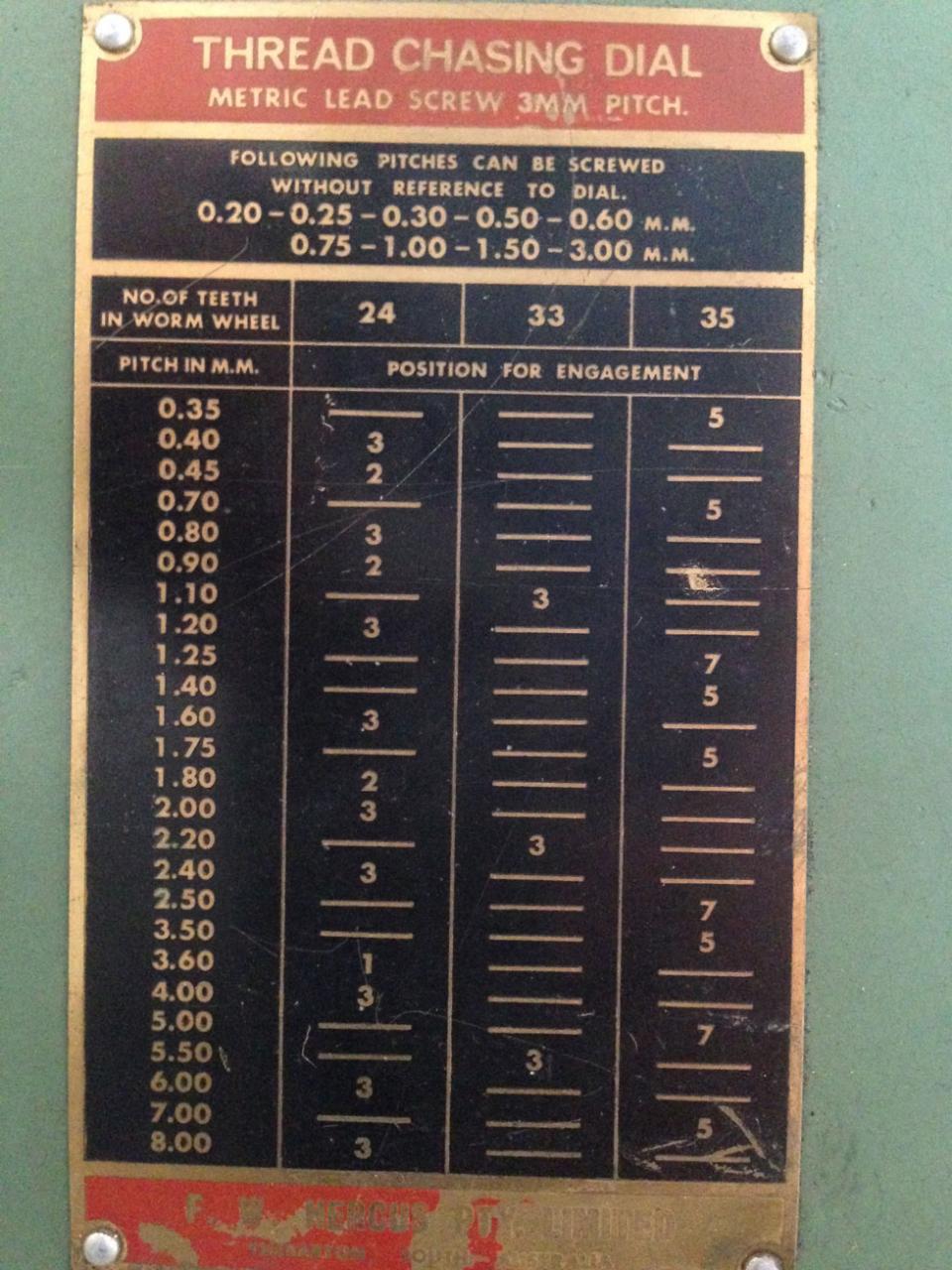

If I'm reading the leads and feeds plate correctly, it can't cut 13 threads per inch. That happens to be half-inch UNC, so it is inconvenient if I'm right.

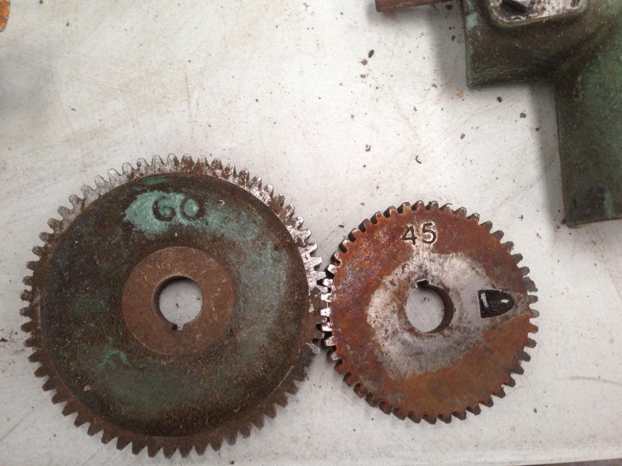

Yep, the guys who say that you need to change some gears to cut Imperial threads are correct, as the leadscrew is 3.0mm pitch. Metric leadscrew = designed to cut metric threads, as a rule.
Like this set, to cover the full range; http://australianmetalworkinghobbyi...roduct&path=39_44&product_id=176
That gives you the actual tooth count of these gears, so see if you got any of them in the bits box.
Edit: There are some great downloads on the basics of metal lathe use [and mucho other useful/interesting metalworking stuff] at http://www.metalwebnews.com/mr.html
I'd suggest 'How to Run a Southbend Lathe' and 'Text Book of Turning' for anyone starting out. The latter describes the use of those extra bits, like the steadies etc. very well.
Most of the older lathes had change-gears as well as the quick-change gearbox. An inch leadscrew was very common on metric lathes - to cut metric threads you just had to include a 127 tooth gear in the change-gears (an inch is 25.4 mm, and 127 is half of 254). Those lathes came with a stack of about 8 or 10 change-gears, and you assembled a gear train to cut the thread you wanted. Typically there was a leads and feeds data plate attached to the lathe - here's mine:
However change-gears eventually became uncommon - they made lathes very versatile, but set-up took longer.

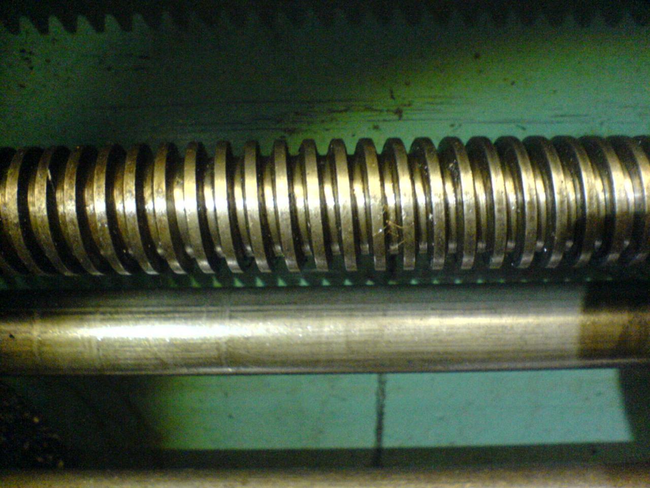

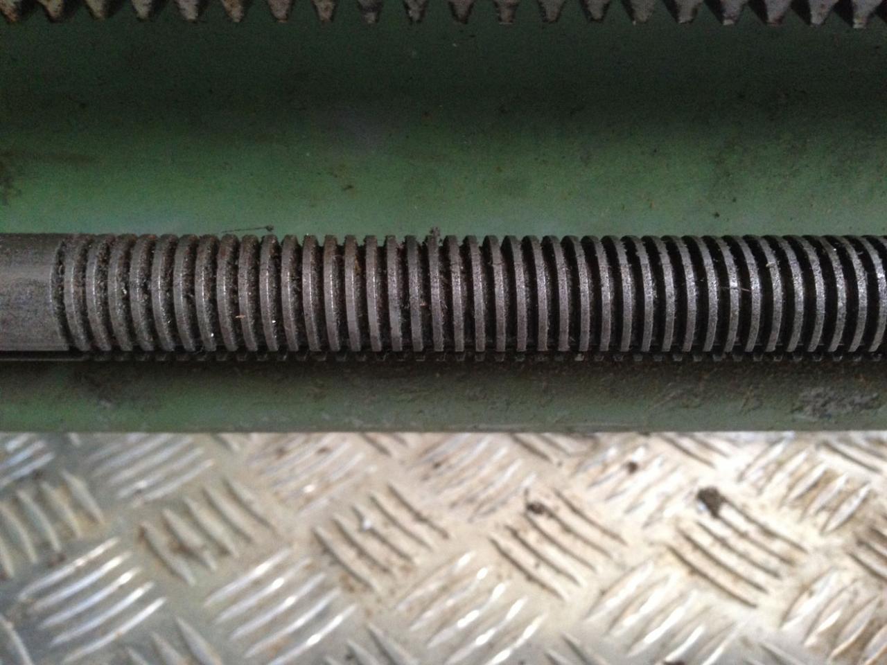

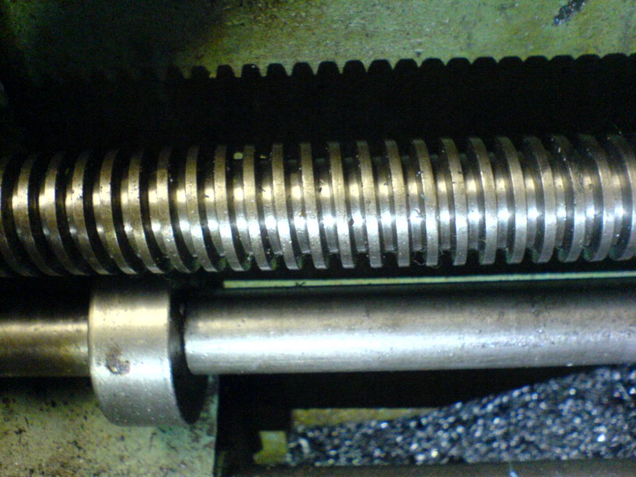

Thanks again guys, I have managed to get a better look at things and have checked the things you have mentioned and apart from needing a good clean up, there does not seem to be much wear on bits at all, so some pics.
Head stock end of leadscrew, then the middle and tail stock end.

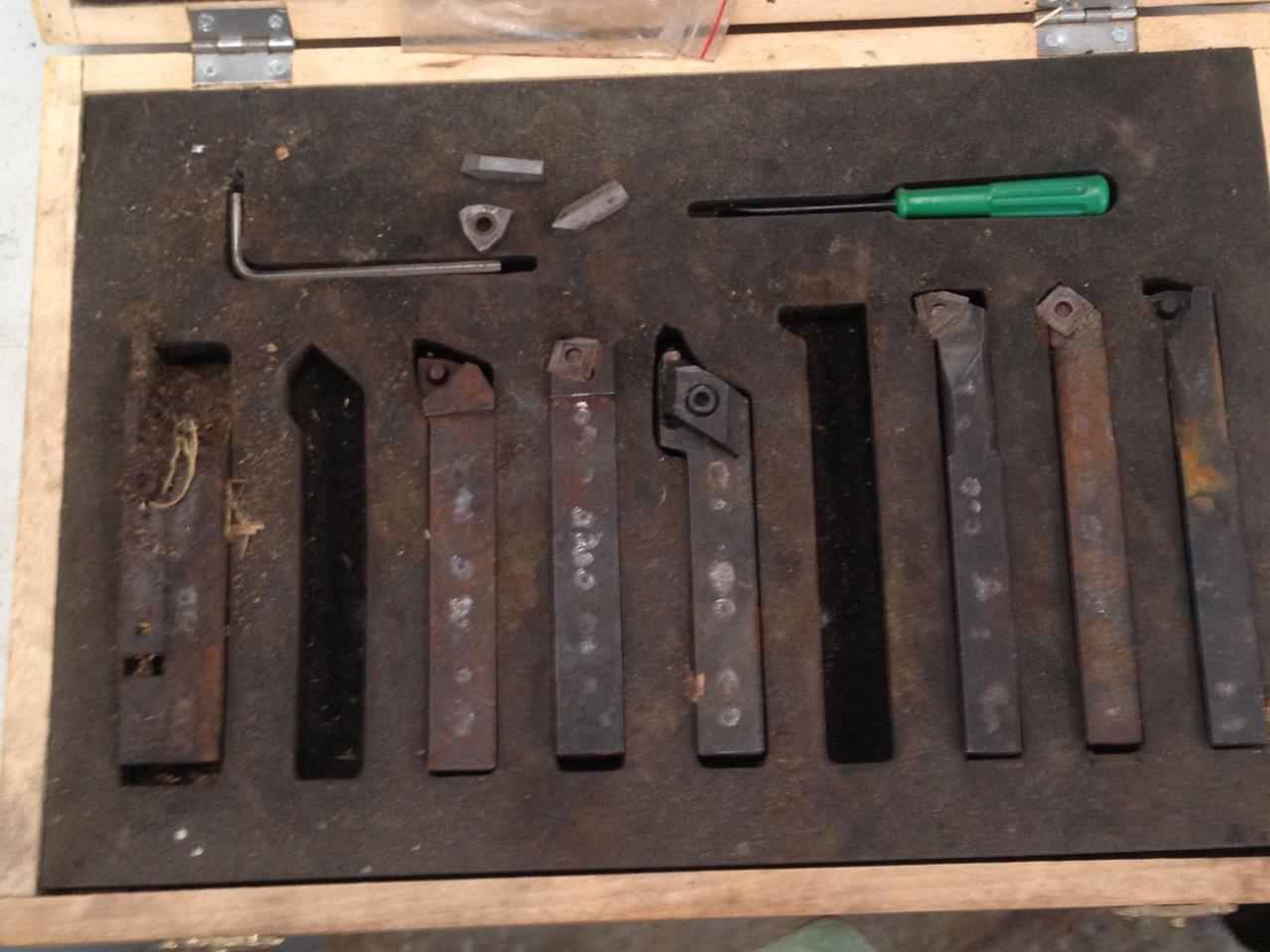

better pics of the associated bits

Your leadscrew will need to be cleaner to check its condition. This is the check I suggest you do. First, this is the bit I'm talking about:
Look closely at the sides of the thread-form, in the red circle, looking for signs of wear. Compare it with the far end of the leadscrew, which will not have been used and will not be worn at all.
For comparison, here is mine. Headstock end, which will have the most wear:
This is the right hand end, which will not have been used at all:
My lathe is 80 years old, and spent perhaps the first 5 of those years in a toolroom, so it has had some use. I do not see signs of wear or spalling on the sides of the thread, but I'm sure there will be a reasonable amount of wear, which could be assessed by filing up a piece of aluminium sheet to be a tight fit in the thread at the unused end, then it could be pushed into the used end, and its sideways free play assessed.

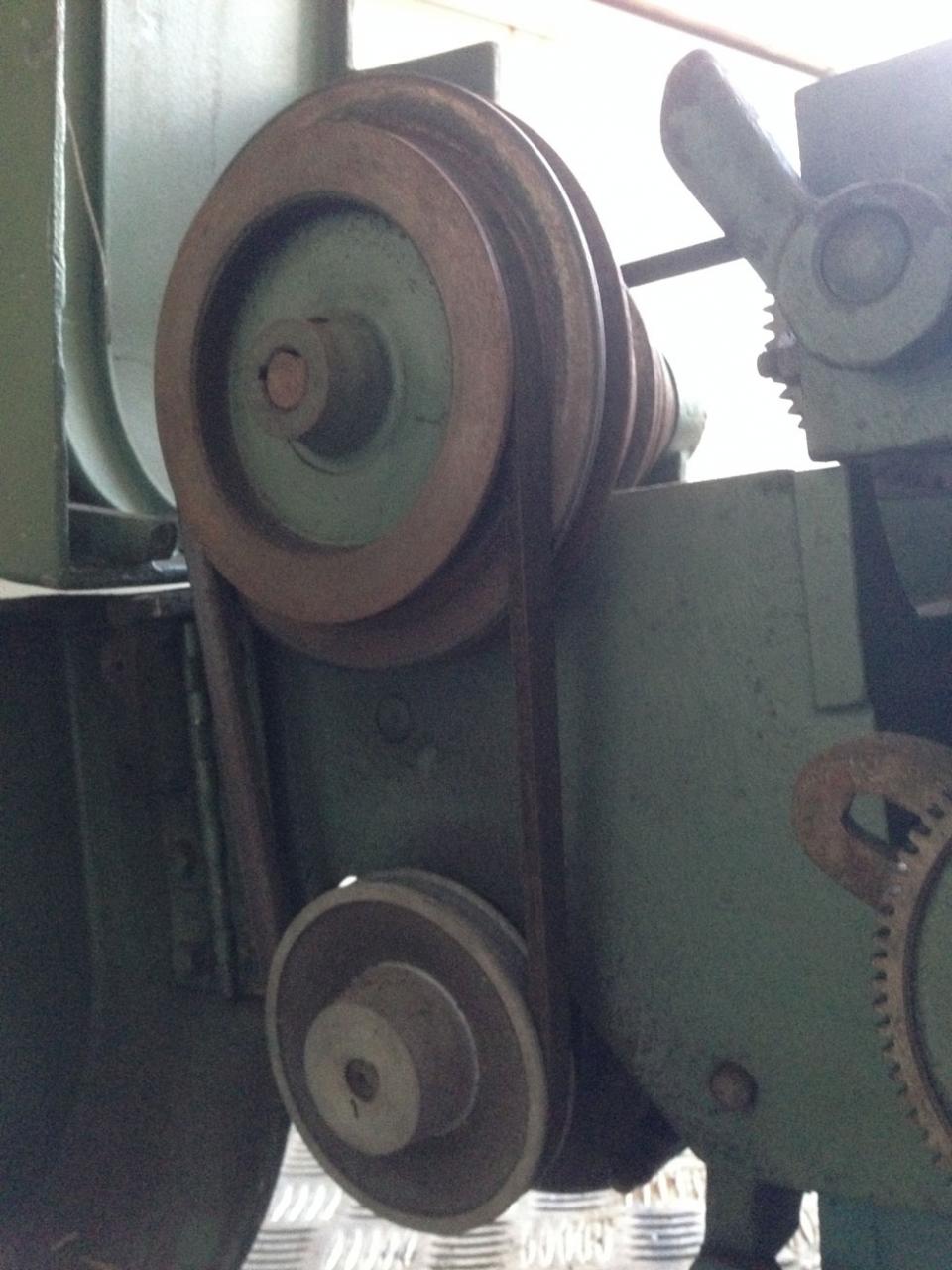

On a different subject, the gear on the end of the spindle, which drives the gear train to the feed and leadscrew, has been running dry for a very long time by the look of it, and has some wear. This is not important, but it shows what happens if you neglect machinery.

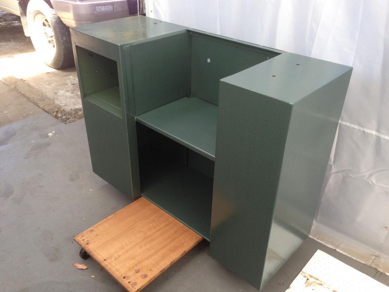

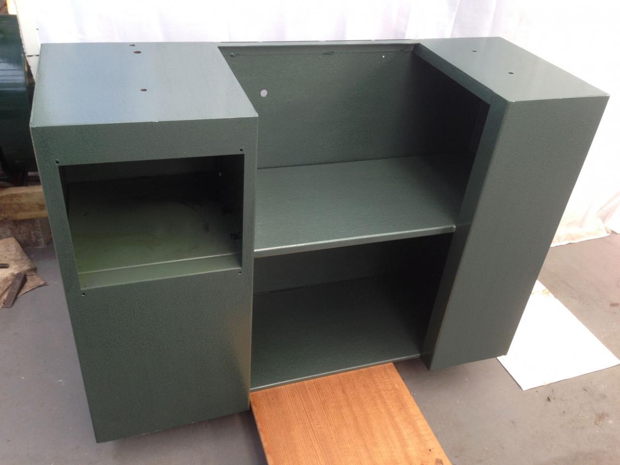

I had my young bloke get some of the bits out of the trailer and have started doing the clean up of the cabinet so that the paint will be hard by the time I whant to mount the lathe on it, can anyone guess the colour grin

The caps with the flip-up lids are actually oil reservoirs. Often they have a lamp wick in them, which soaks up the oil from the reservoir and allows it to ooze into an output channel by capilliary action. I have a bunch of them on my ancient power hacksaw, at least one missing its lid, and most of them with no wick so they are just reservoirs with no slow-feed function. Good luck getting a lid for yours - but you might get some complete oilers from a junk stall in a flea-market, or on ebay. If you find a bulk supply of them, please post about it - I can't be the only one interested.
If you have any with screw-down tops, they are grease lubricators. Each time you give the top a half-turn tighter, it forces some grease into whatever is being lubricated. They work very well, but are messy to refill.
