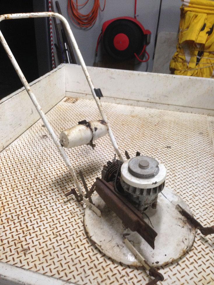

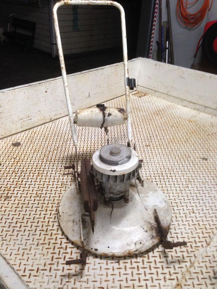

Well I thought I better Start another thread as "my new victa 18's" is getting a bit messy and off track, I have just recently got my first Romoto's (frames any way) and thought I would put up some pics and any progress I have made with them.
First up is a fairly good Model 1-2 base and handles with tank (wrong engine) but is a start.

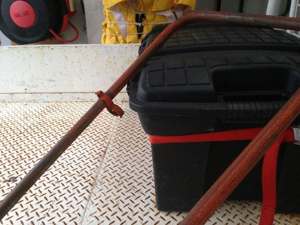

Next is a Model 3 Partially.

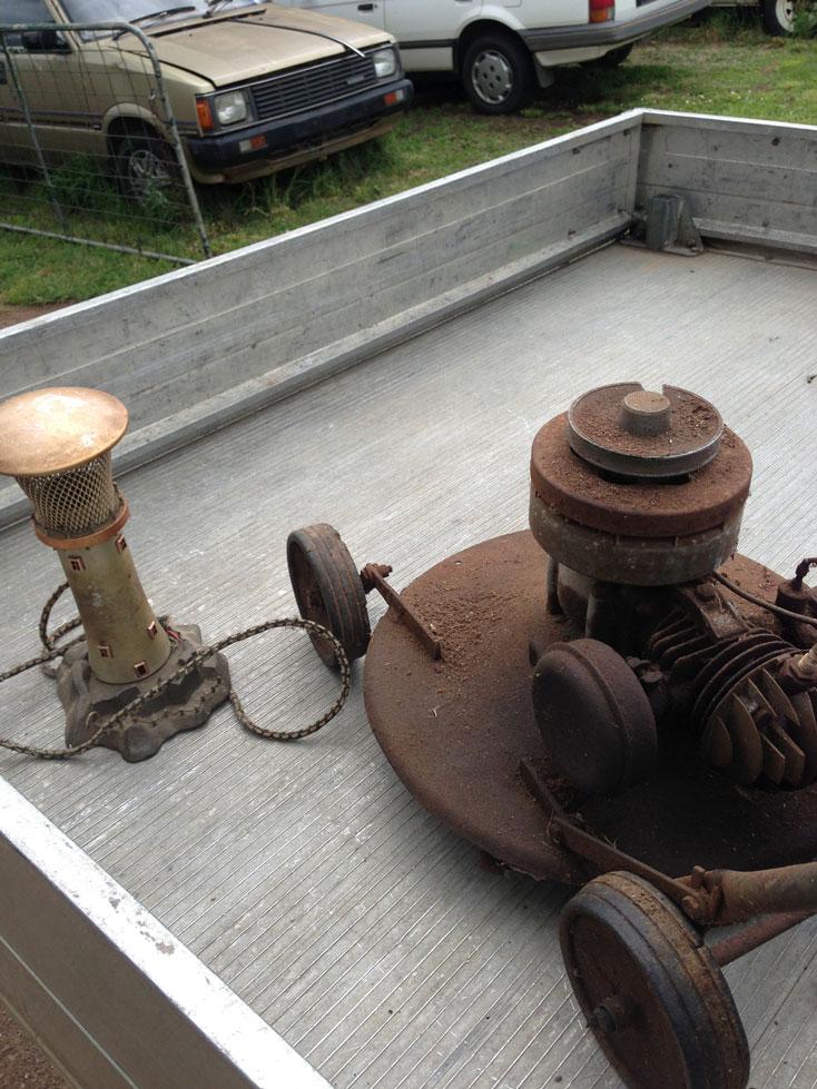

This one is going to be the first one done up as it is the best condition, Model 1-2 that will be fitted with a spare/seperate engine I bought,
engine #94828 over 1.
It also came with a good tank that I have started to restore but will be changing the colour from Brunswick green as pictured to a deep Brunswick green.
Also started cleaning up my Model 12 badge to go on it.

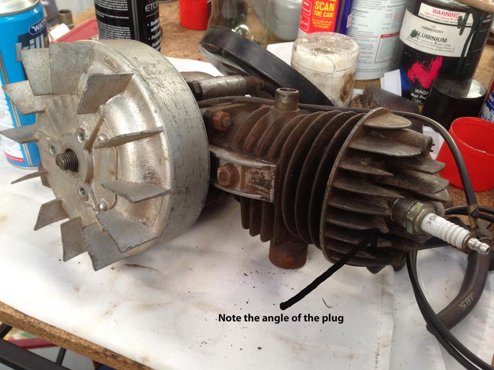

the engine that will be going on it.
Has the wrong head but have got others to fit when I get to doing it up, I have also started on painting all the axel mount parts etc. well thats all for now

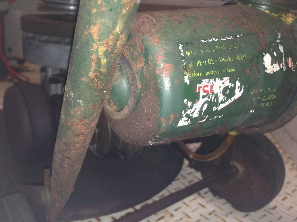

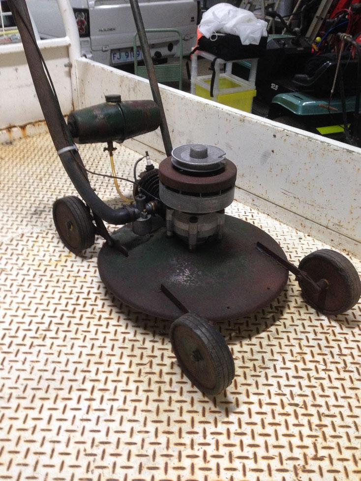

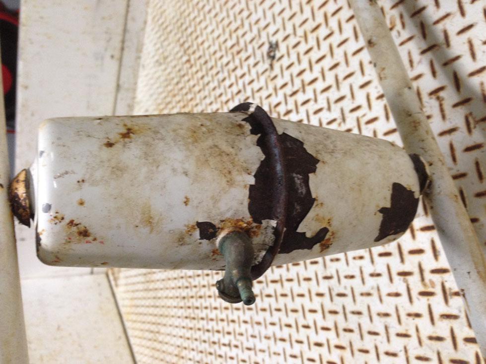

Well you know when what you expect even turns out better than what you thought it would? well it happened to me when I picked up my early Automatic and now with this Romoto 2, everything is there, and in good condition and works, I am told it does not have spark but I will check it out tomorrow it does have real good compression, seeing how I've just driven 4 1/2hours round trip to get this I cant be bothered ATM, check out the pics, I think it is in too good original condition to fully restore so I think I will just clean up and see what happens.
the top hat pully and flywheel cover are near perfect.
the sad faced choke even still has the mesh in it, and the clamp does not even seem to have ever been bent out of shape.
the fuel tank is spotless inside, the tap seems good and the cap still has the cork under.

The fuel tank still has the original rubber mounts on each end.

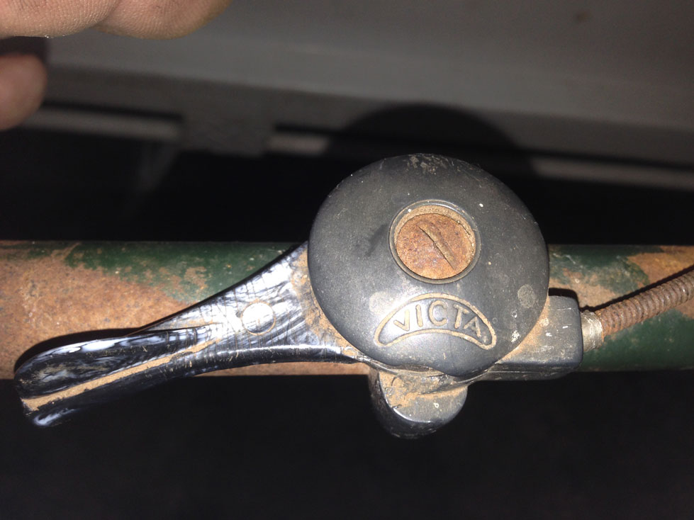

Throttle in good condition with original cable.

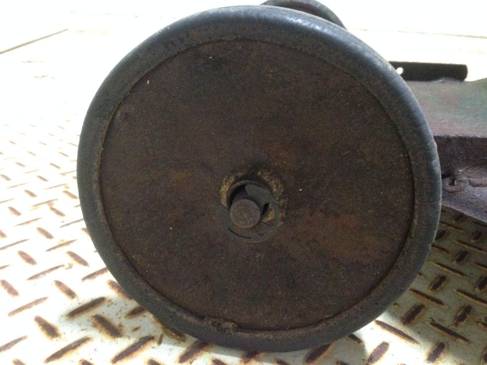

The wheels and axles are good with next to no rust.
well that should give you all a fair idea of the condition of it now to see if I can put up a poll on weather to keep it as original or restore??? see how I go?

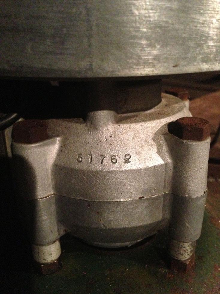

My model 2, which I've almost finished restoring, is number 51015, so just a few hundred off of yours and was probably made in the same week lol! I'll be using your example as a reference to finish mine off, for sure. Mine was a wreck when I got it, and I spent a heap on it getting it up to scratch. I had the base blasted - a bunch of cracks welded and the whole deck leveled out as it had been buckled at some point. I was missing the badge, snorkle, carby and throttle and it also had a model one barrel on it, which I changed to the correct model 2 type. The wheels were full of holes, and I must a spent a week alone just getting those bogged up and painted. The rubber was all good, including the tank rubbers, which are rare as anything. The only thing I'm short now is a smiley face choke (infact I need three of those!)and the stickers, which Rustic Spares do a nice job of.

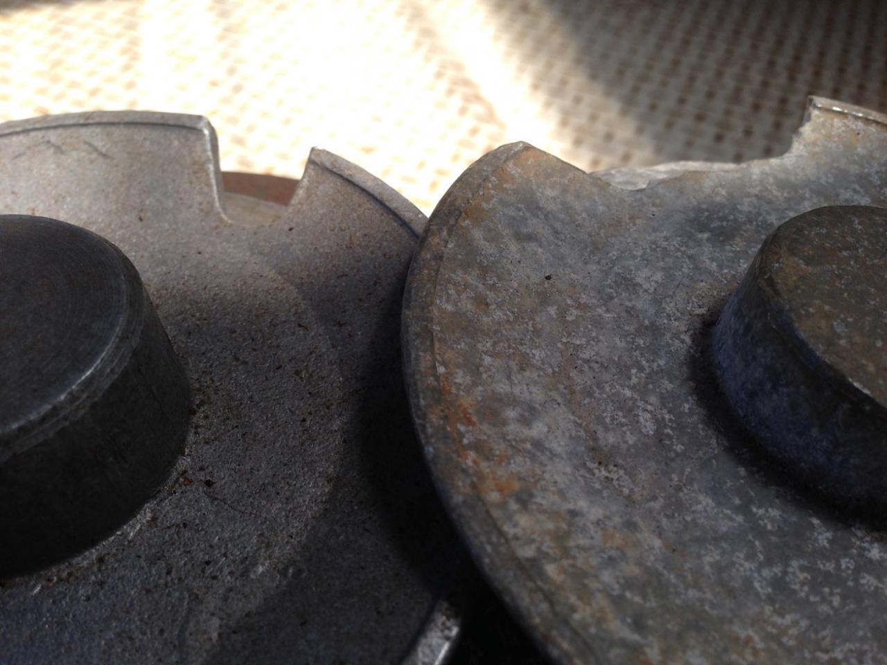

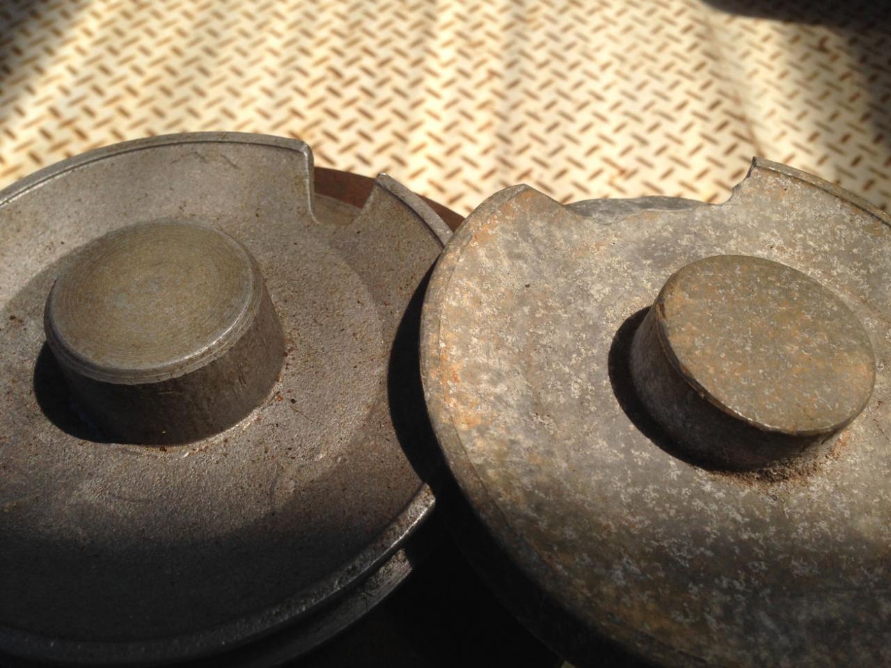

Been hiding Unki? good to hear from you, I thought the pully was correct as this is a quote from Blue from another thread
"Top hat (unsure as I cant see the Images,if the chamfer on the top edge is barely visible its a model 1,if its prominent,then model 2."
So I figured the one on the left was the Model 2 and the right (broken, bugger) Model 1.
I only know what I have read and not questioning you as you have had a lot more to do with these than me,but so has Blue. so confused

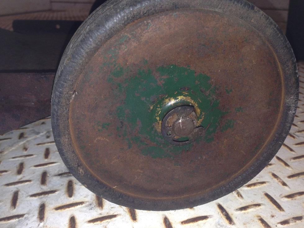

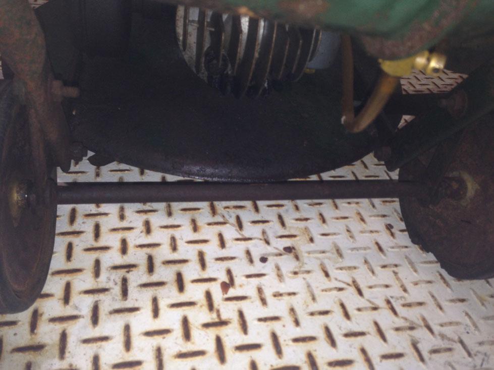

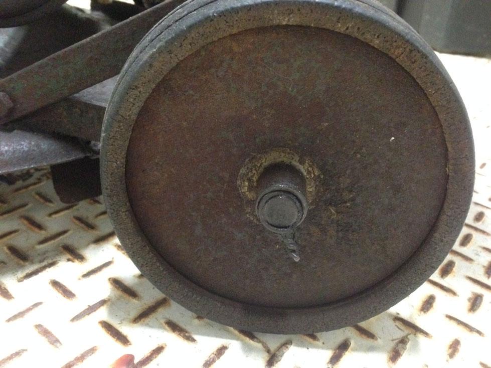

Also, regarding your question about the difference between model 1 and model 2 rotomo bases, the easiest way to spot the difference is to measure the gap between the two front wheel struts. model 1 bases have a inner gap of 290mm between the front wheel struts, whilst the model 2 gap is narrower at 280mm.
The early model 1 axles also had wheel retaining split pin holes rather than circlip groves,which is another give away

Ah thanks for that info, that meens I have 3 Model 2 bases now. cheers2

Ahhh true! sorry about that, I had them mixed up. In that case, it looks like you've got a 100% correct mower - lucky bugger! Any sign of paint on the back axle?
Unkiiieee! Lols.
Super nice score jonesy! This example is what I always aim for in my collection, an unrestored original. As unkie says this id keep as is. Strip clean and rebuild the engine, but keeping its original patina. I use penetrol in restorations as it enhances the original paint and seals the bae metal. I tend to only fully restore wrecks like your first examples (red and white). But thats just me. Unkies spot on with measurements for base types I have even seen some model 2/3 bases at 295 300mm. Rear axle for model 1 is also different length and has of course no circlip recess just holes for split pin. Front axles halves are also straight.the model 2 inner is bent s style.
Your left ess pulley is definately a model 2, the right (broken one) is really rough and looks to have less of an edge but its kinda irelavent now frown anyway a beautiful original mid run model 2, they dont come like this often. Now I just gotta find the badge post to put up my green model 1 example.lols. actually when I get time ill post my last original in this thread youll be really surprised when they line up as it is near exact in condition mine is 53, 000 from memory.

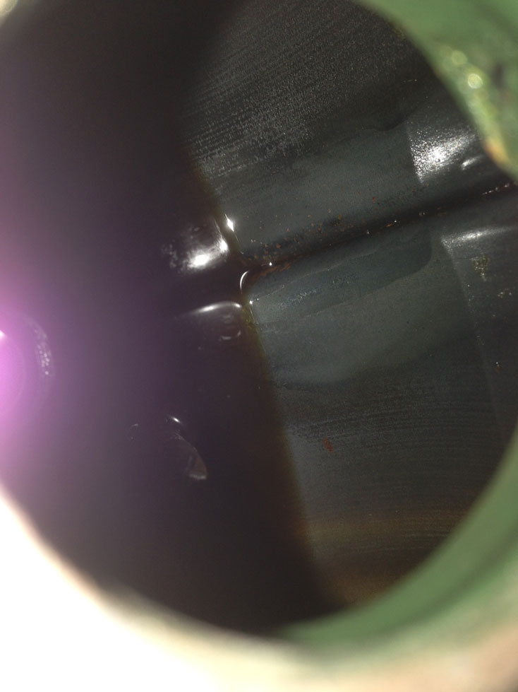

Unki, no paint left on the rear axel, well got the old girl fired up after putting a new coil in it. (question for Blue on that later) cleaned out the carby and found this,
Dont know what happened with that???
someone must have also screwed the screw that guides the slide into the side of the slide as the end was missing (not protruding through the carby body) and the side of the slide groove was sort of squashed at the side, but filed it straight with a small flat file and replaced the screw and float bowl and good as new,
The fuel line was hard and had a split in it so had to put a new piece on, the video was of the first attempt to start it so grin it must have been the old leather starter I used get her going that helped her kick into gear lol

love the video Jonesy! What a great mower you've got there. I reckon it would probably be your best score yet. Regarding the float bowl image, are you refering to notch in the lip of the bowl? I've got two or three that match that exactly and just assumed it was designed as an overflow groove. My circlip carby doesn't have a notch in the bowl, but one ore two later style carbys I have do.
Can't help on the coil question, but maybe the coil size changed a little over the life of of the model 2 - just a guess.
Two things I noticed about your roto - the back wheel/s is on the wrong way around and the top port cover should have a brass dome nut - check the bottom port cover as it might have been put on the bottom one instead. Other than that, you've got a real museum quality piece there!

You know Unkie I thought along the same lines with the groove in the float bowl at first as it looked too neat, it could still possibly be that, but when I got thinking about it before I put it back on was it is lower than the tell tale hole for the tickler and thought it was just another place for crud to get in and fuel to spill out while you are throwing it around in the scrubbery, but if you have the same fish well who knows? yes something changed with the coils or at least the locating pins? yes I noticed the wheel on the wrong way lol I just checked the nut and yes it has a chromed brass nut underneath on the port so thank you for picking that up and I will rectify it when cleaning it down, I dont think I will need to do anything as far as rebuilding the engine as it runs too well to be worn, and when I reasemble after cleaning I will be able to time it better before putting the head back on, it was just a guess of 3mm BTDC by shinning thw torch down the spark plug hole and using a Tallyhoe paper in the points, an old trick from the harley shovel heads and XT/TT yammy 500 days lol a hacksaw blade to set the points gap (18 thou) and a Tallyhoe paper for timing cheers2 If not the best score, definatly the second best (I am a bit partial to my Auto)

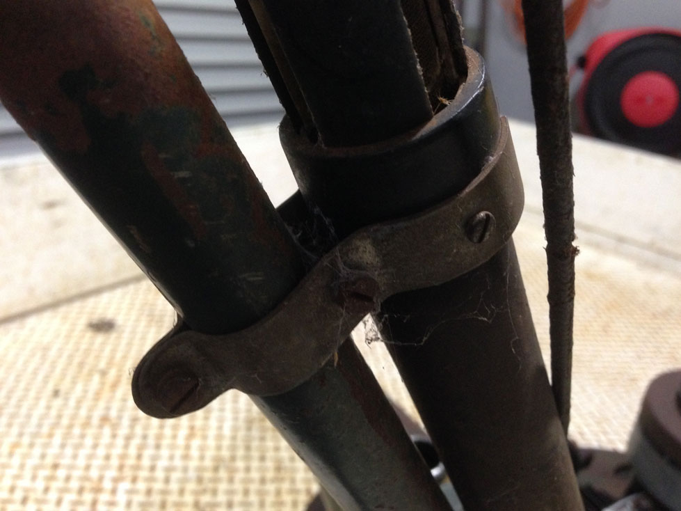

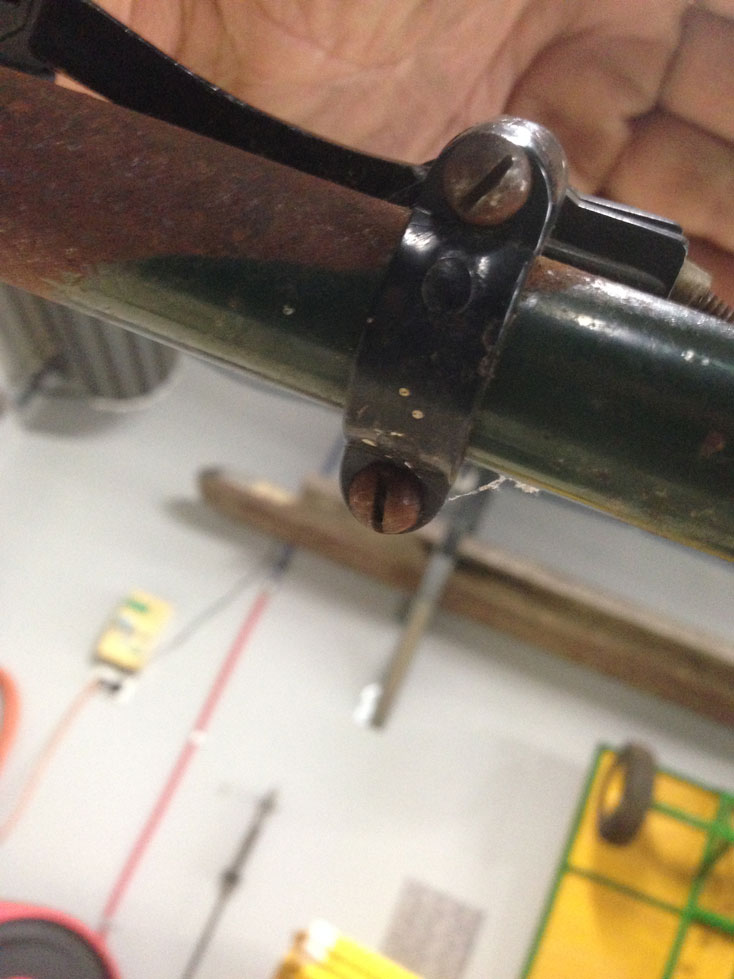

just curious about your use of rivets? Original rotomo fittment for the badge should be a 1/2 inch 3/16 straight slot dome head machine screw and hex nut and std spring washer.
Screw should be
1/2 inch long
3/16
3/8 dome head dia.
Unless of course im wrong....lmao. Anyways i use old weathered rivets sometimes cause i dont have enough old screws this size...

When did Victa start using rivets mine is also riveted on and was told it was wrong should the screws as above. This is not the only mower with rivets, I have seen others. It just seams strange that someone would use rivets in different parts of the country and not replace the screws with screws if one had come out
Ian
As far as Im aware Ian NO victa prior to mid rotomo model 2 used rivets. As ive seen and owned too many original examples with the same screws. After mid rotomo 2 im unsure as ive not researched this. As far as im aware no rivets where used anywhere on any victa well up to sheerline...shops or owners may have replaced them accordinlgy. perhaps someone may know otherwise,but fan mk1 and 2 roto 1 and early roto 2 Definately used screws. the majority of riveted badges ive seen have been on late model roto 2s and 3s and utilities. either way screw or rivet,personally i dont mind either smile.
My M1 rotomo definately has screws, its right in the back of the shed at the moment too hard to get at for pics but they can be just be seen in this

Blue have you got a good pic of the head of one of the original bolts so I will know what to keep my eye out for? thanks every one.
Yup....ill do a pic tomorrow. The style is the same as the throttle control screws just in unc not fine...all the other 3/16 screws on victas are cheese head.
