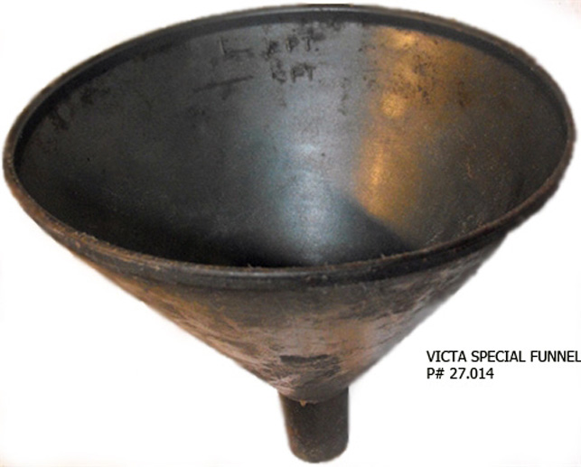

Here is that funnel, in the correct green and with its own part number:
Posts: 539
Love the way it is used to measure the oil for mixing too, also more great investigating Unki.
Joined: Jun 2013
Posts: 170
Cheers mate! Yep that funnel is pretty cool. Pretty rare I'd reckon!

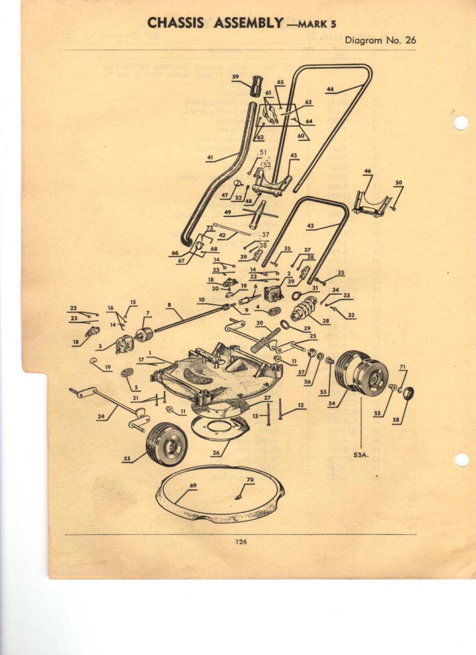

So I was thinking through this whole issue of when the model 4 ended and the model 5 began and also how all this relates to the introduction of the label �Special�. I was preoccupied with the introduction of the �Special� badge, as I considered it the marker for the transition, when I realised the answer had been staring me in the face the whole time.
We know the Model 4 ran on the Mk 4 chassis and the Model 5 ran on the Mk5 chassis, but at no point had I thought to compare the two schematic chassis diagrams side by side. The Victa models were always named after the chassis they were fitted with, so logically, variations in theses chassis define the transition from one model to the next.
Much of the discussion had focused primarily on the skirt holes which appear on the edge of the die cast base. Four holes equal a Model 4 chassis and two holes equals a Model 5, or so I thought. A side by side comparison of the chassis schematics tell a different story. The diecast base alone does not define the chassis, but rather it�s the components those bases were fitted with that determines the model.
This early schematic of the Mk5 chassis (see below), is significant for four quite distinct reasons. First and foremost, the die cast base plate is identical to that of the Mk 4 chassis, ie four holes rather than two. Secondly, the only difference between the two chassis is the absence of a name badge on the handle bars, which is incidentally illustrated with a part number in the Mk4 chassis schematic. Finally of note, the absence of Automatic style side skirts (which is substituted with the round toe ring), and the edger groove cover, for which no cover is present. That�s it, no other differences. For all intents and purposes, the original Mk 5 chassis was simply a stripped down version of the Mk4 chassis with the substitution of a toe ring.
What to make of all this? I think it can be concluded that the �Special� was introduced on an early Mk 5 chassis, which, according to the schematics, originally had the same diecast base as the Mk4. It was released without a badge and with a toe ring. We know the �Special� was released on or before March 9, 1958 (see post 48987), and that it appears the plastic name badge was not introduced until late November 58� (see post 53190). This all supports the case for the Model 5 Special having been released unbadged, with a toering and without an edger slot cover, and most importantly, all riding on a four holed, Mk4 style diecast base.
In short, all those �stripped down Model 4�s� with serial numbers after 128,000 we've been seeing are actually Model 5 Specials without a badge.
Further confirmation of all this would be to check if later copies of the Mk5 chassis and Mk5a engine schematics for amendments, so if any of you fellas have one please post a scan here!

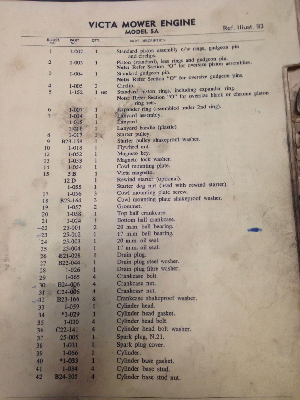

I only have the same as you have above as far as the schematics go, I do have the same erea for the 5A engine,
All very interesting Unki and I would also like to know of the different part # for the series 1,2&3 and if they even change, another interesting thing is the Romoto 1 & 2, Automatic and your 3rd scan all list the same part# for the plug spanner, #8-200 but in your second scan it shows the bent bar spanner for the toe ring as previously discussed, still a lot of grey areas will need to be cross referenced before we can put this one to bed I feel.

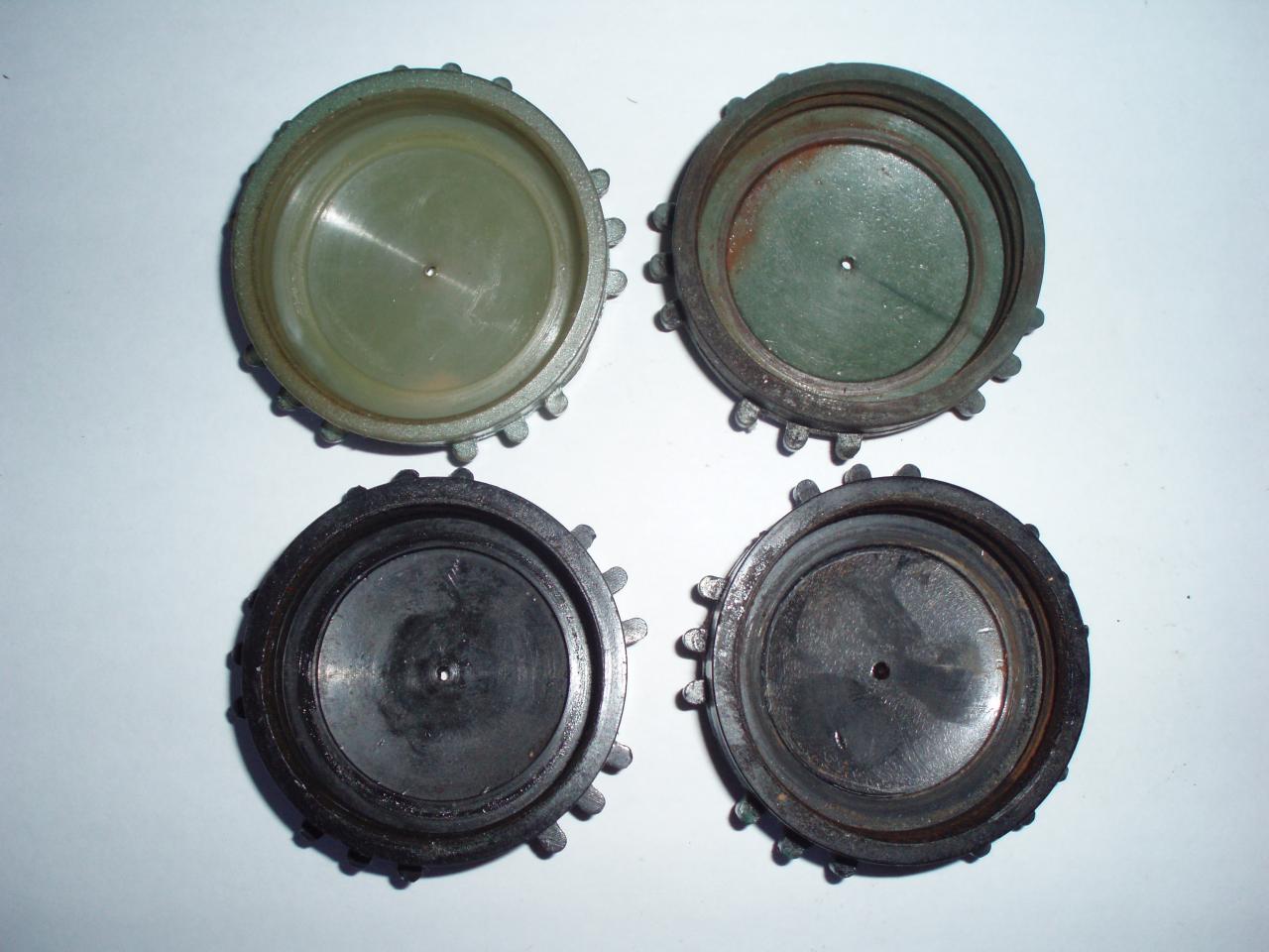

before we move to far away from the Fuel caps I have some images that I will put up because I have two that are green plasic but look to me to have original paint on them, firstly I thought I will show everyone what the clear/white cap looks like without paint.
this is it when painted and looking on the inside, as all can tell matches perfectly with the image Unki put up.
next are the only other green caps I have and they are all green plastic, one plain and two painted, the one on the left came off my outboard engine #131049, the one in the centre off Model 4 engine #125166 and the one on the right was not on a mower.
Joined: Jun 2013
Posts: 170
Cool stuff, so we can safely say that the fuel caps ran the clear type up to at least #117,000 and introduced the painted green plastic version some time before #125,000. I suspect the unpainted green cap arrived around the demise of the Automatic, so #130,000 or so, and ran all the way up to the introduction of the M5S1 base - wait and see I guess.
