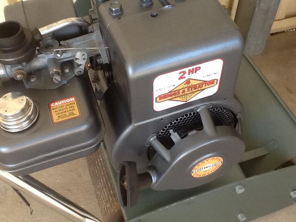

So it's begun. I won't be stripping the mower fully as I decided the paint on the frame is in very good nik. I will be painting the motor. How good did the handles come up with a polish! That's original chrome!!!
The guy before me painted the carb and fuel tank. I have stripped both back to bare metal. The carb will stay that way but how was the original fuel tank finished?

Can anyone tell me how the original fuel tank was finished? Was it painted the same as the engine?
Mike
Hi Mike,,
Yes mate, the tank was painted the same colour as the engine... wink

Front roller cleaned up and fuel tank painted

Once again Mike, great work! You're really hooking into it. I quite like the colour you've chosen for the engine, it looks like a gunmetal grey on my screen? I'm enjoying looking through your pictures and watching your progress, many thanks for posting them smile

It's a motormate(auto pro) engine enamel in cast iron colour
I like it too as it won't show up the oil as bad as silver
When I resto mine I think ill use the same

Does anyone know where the grey sticker RE oil level goes?
I have the one on the fuel tank To remind you to check the oil but not sure where the grey one goes

Do you mean the one that has 'model type code' written vertically along the left hand side and 'See your instruction book' in the middle? It goes on the side of the cowl, next to the 'model type code' stamping.
