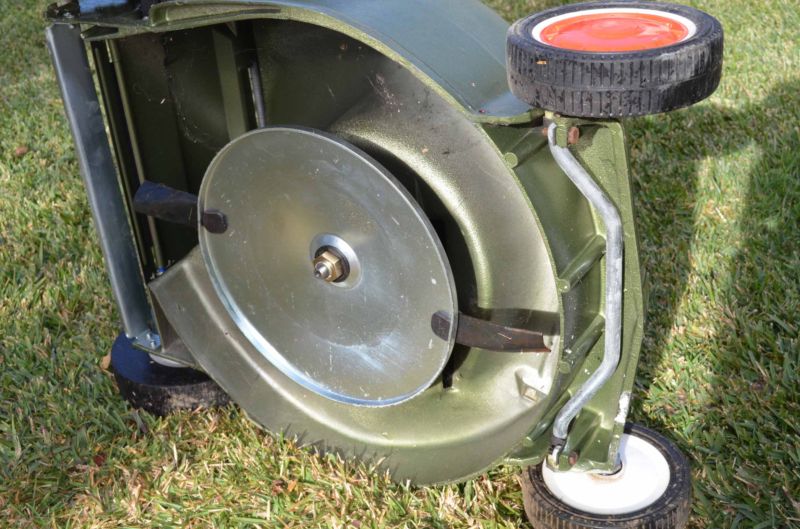

The nos vc160 seems to have had a galvenised/bare steel disc
Sorry, yes, I mixed it up with the black discs Blumbly originally had. Bare steel, top and bottom, flat surface (no vortexing fins aside from the blades) yet i have seen this set up far less than the cream paint set up, it's not impossible to assume the unpainted disk an abnormality, test, machine failure or emergency stock part based on what i have observed.
Alternatively, maybe the bare disc was originall, but overly prone to rust at the blade holes in a short time, which would be potentially very dangerous, I'll see if this era is covered in my Victa recalls listing.
Here is another NOS victa, (this time an msaa craftsman) indeed some had painted discs and other didnt, either way having some kingd of paint on a disc looks better than rust. The only trace that would be on an original blade plate now would by chance be under whee the blade boss sits, and in reality, thats a chance lol ...

While rebuilding my VC160 Mk1 I was looking out for parts. I found new old stock blade plates and they are green. One had blades fitted and showed marks from being fitted but blades were near new. I fitted it up and found it was bent, maybe the mower was dropped when new. Fitted blades up to one of the others and it was perfect.

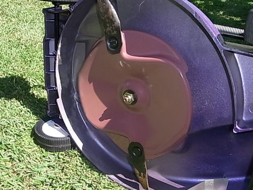

Yep, that was one reason; another 'selling point'...
Introduced for the 1974 season; https://www.outdoorking-forum.com.au/forum/u...atalogue-victa-1974-range.html#Post62200
Victa didn't get it quite right first time around though; the blade holder pictured in that brochure was recalled, and is fairly rare now.
That 'wave' design had a tendency to bend the crankshaft end, if it copped an object/obstacle strike.
While this problem was well known with Masport 4-strokes [which used a bar blade], it was new to Victa.
Consequently, that holder design was superseded by the 'swirl' design.
