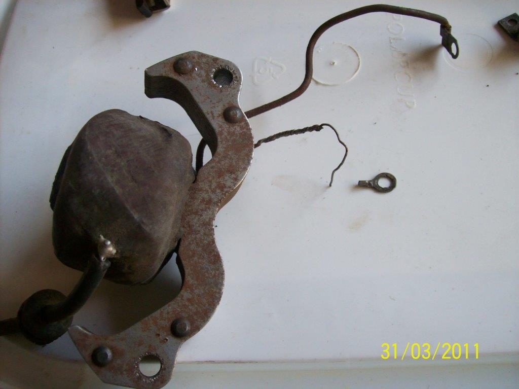

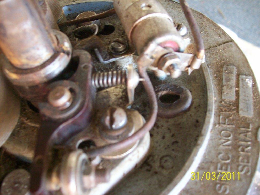

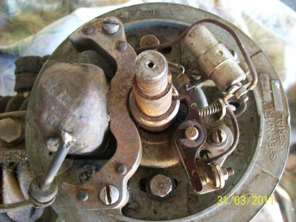

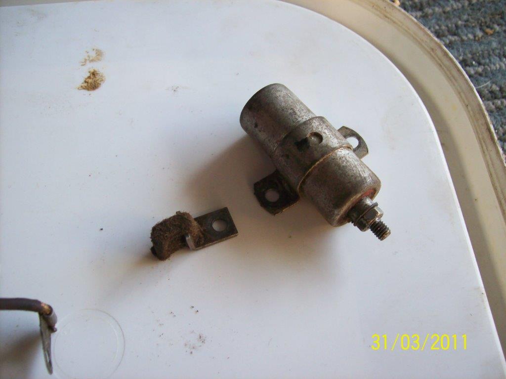

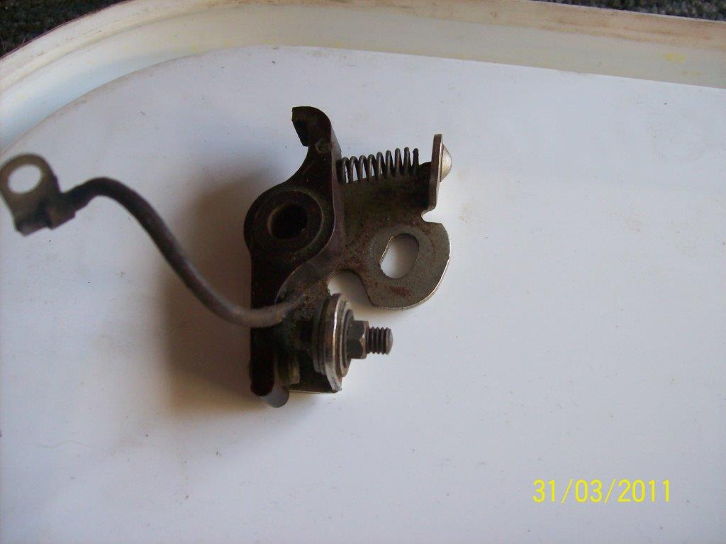

Here are the pictures of the ignition and ignition set-up.I hope this helps.
If you need a picture of the flywheel just let me know and I can take one for you.
This is how the coil pack looks off.
Condenser.
Points.
What I really like about these mowers is the points were made to be serviceable.Here it is apart.
This is the top view.Hope this helps let me know if you need more info,happy to help.
