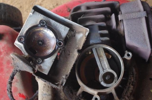

I'm assuming its a 2 stroke here as a lot of commandos were (and when the starter is removed the crankcase is exposed, I would be removing the head as well, something is causing it not to spin, some photos would help greatly smile

Assuming it's a 2 stroke power torque... (and pics would definitely help)
Make sure the fuel tap is off, disconnect the fuel line from the carb, undo the 3 bolts/screws in the top plastic cowling and remove it. Then undo the 3 bolts securing the starter to the engine block snd remove it. Should take 5 mins max. The head has the spark plug and decompressor screwed into it, just undo the 4 bolts to remove it.

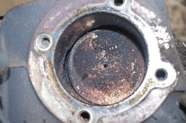

photos:
Posts: 13
update: crank now turns piston easily (head is off).

Sorry I havent been online, chances are nothing was badly stuck, perhaps even a large chunk of carbon had dislodged in the exhaust port and landed in the cylinder. Either way.
