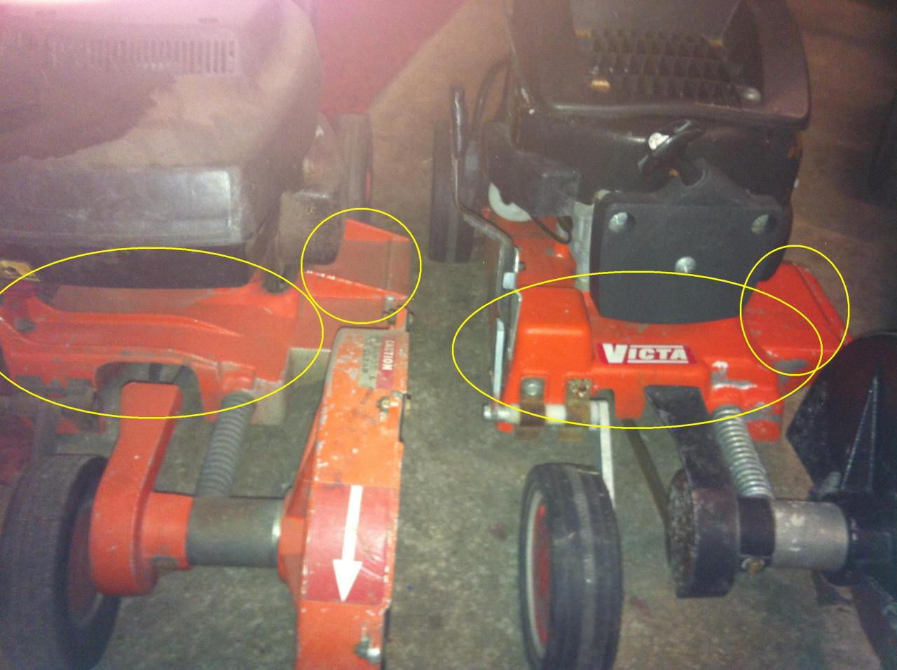

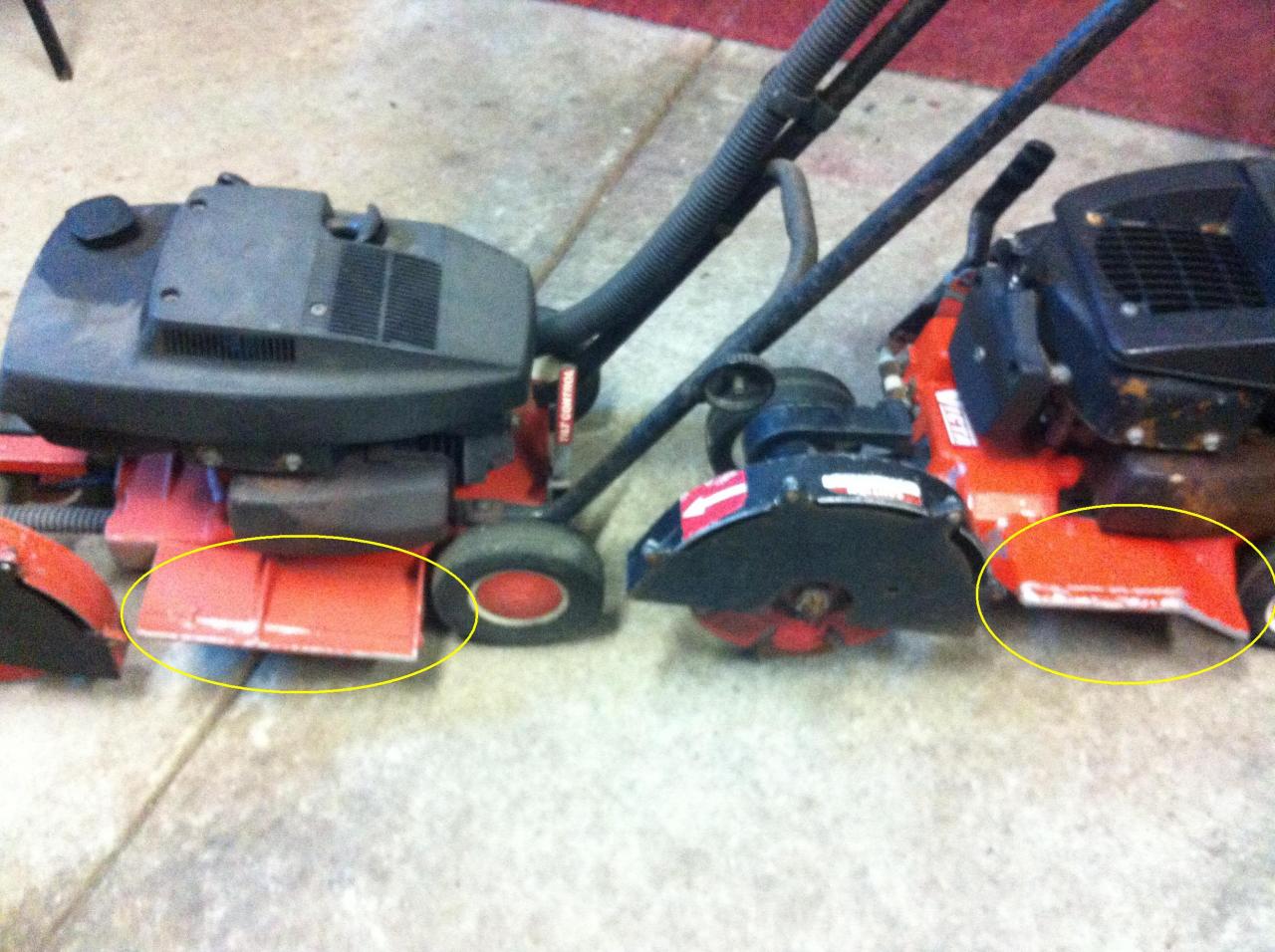

Hi vccomm, at first glance i was pretty sure that base was meant to have a cup starter full crank but i needed to be sure so out in the shed i went at 1:00am and took some photos. The highlighted bits speak for themselves but the other give away was the orange colored belt and blade cover, the side crank ones were black.

Either motor would work, I think I would prefer the older series 70 motor with the pull rope facing the back as the series 80 gear start motors pull from the side, I could just see myself or somone slipping and pulling the machine over onto themselves...
#50101 30/10/13 05:49 AM
good suggestion , thanks joe that comfirms it for me :) and always seem to have trouble with side pulls anyway , all the ones i get have been played with and missing the plate behind or other bits n pieces , seems it doesnt realy matter as bigteds has one type a rolla's ? has another so its allgood , thanks guys :cheers:
