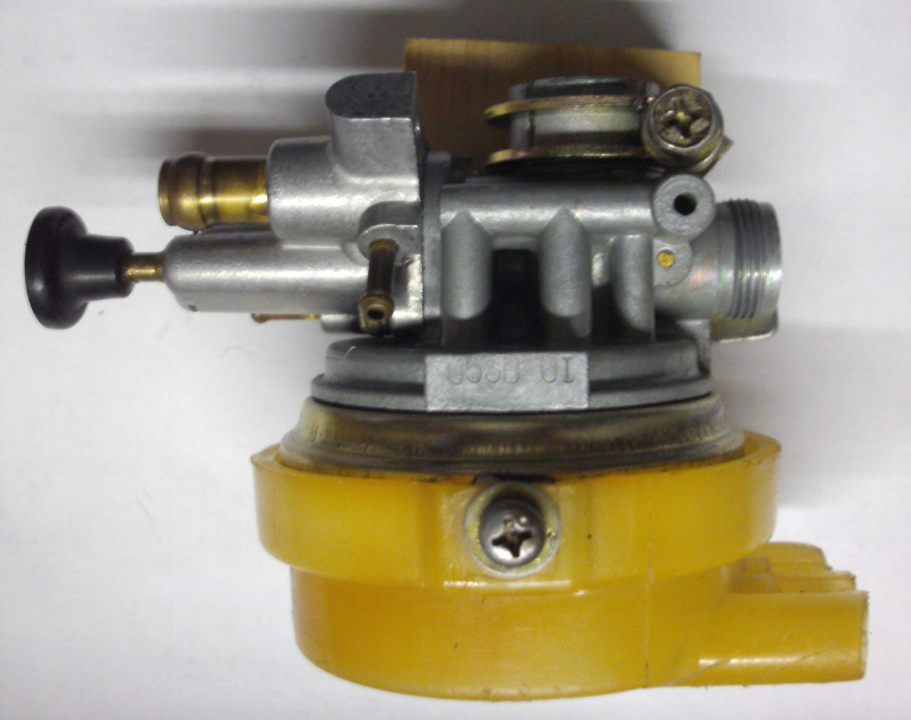

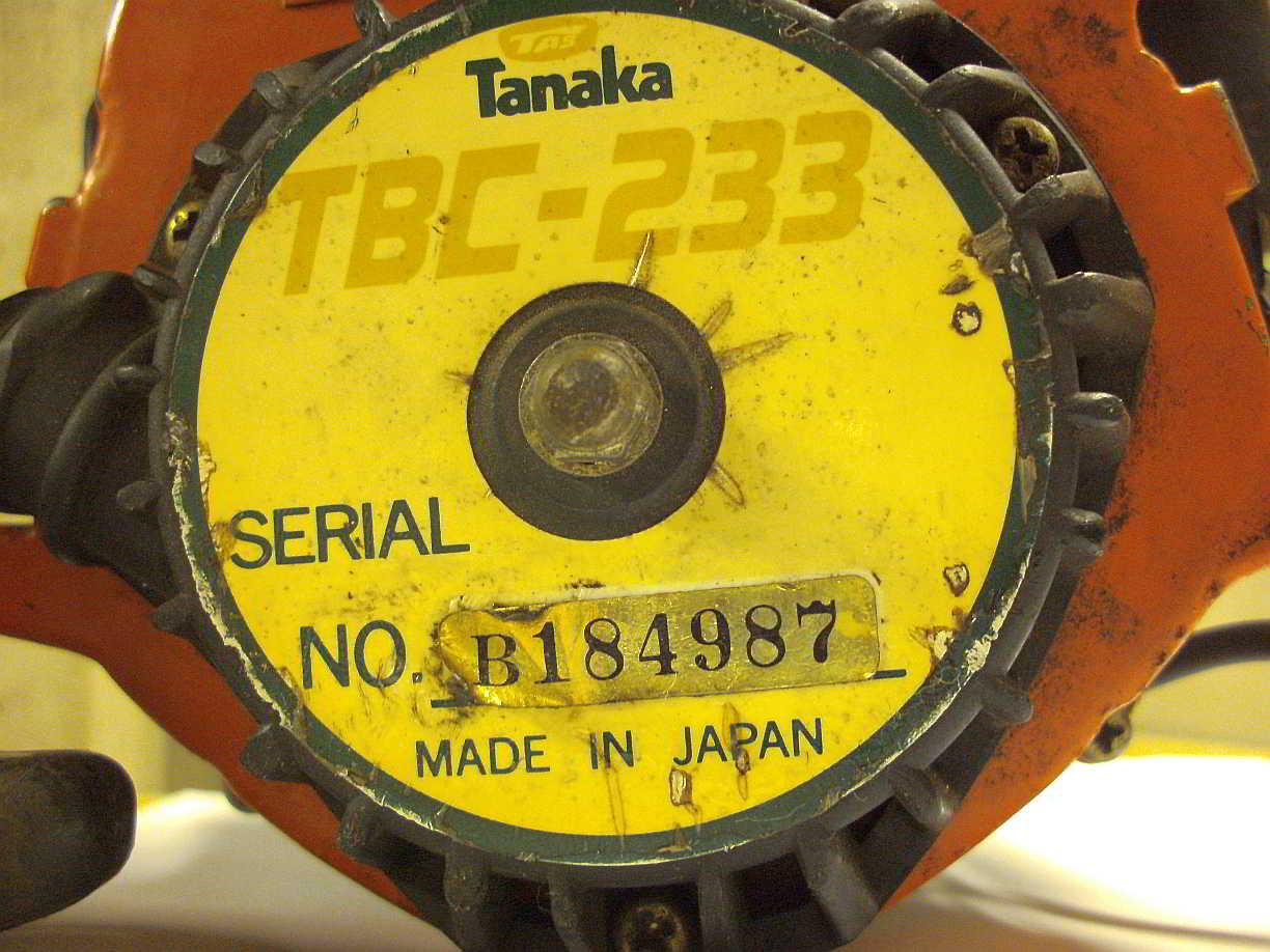

Hello All I have been given a brush cutter labelled Tanaka TBC-233 that doesn't run any more. I'm having difficulty finding any details on this model. It has a "different" (no gaskets, diaphragms or jets like the Walbro for a 230 or 232)style of carburettor marked O53B UI and what seems be a separate fuel pump on the bottom of the crankcase. Anyone have any ideas on it's "true" identity and where I might find some further detailed information. thanks Mark

It should be model TBC-23R which is quite old. I think the parts list is in the parts list and manuals are of the forum for brushcutters.

Thanks for uploading that Bruce. The carburetor looks rather like a 1950s Amal Monobloc except for the weird float chamber - and I don't currently understand how that would work upside-down, which is usually expected of a brush cutter.

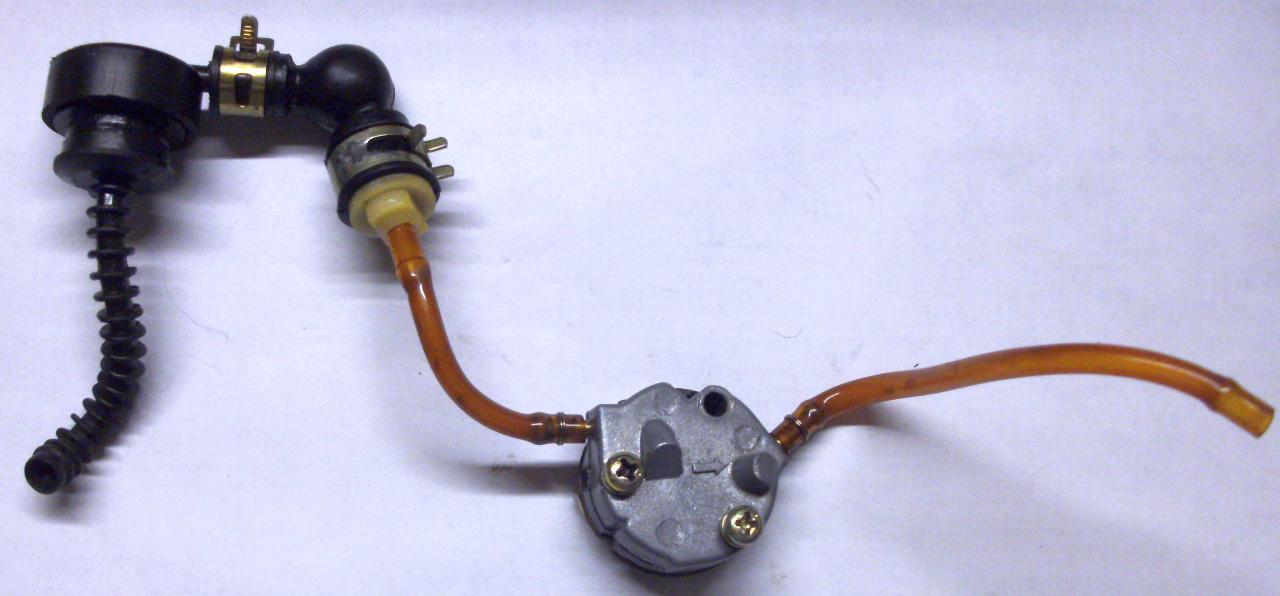

I added some photos of the Model#, Carburettor O53B UI?, and the pump/primer for your further comment.
The pump/primer may be the problem, no fuel flow after primimg or a few attempsts to start. Have replaced the fuel filter, lines and cleaned the pump.
Any suggestions on whether there is an OEM lit for the pump etc?

The parts list that I uploaded is the same unit including the carby. Note that the primer, pump diaphragms are available as well as the fuel pickup. cheers2

I've got one of these, or at least one very similar.
The problem with it is that the diaphragm in the fuel pump has gone hard, so it'll start and run for a little while when it's primed, but conks out after a while.
I've found the fuel primer bulb in the spare parts on outdoorking, but I can't find a kit for the fuel pump on there or anywhere else; does anyone know where I might find one?
The rest of the machine is in good condition so it'd be a pity to bin it.

I made a new diaphragm, I used one of the gaskets as a template and made a copy of the gasket on some gasket material.
I cut a square out of a chemical resistant nitrile disposable glove, and stuck that to the gasket with a small amount of glue in the sandwich maker (to make everything nice and flat), you could also use an iron but I don't have one at the moment.
I didn't need much glue, just enough to hold it in place while I cut the holes through the rubber (which is a pain, because it's tough) and assemble the pump.
It's running for the moment, unfortunately I didn't take any photos, as I didn't really expect to work.
As it's a disposable glove and not proper gasket material, I'm not sure how long it'll last, but I'll see.
