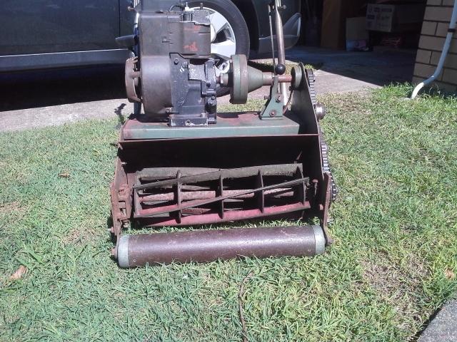

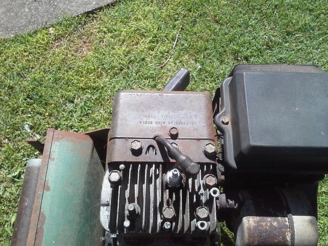

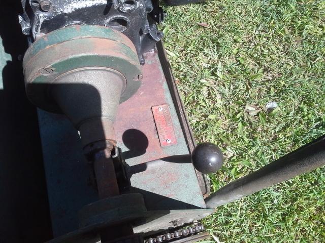

here we go!
Cheers Humdinger
Humdinger #48375 12/08/13 07:43 AM
Good stuff Humdinger, well it is as i thought, it is the later version with chains and V belt drive and appears in quite good condition for its age! grin
Plenty of meat on the reel...I would need a close up pics of the sprockets to access their condition...but from a distance they seem OK...
Can you post the complete string of numbers stamped into the top of the air cowling of the Briggs, I can then give you the date of manufacture of the engine.
I would also like pics of the clutch parts you are working on. wink
Thanks for posting the pics mate. grin
