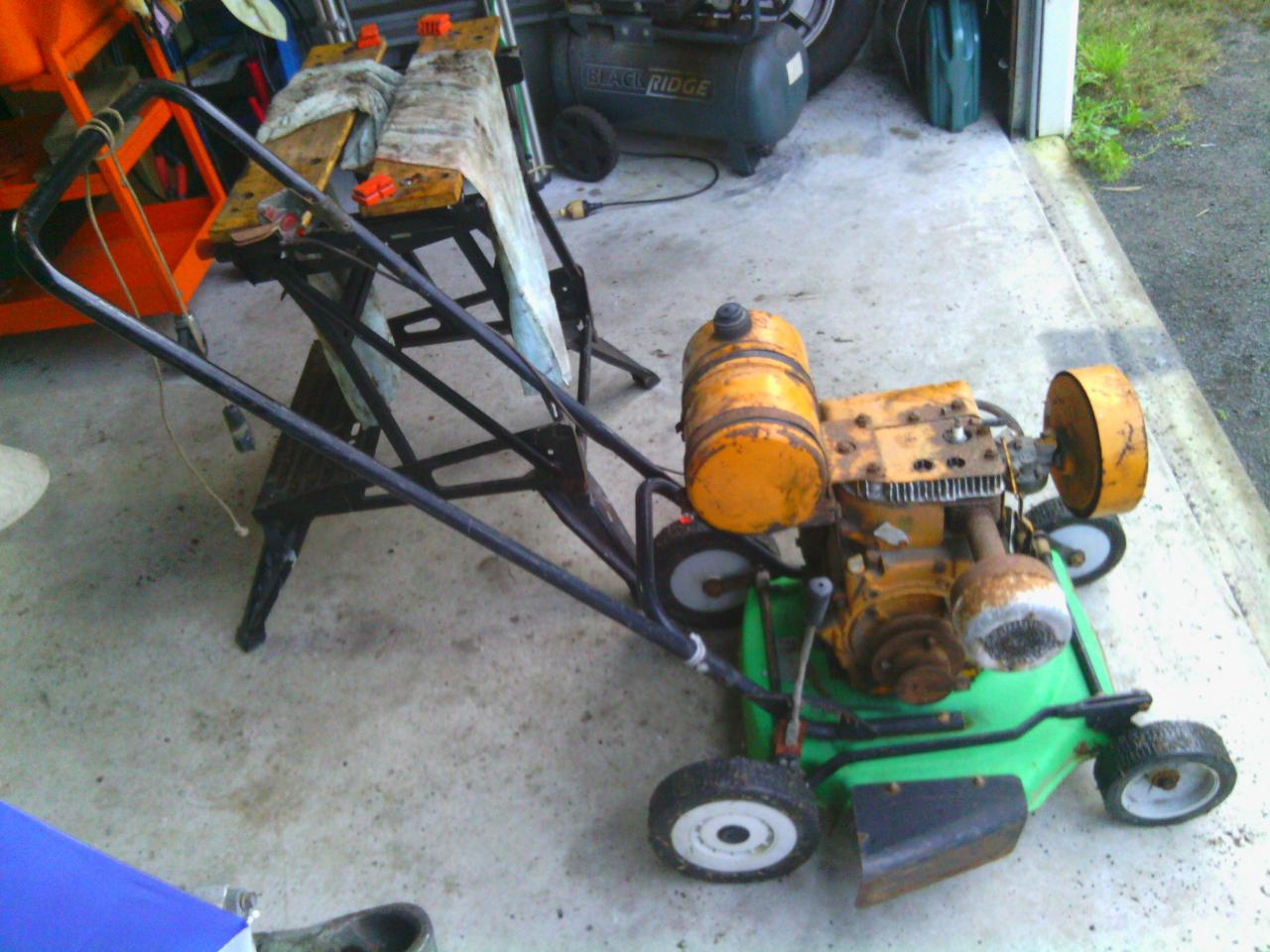

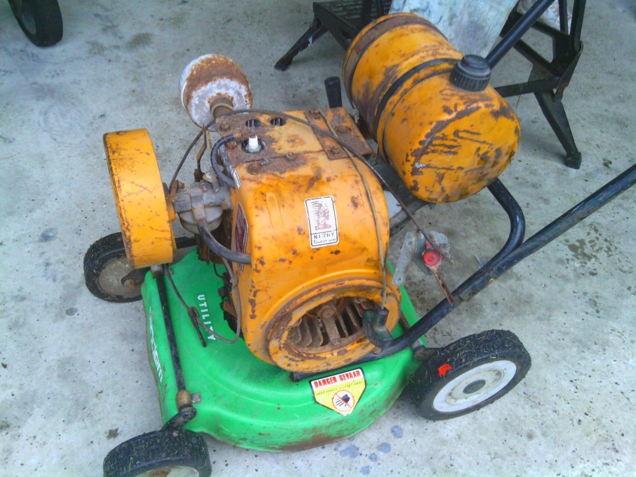

Gday everyone , can anyone tell me what hp this is it came of a mates old slasher all I got to do now is find a big enough cylinder mower to put it on lol. The nos/model HHK100 spec nos/ C3017 serial nos / 1236 1267. [Linked Image]

You didn't mention that it is a Kirby engine, roebuck, which was making it unnecessarily hard for us. The names of quite a few of the Kirby-Lauson engines had a simple code. H meant horizontal crankshaft and V meant vertical crankshaft, K meant built, assembled or sold by Kirby in Australia, and the number at the end was the alleged gross horsepower in tenths of a horsepower. The HHK range included, at a minimum, the HHK40, HHK60, HHK80, HHK100, and HHK120. Hence the HHK100 seems to have been alleged to have 10 hp gross output.

Hi Grumpy , it does have kirby/tecumseh written on it . So it's a 10 hp, I guessed that but I wasn't sure . I love looking at these older machines and when I get a few other projects out the way I will have a go at fixing this one. My mate would like to put a new motor on it or a a good second hand one on his slasher so now he can look for around the ten hp .
