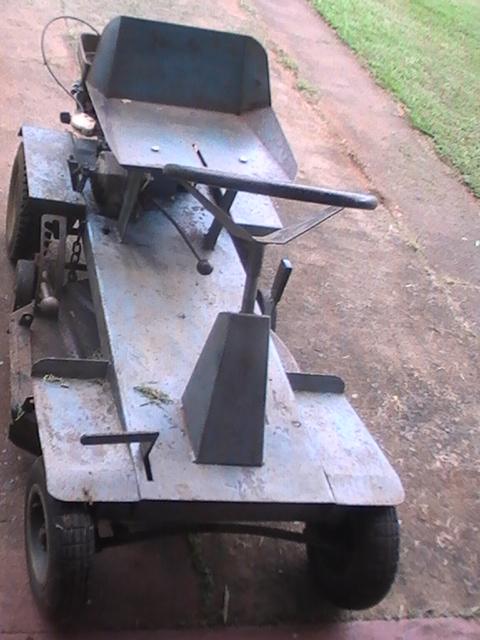

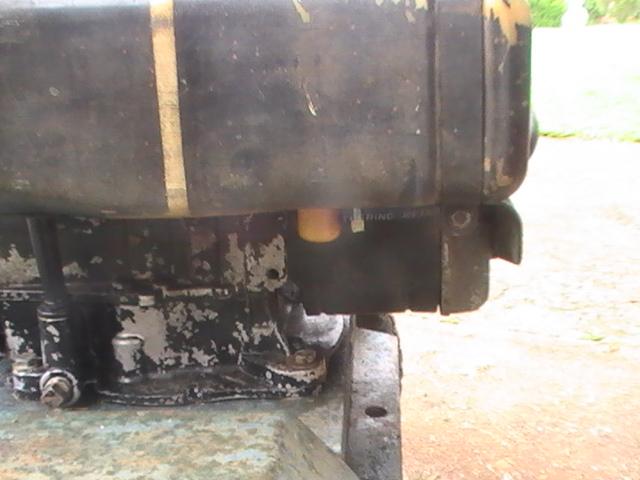

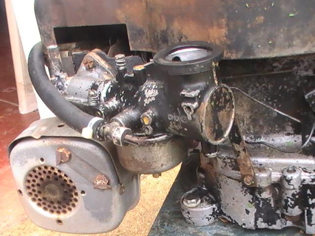

Hi Grumpy here are some carb pics and the baby ride on its mounted on pretty neat for a homey hey??? thanks mate cheers
Thanks Arthur, so far we know you have a large one-piece Flo-Jet carburetor and you have the multi-turn fuel tap, not the quarter-turn one. Now we need pictures back along the fuel hose shown in your second picture to find out if it has a fuel filter, and if it goes to a fuel pump.

aussie does anyone recognise the mower chassis as a manufactured one or is it home built u think ... ???
Its a rover colt 8, be very gentle on that gearbox, otherwise a pretty solid unit.
It's very simple, which hopefully means less to go wrong and less to fix. However as Joe said, using a gearbox means there is one rather vulnerable item that is expensive to repair. I don't like slipping-belt clutches either, because they wear out belts and pulleys fairly quickly. For a ride-on to keep using when it is 20+ years old, with only home repairs, I like the Greenfield design best of the ones I've seen. That isn't because it is marvellously reliable, it is because it is easy to fix, year after year.

Many thanks Grumpy n Joe yeah i reckon its a great little design did thay make some with bigger cuts and motors??? cheers arthur rockband
In the colt range there was a 5hp variant, while it sounds quite underpowered, I have personally used both and both go quote well, the 8hp was pretty unstoppable in heavy growth, where the 5hp was great for a maintained lawn or dry tall grass.
