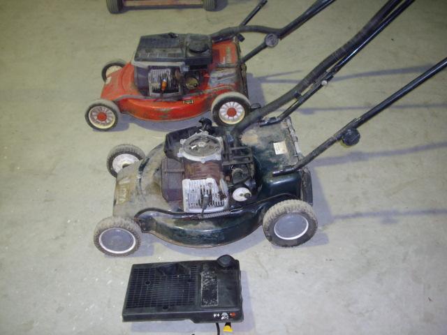

I need manuals and/or parts lists for series 80 victa engine & plastic carb .
I am after 2 x good working mowers from 3 i was given. I hsve got one going , but the other has a carb leak.
Appreciate any help
Charliexxxx
Posts: 5,434
Likes: 36
Charlie,
We need more detail but to start with you will need to check all the 'O' rings are ok. Photo's will also help. cheers2
Joined: Apr 2013
Posts: 2
Hi Bruce
Sorry for late response, I have been away for work & unable to get photos (see attached. Grey mower at front is the one I am fixing, the other is for spares). Anyway I have replaced the float bowl o ring & solved the fuel leakage problem, but now have no throttle control. I may have got springs around wrong way? An exploded view of plastic carb would be most helpful. It has also got a problem with kill switch not working. it wor[Linked Image]
ks if I wiggle wires at carb , but not at throttle control.
