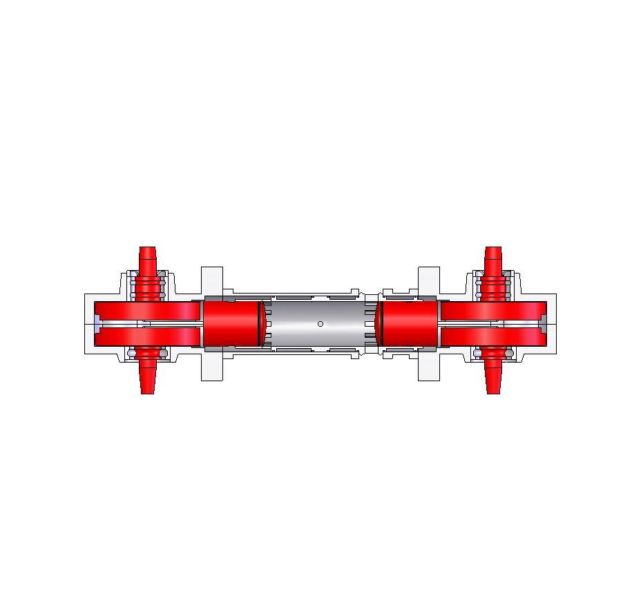

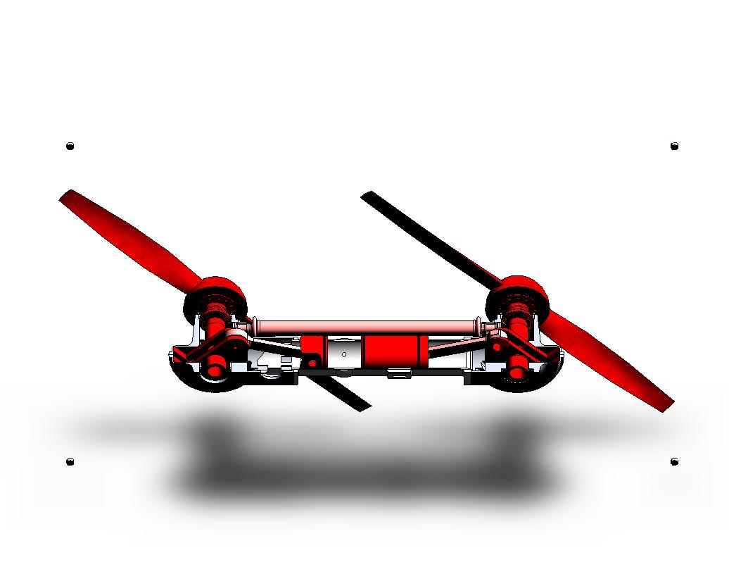

I have a plan to revolutionize light aircraft flying with a two stroke engine as shown.
If the scheme is a no go it will come from torsional vibrations and to analyse that a small model of say 300 ccm will be alright.

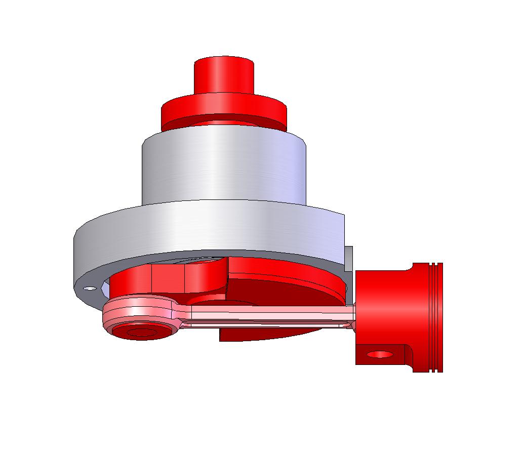

I am trying to bash something together from used east German motorbike MZ parts as shown om next picture but something from single side Victa two stroke cranks will be much nicer.
On Ebay Australia such lawnmowers can be had if you come and collect but air tickets are expensive and airfreight of two complete lawnmowers also.
Question is, who can be persuaded to sell me two used crankcases, two cranks and connecting rods, all Victa single side cranks?

Hi Niels, you have some interesting ideas there. Would you mind posting your request for Victa parts in our "Wanted" forum please? It is part of the "Finding and Swapping" superforum. Many members would have the used PowerTorque parts you are looking for, but working out a shipping solution to get them to Denmark may require some discussion.

Thank You for guiding me to the rigth place in forums,but I will try and make a screwed crankpin crankshaft myself.
Also now I realizes that Victa cylinder and crankcase is one piece and very expensive to send.
Please enjoy the pictures and do not bother further.
Kind regards
Niels
Thanks for keeping us up to date, Niels. The Victa engine with the cantilevered crankshaft, called PowerTorque, has a cast iron crankcase and cylinder, which in my opinion limits its suitability for your light aircraft project. There are many Japanese cantilevered crankshaft engines which are extremely light-weight, but being made for brushcutters and similar light-duty purposes, they are very small in capacity - probably too small for your purposes. Please accept my best wishes for an enjoyable and productive project.

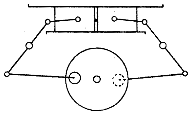

I think the old Commer truck engine was the same design with apposeing pistons. A two stroke diesel..
That was the Commer TS3, Dave, known as the "Commer Knocker" because of its awesome diesel knock. It had a single crankshaft, with connecting rods running outward to fairly massive rocker arms, which attached to the pistons through a second set of connecting rods. It had three cylinders with two pistons in each, firing each pair of pistons simultaneously of course. Here is the diagram of its internals from Wikipedia:
(Heh heh. That saved me drawing my own picture. Bless Wikipedia, I say.)
Note that this was a 2 stroke engine without crankcase induction, so it needed some kind of air pump to charge its cylinders with air. As it happened it used a Rootes blower to do this, the same solution adopted by Kettering for the 2 stroke Detroit Diesel, introduced many years earlier (in the 1920s) and produced in high volume until the 1980s I think, when it began to be gradually supplanted by a 4 stroke. The TS3 had a very noisy exhaust (even more so than the Detroit Diesel), which was more or less legal back in those days. However unless you were a born hot-rodder, you would probably not have cared much for either the extraordinary knock at idle or the bellowing exhaust under load - I certainly didn't enjoy them. I once spent a couple of hours at a university open day demonstrating a TS3 on a dynamometer for public visitors. Fortunately that one had an underground exhaust and was more or less civilised.
The Commer trucks were popular in Australia in the 1950s, when nearly everything sold here was British. Many old TS3s are probably still lying in wrecker's yards around the country.
There have been several proposals for opposed piston 2 strokes with two crankshafts, as proposed by Niels. They generally were laid out more or less along the lines of the one illustrated here (also from Wikipedia):
Note: the engine in this illustration appears to use crankcase induction, and could probably have run adequately without the supercharger, but it started out as a racing motorcycle engine (DKW) and was presumably intended to maximise power output. Niels proposes to not use a supercharger, and just use two ordinary crankcase induction two strokes which share a combustion chamber. Better results can be achieved by having the transfer port on one cylinder and the exhaust port on the other, with the two crankshafts timed slightly differently from each other so more efficient port timing can be implemented. The ability to do that is usually the main reason for using an opposed piston design.
I don't know of any of the opposed piston engines except for the TS3 having been produced in any substantial volume. They are usually just designs, or at most single prototypes. I said above that the main advantage of opposed piston two strokes is the ability to use slightly differently timing of the two crankshafts, one of which controls the intake port timing and the other the exhaust port timing. Note that there is another way to achieve this, without the bulk and complication of two crankshafts. That is the Puch "split single" concept (which was sold in the US under the name "twingle"). You can read how it works in Wikipedia:
