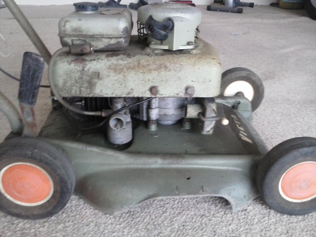

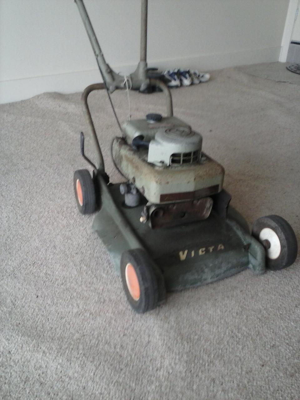

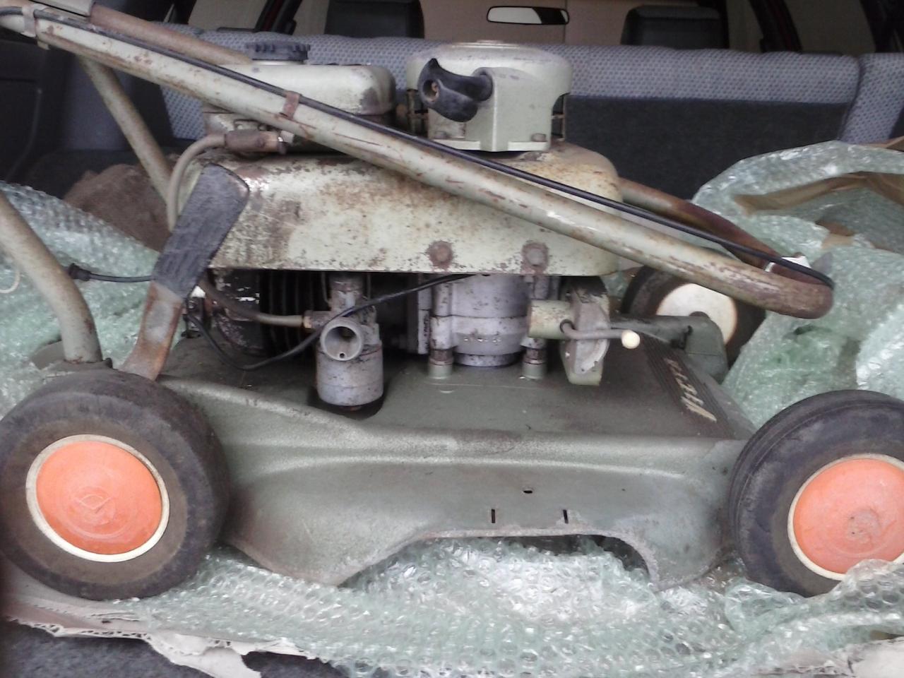

hey all found this one on gum tree its in great nick body is perfect motor feels ok missing snorkel tube and filter and front case. even the plastic height adjuster is there ......... and i am in trouble with Jeffrey when he see's this post.
Awesome find,this one is gonna do up real nice...Ah Blumbly has enough toys to last a lifetime,lols. I hopefully have something special coming up,keep your eyes peeled for a real original rarity..Im slowly starting to expand my horizons and this one may be on my list as ive only got 2 more to finish my collection from fan 2 to sheerline 9.....The 2a and sheerline 6.Erm cant you put it in flashing lights with a sign that says..NER NER Blumbly..look what I Gotttttttttttttttt! lols.

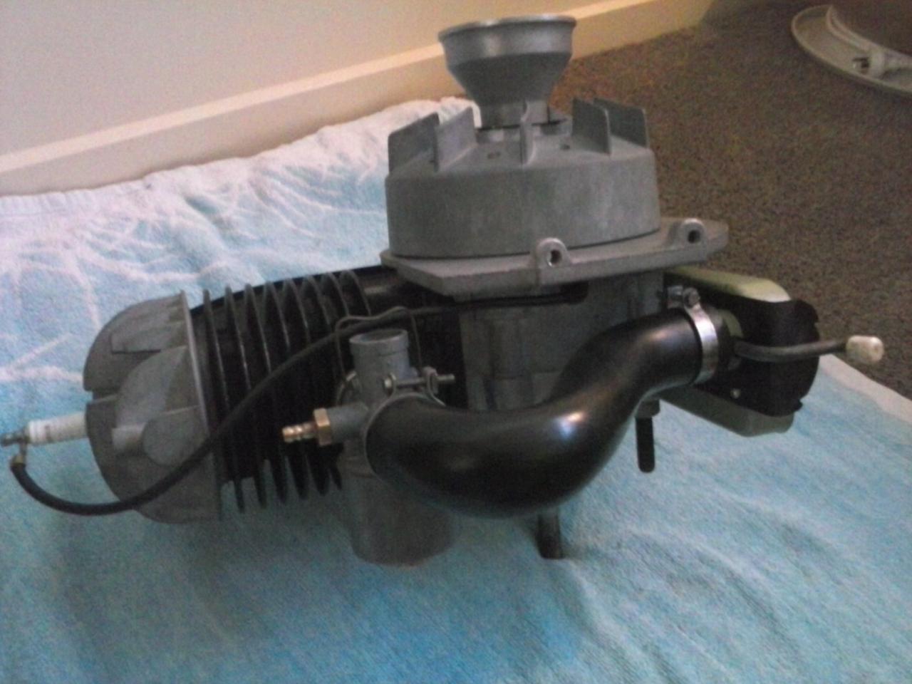

here is a pic of the snorkel tube.
Ahh I see,okies thought it a normal one,sorry not up on these late models lols...But serioulsy if the one in the image is yours,go through a Gates radiator hose catalogue and find one,shouldnt be too hard. take the sample and the hoses in the CAT have dimensions and lengths to the mm. Ive matched hundreds of hoses over the years when ive been rushed or doing unusual NA hoses for cars or if they have been just ridiculous expensive...Some of the nissans and efi corollas have S styles in 32 to 40 mm,check them out.

this is the engine of my earlier consul ive been restoring.
Not a bad idea at all was thinking of a washing machine repair place , it came to me the other day when my ol hoover done a hose and its virtually the same material and size i recon there would me one very similar out there
Awesome! even better smile a lot of earlier rad hoses are smooth,daihatsu only made them smooth,and your right washing machine would be a good bet as they are often s shaped as well to allow for flex when its rotating...See you can find anything if you think about it! Cant wait to see this one finished,Im really loving its style and air box set up!
