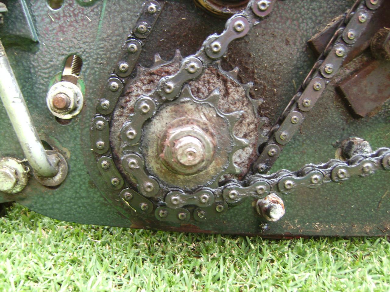

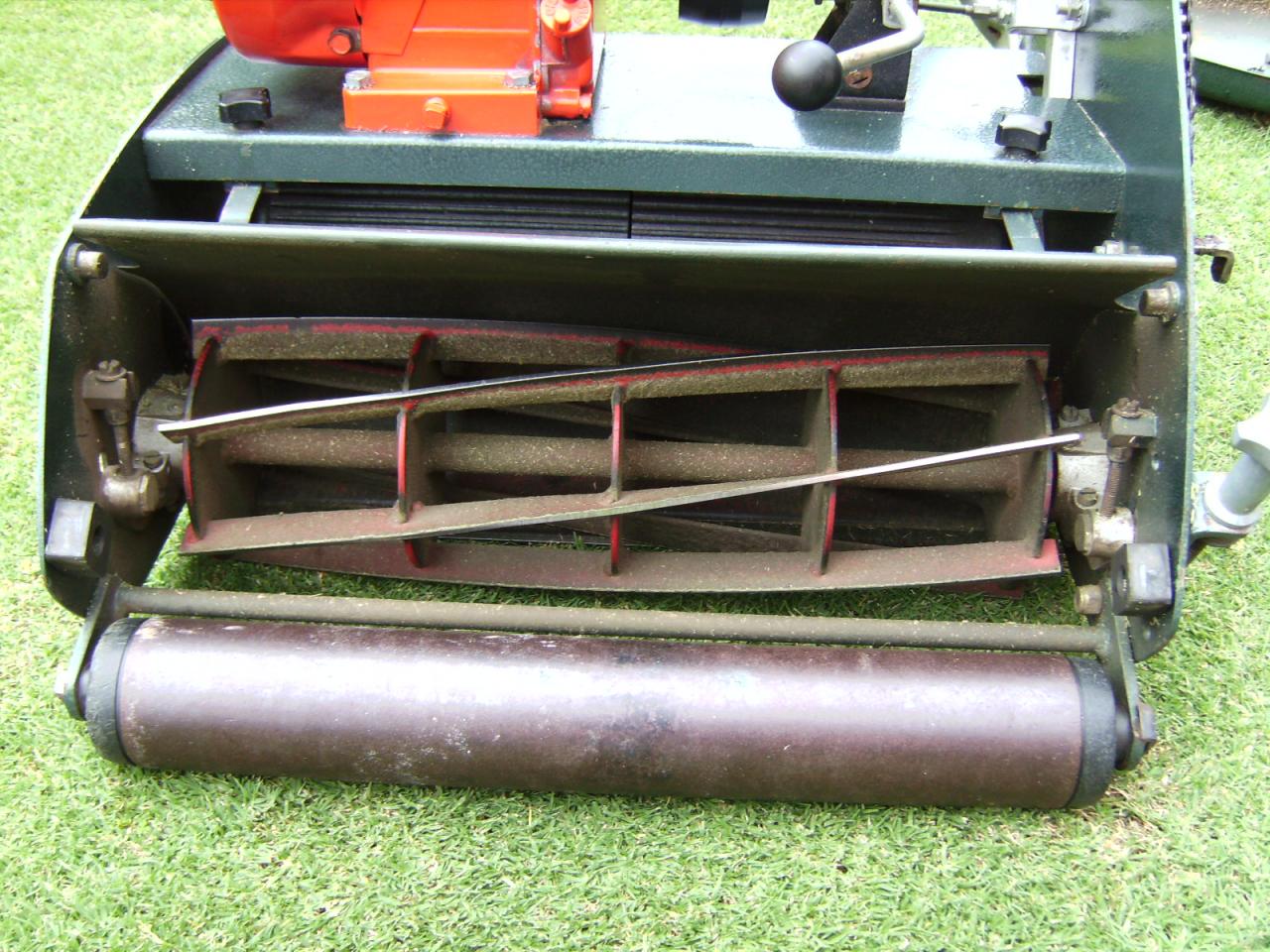

As grumpy has kindly replied, I'd like you please to post some pics of the cylinder reel, bedknife (bottom blade, especially the front vertical edge and the chains and sprockets from a point in line with their axes, so that the tooth form can be seen clearly.

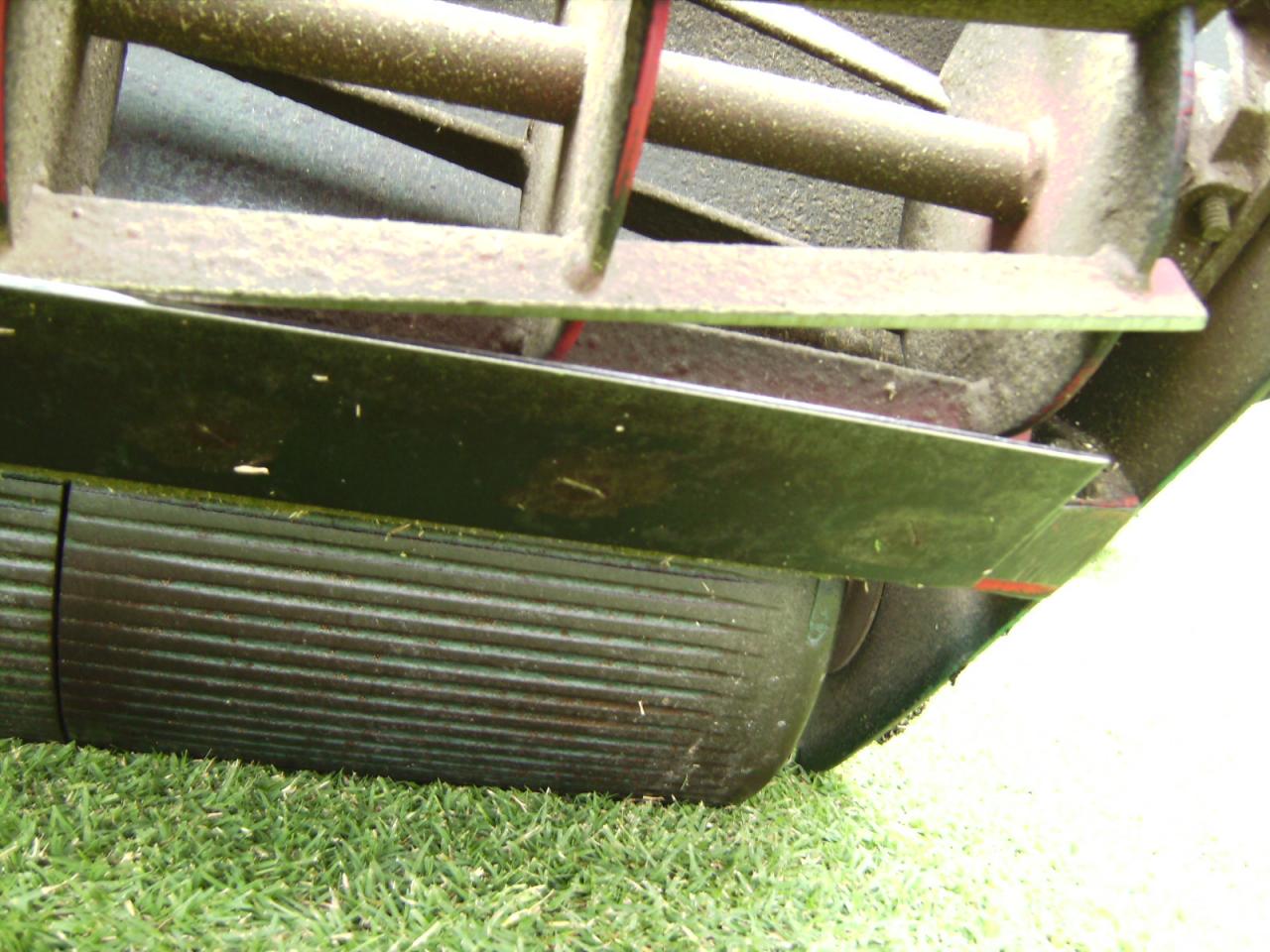

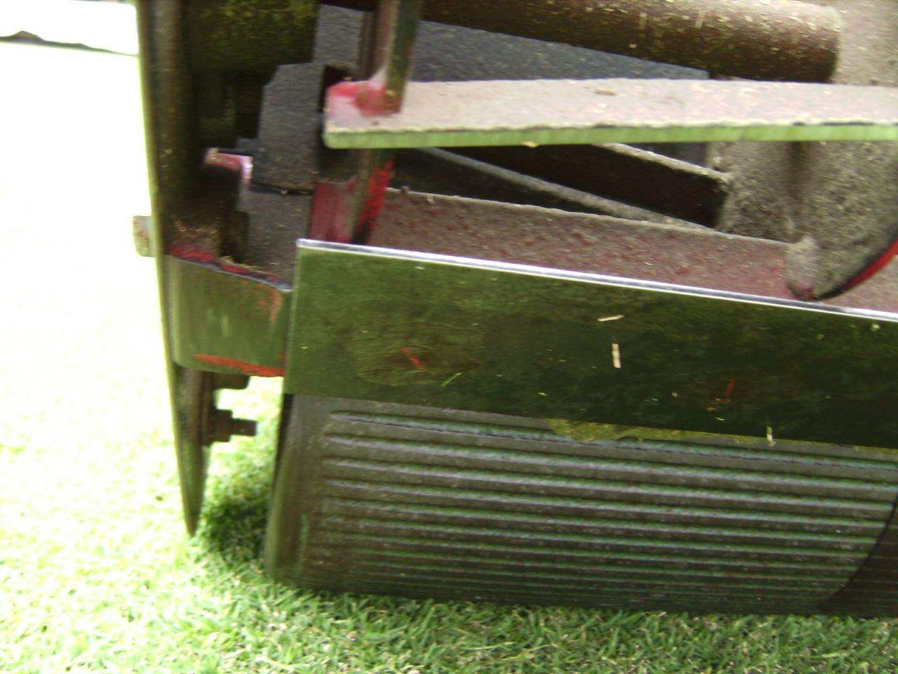

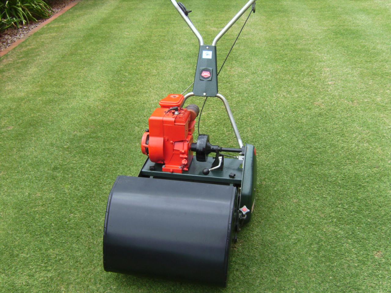

Posts: 13
Hi,

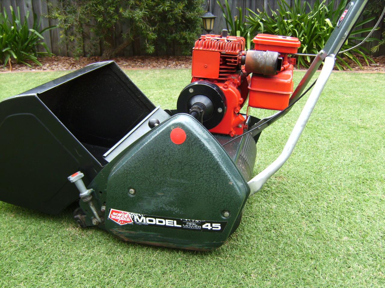

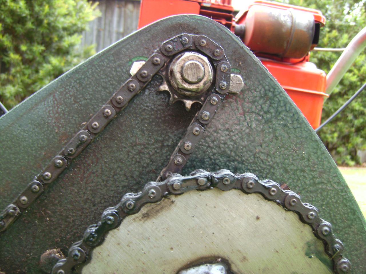

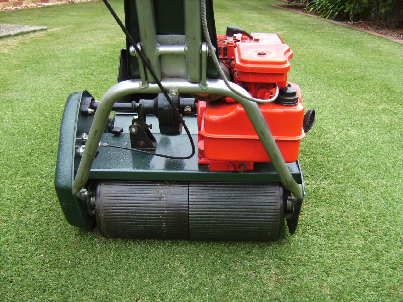

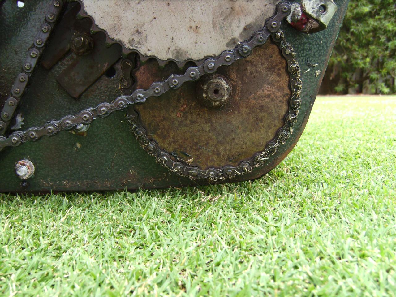

I have added some photo's which I hope will help you to give me some tips as to the next step I should take.
I'd love to know something of the history of my SB but there is no identification plate to refer to.
I'd like to get the reel and bed knife sharpened but I'd appreciate your advice about the life left in the old girl. The mower is as I bought it from Sydney Roller Mower Centre in about 2005.
Many thanks to you all! I really love your site.
All the best,
Mark.
Hi Mark, thanks for the heads up on your post, I must have missed your reply, I am sorry. blush
Mate, some info on your machine....looking at the solid engine deck, she is an early machine (unless the deck has been replaced at some stage) if it is a Series 1...I would date it from 1968 - 1973 roughly...we can get a good guess at its age if you post the complete string of numbers on the air-cowling of the Briggs engine.
She has a couple of later model features...the black plastic end caps on the front roller and the later model logo on the handle bar cover and also the black knobs on the grass deflector adjusters....This is strange unless she is a 'bitsa'. Maybe someone started a restoration earlier and bought all the Series 2 bits for her....I'm leaning towards the engine deck being replaced because the twin-rail Series 2 was prone to cracking. She may be a Series 2 machine. wink
The cylinder reel has heaps of life left...the bottom blade less so...may need to be replaced in the future.
The sprockets are all serviceable, however you will need to replace the double cutter sprocket and the small engine primary sprocket as they are both nearing the end of their service life. At this time, you will need also to replace the primary chain for these sprockets, as it will have stretched. wink
Finally, a re-spray of the chassis including the catcher...(engine is fine)....new engine and chassis decals and stickers...she will come up a treat!! party
There you have it! Looking forward to your posting the numbers on the Briggs cowling....

Hi Mark, your machine is later than I thought; your engine was manufactured on the 27th August 1975 in the US., was shipped to Australia and was placed on the chassis probably later that year or early 1976.
My thoughts are now that she is a Series 2 machine that has had the engine deck replaced (that might be the reason that the ID plate is missing) but that is a good thing, because as I have explained the twin rail system is prone to cracking. good1
She is a beauty, and will come up a treat with some TLC!

I notice that the reel adjusters are quite a way down. Is this what leads you to suggest replacing the bottom blade?
Mark.
Hi Mark, no, not necessarily, mainly the thickness of the bed knife at its front edge....but at the moment it looks fine. wink
