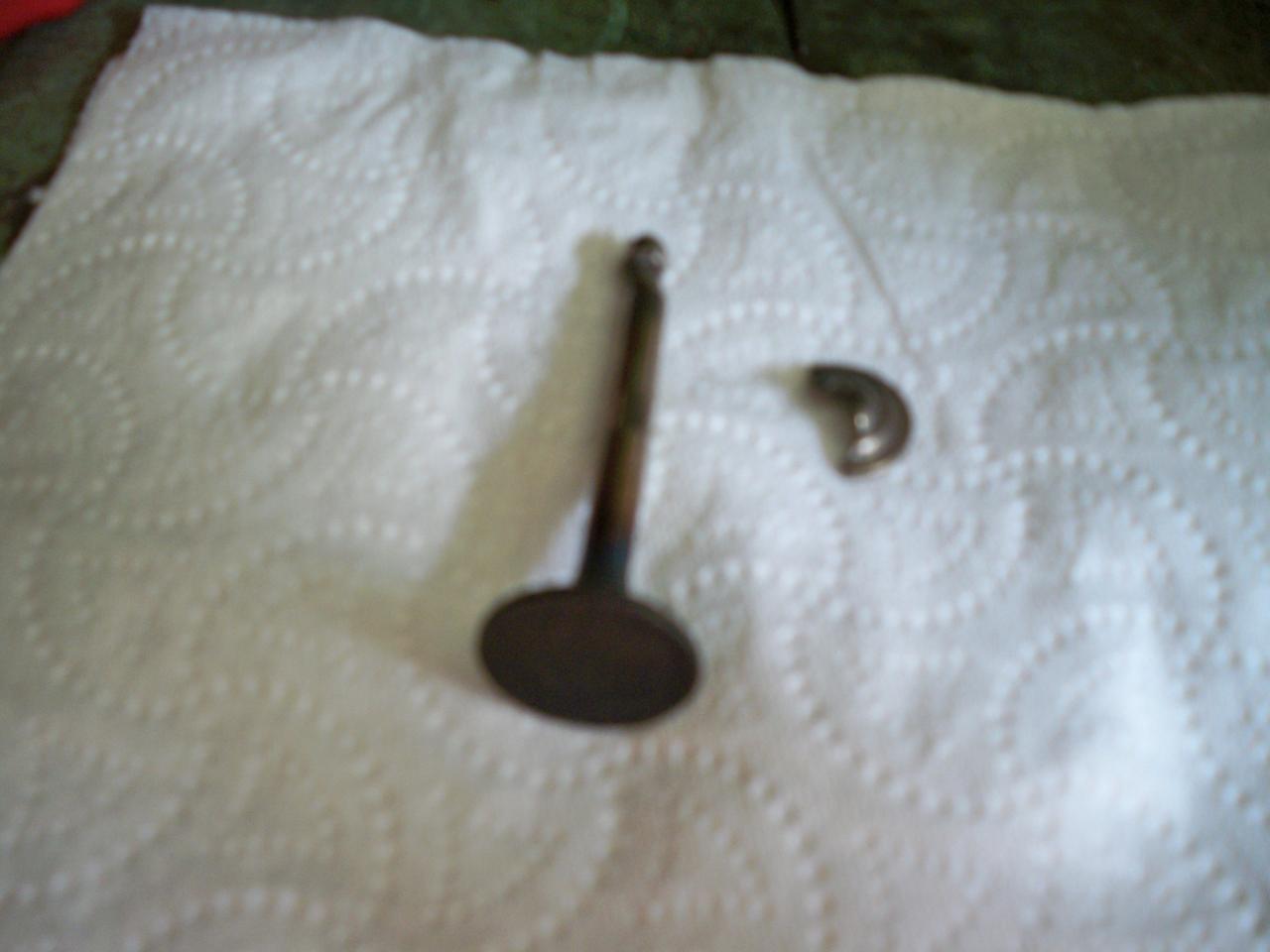

I have a 6.5 hp Tecumseh motor Purchased in 2010 I only used it approx 3 times.The last time I used it she stopped dead and when I opened her up I found a bent exhaust valve an broken collet I have been unable to obtain these 2 items brand new and was wondering if the machine is worth chasing after second hand parts and where would I look for them.No-one up here in Townsville has any Hope some one can help
Thanks Ed

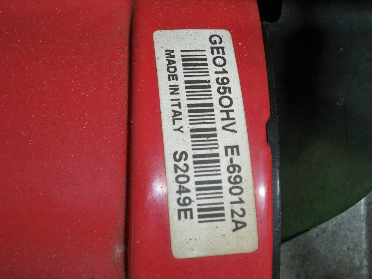

Thanks for the info have tried both sites Mfg did not have anything suitable and outdoor Distributors require the model number to search and the numbers that I have are not showing up as a model number. I have searched this motor all over and have failed to find any other numbers

The model number is the first line from that sticker on the starter housing. Hence it is normally called a Geo 195 OHV. That is, it is from Tecumseh's last model line, which they called Geo-Tech, it is a 195cc engine, and it has Over-Head Valves. It was made in both vertical and horizontal crankshaft versions. Your particular variant of this model series, the 65 version with horizontal crankshaft, is an E-69012A. I can find almost no information on this engine on the internet - my guess is that Tecumseh's venture into OHV engines happened in the last moments of their engine production and consequently distribution of spare parts may not have been all that extensive.

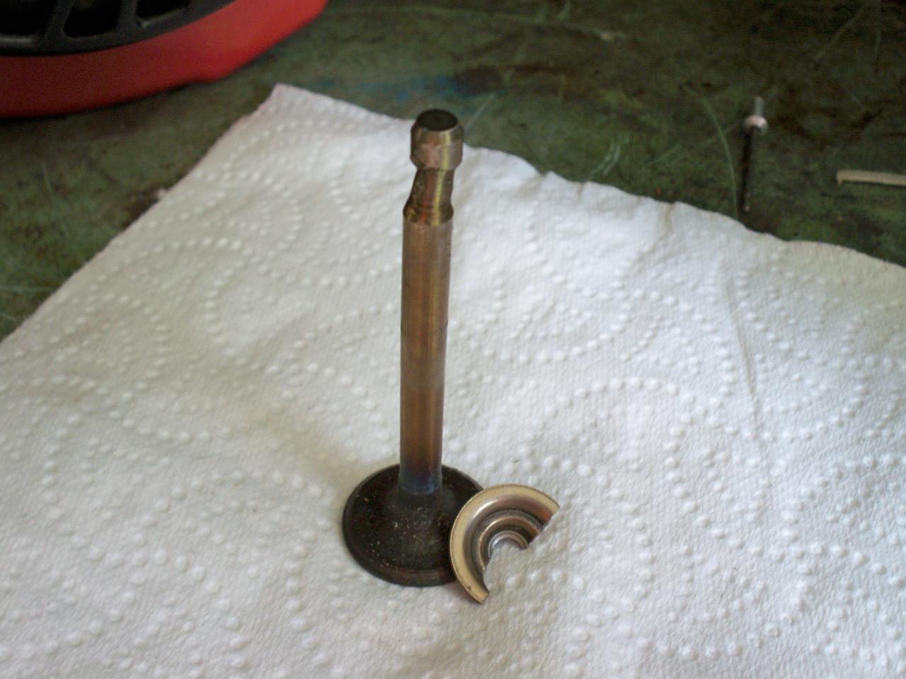

One of the problems with vertical-cylinder OHV engines is that if the valve retainer breaks, or slips off due to poor assembly, you get the outcome that stockman got. Hence a brand-new, never-been-started GeoTech 65 might easily have a brittle or wrongly installed valve retainer like stockman's seems to have had, and produce the same result again. A new valve and a new retainer sound like a better solution to me, at least if the original piston has been carefully inspected and isn't cracked or bent. (It would be a good idea to check that the connecting rod, cylinder bore and cylinder head were not damaged too, of course.)
