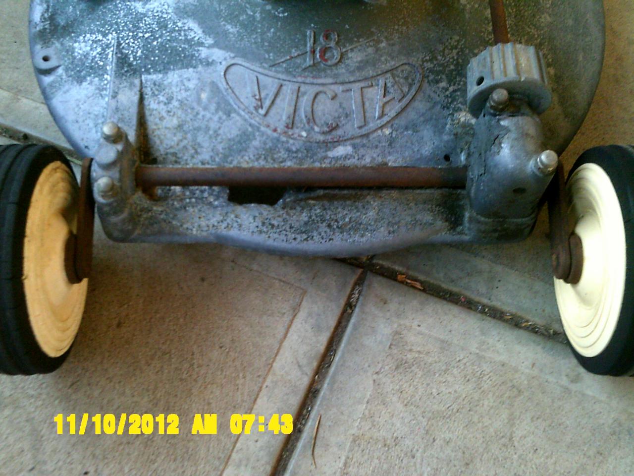

i have seen an amazing amount of 18's on here but cant seem to find one , picked one up last week and not a happy chappy ! siezed and a hole in the base but its differnt to ones i have see , no extentoions on the front for the flap rod confused . all i have now have them ? this one doesnt . a pity the base is holed but if need be it can be fixed . i looked closely and its not been modified as best i can tell , other things might have been but not the base [Linked Image]

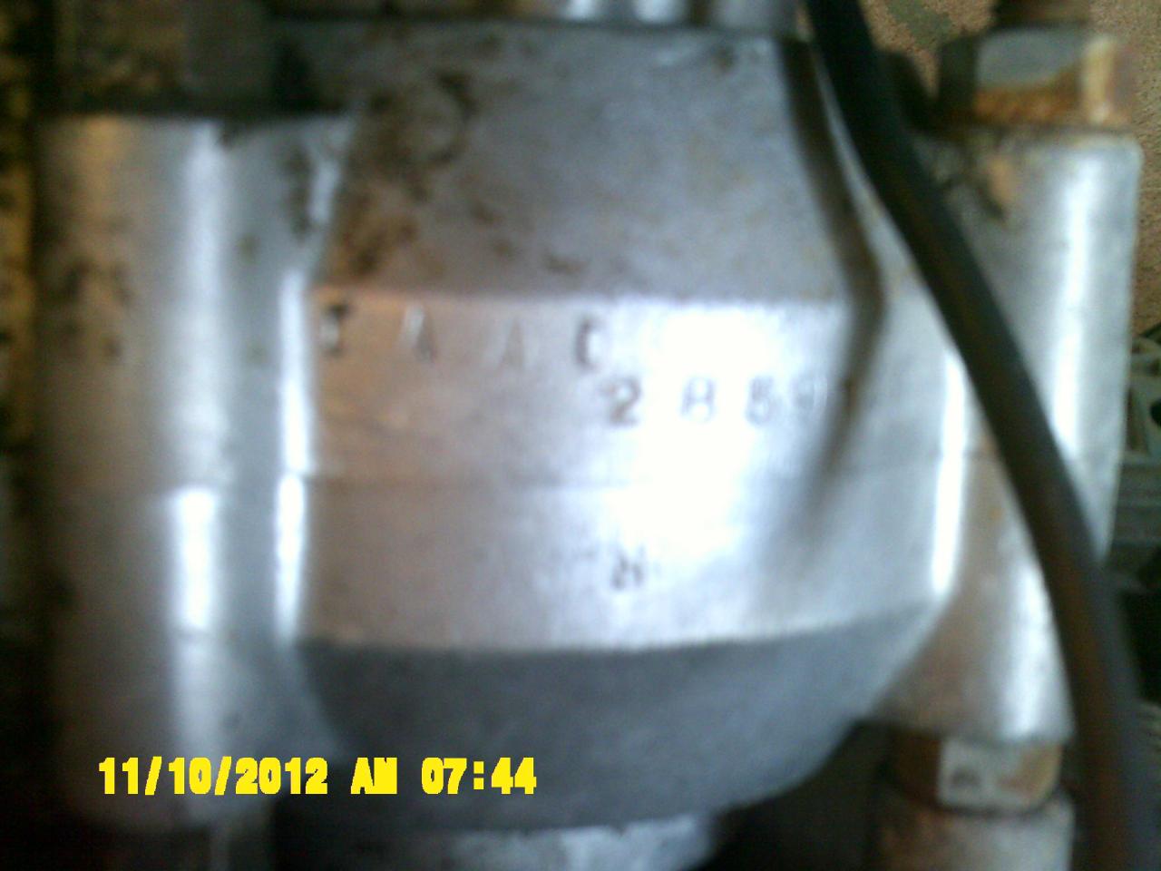

eng' no' i think is I or TAAD 28591 , N on the lower case . a few others too , and 2 boxes of parts , wheels , starters , a few carby's, plates nuts n bolts and a leaf guard or 2 . one has the round start handle ! got 'em from gumtree . smile happy so far but too hot to do much except clean a little and have a beer n think cheers Dave

No extensions makes it a second series model 5, the first series had the extensions there as they were basically a model 4 base give or take a few details...
vccomm #41804 12/11/12 01:27 PM
What you have a model 5 series 2. However I do believe it doesn't have the right engine. It has a series 3 or something similar to that,like maybe a model 8. The series 2 just had straight numbers not with letters.

I wouldnt be a happy chappy either.Yes its a model 5 series 2.Predicta extensions deleted.Your enigne is definately an IAAD..... And is correct for the model 5 series,just of a later model as blumbly suggests.More likely a 3.Hope you didnt pay much.This version of the 5 is not very appealing to me personally,and holds no collector status.BUT each to their own,Im not here to bag out your choice of mower,It will restore nicely.If you are keen on the specials and want something a little rarer,lower nos or more iconic,go for the earlier models.Model 4 Predicta,STD,model 5 series 1 the first TRUE special nos should run from 110,00 to 128,000 Then around 200,000 to 300,000 for the true model 5. If the starter with the round knob has the lock nut on top.relist it on ebay and probably cover what you payed for the mower?.

a bit more info' on theses things , 1st one is the pictured one engine no' 277663,6 on the lower case [Linked Image]
the other engine's are . 266944,6 on the lower , and cai806 brass cam and no victa cast on the top front of casing . the i could be a 1 as its not stamped clearly ! and @ 8 good cond' wheel caps a few starters nuts n bolts most stainless sundry bit n pieces so hmmmmmmm maybe didnt pay too much i hope lol
vccomm #41861 14/11/12 02:40 PM
The First mower is a model 5 series 2 as is the first engine,both mid runs.The third is very unusual but ive heard of industrial and marine (Non Tiger Engines) Stamped Like This With no Victa.Hopefully another member may know more on the last as Im not entirely certain.A pic will help more,Could even be a model 1 engine,I have heard of strange serial nos on the very early versions of the Model 1,Maybee the first 200 to 500. As for what you paid I dont know,But it seems you got quite a bitand a good score.The 2 accurate model 5 series engines are very good to have.Please get a pic up of the cai806 engine if you can.

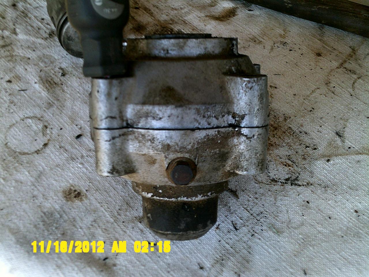

hahaha thanks , it grew too fast ! the car hasnt fit for a while now . sorry for the delay i got uuuum hurt at work blush this is the engine in question pulled down , i thought the missing piece of piston skirt was the problem with limited movement but it turned out it had water in the top bearing at sometime , for sometime ! i think you can see the rust ? bore is scored a little but i think ok as its not going to be a daily use machine . piston is U/S or noooo good busted skirt , and a few other bits that came with them . [Linked Image]
a lot more bits n pieces too , the engine was all apart and i think these were the closest match i found smile wow the brass cam was hard to remove , surprised at the patients i still have cheers Dave
