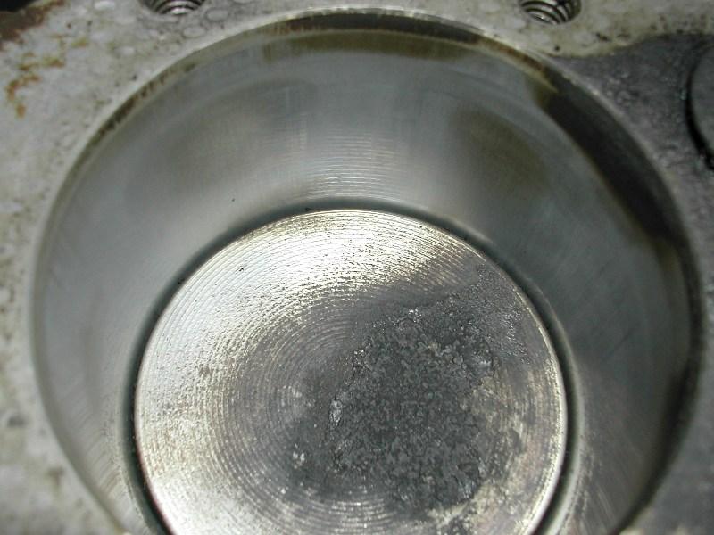

Ok Grumpy, I will pull the head off today and take a picture of the bore.
Thanks.
Thanks Mark, whatever it looks like there will be plenty of members who are interested, including me.

Here are the pictures of the bore.
Any advice on how to proceed from here, as always, is much accepted by me.

Mark, I seem to be seeing chunks of aluminium swarf - see red circles:
I suggest you look closely and see if those silver bits actually are aluminium swarf. If they are, it seems as if the engine may have seized close to bottom dead center, and you haven't run it since it happened, so the bore has not yet been damaged appreciably further up.
If there is aluminium swarf jammed between the piston and the aluminium bore, you need a way to get it out without scratching the bore. This may mean removing the piston from the cylinder and cleaning up piston grooves, rings, and bore. Even if this turns out to be what happened, after clean-up it should be OK because any bore damage is at the bottom of the stroke, which doesn't matter as much as further up.
Please post to tell us whether it is aluminium scrapings, and what you plan to do about it.

Grumpy, your red circles are the flash reflecting off oil.
No swarf seen, had to get a magnifing glass, eyes are not what they used to be.

If there is no sign of aluminium swarf, given that it took a major effort to break it loose, it is possible that it was the big end bearing that seized, not the piston rings. That would be a bit harder to fix: replace connecting rod, and linish the aluminium off the crankshaft. All in all, probably the most practical thing to do is just tune it up, and use it. The bore looks fine, it does not seem to have been seized there.

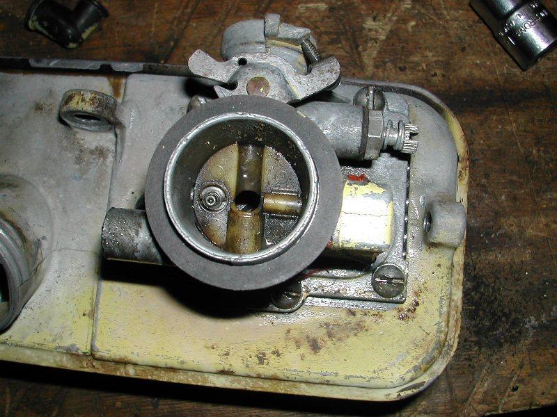

The flatness standard for both the bottom of the carburetor and the top of the fuel tank is not more than 0.002" low in the center, measured with a straight edge across the carburetor or tank from side to side, and a feeler gauge in the center.
The choke preloading is done by opening the choke as far as possible (past fully open) and holding it in that position while doing up the carburetor-to-tank mounting screws. It is well worth servicing that carburetor with the Briggs & Stratton Service and Repair Instructions 1984, open in front of you. The specific automatic choke instructions are on pages 39-43.
A 92908 should start first or second pull, even after sitting in the shed for a couple of months. If it doesn't, it needs fixing.
That idle scew in the photo there is wound in way too far, it looks as if somone has already messed with it beforehand smile

I have got it all back together now, I tried to start it and it wouldnt start, so I wound the screw out that Joe noticed and it starts easily now.
(well spotted).

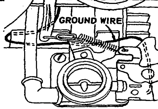

Mark, it will take a lot of luck for that governor spring arrangement to give the correct governor speed characteristic - the link was correctly installed in the first place, it just needed a new spring. Here is the illustration from the manual:
With your substitute spring the chances are the maximum engine speed will no longer be 3,500 rpm - it might be quite a bit different. If it is now a lot higher, there are both safety and longevity issues.

Thanks for finding the thread Joe and for posting the pic Grumpy.

It looks as if Briggs made them both ways: long spring with link-loop at vane end, short spring with link-loop at speed control lever end.
I wonder why they'd made two different versions on the same (92908) engine?
Mark, the governor spring on single governor spring engines must be completely contracted at idle, since its job is always to pull the throttle open.
