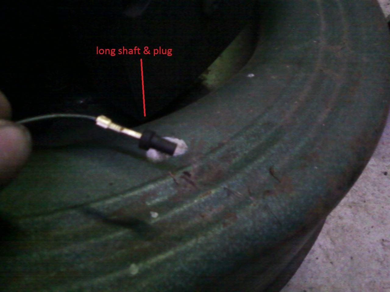

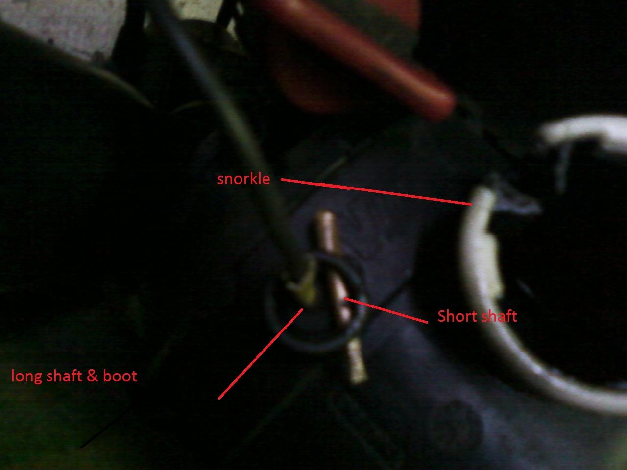

probably a silly question but I just cant figure out why it doesnt work! I rebuilt my powertorque engine and when i put the carby back I seem to not be able to connect the kill switch wires correctly to the carby..
no matter how i plug them in it still won't turn off frown is there a specific way to do this? i must have done this a dozen times before with no issues.
any help would be great!
The wire with the rib on the brass peice goes in the middle (with the rubber on it) and the other is the one that gos accross...
Sometimes they can get a bit tricky and wont turn off, the best way I deal with those is to have it running, With the thrtttle in the stop position reach in behind the carby and push the center wire, and wiggle it a bit until the engine stops.

Hey there, make sure also that your rubber plug isnt all hard or it can cause the kill switch to not work. and that when you insert the longer prong , That the throttle in the the run position.

thanks heaps! my problem is that i am missing the little rubber bit that goes on top of the cable.. i will try and find one and refit.
