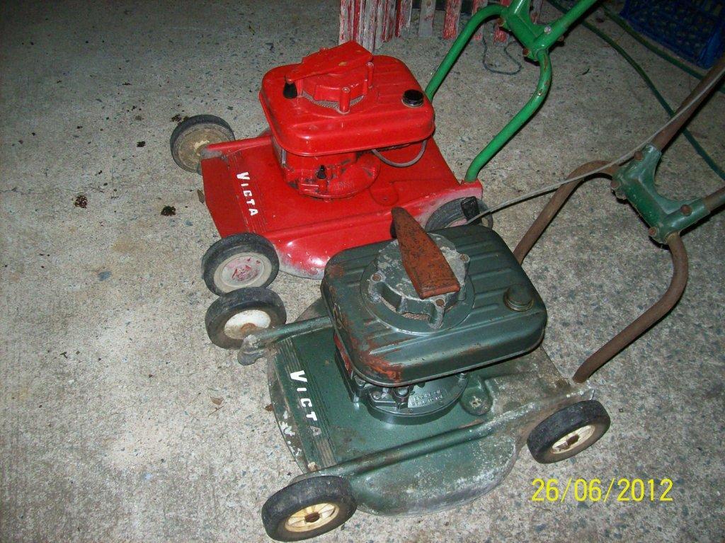

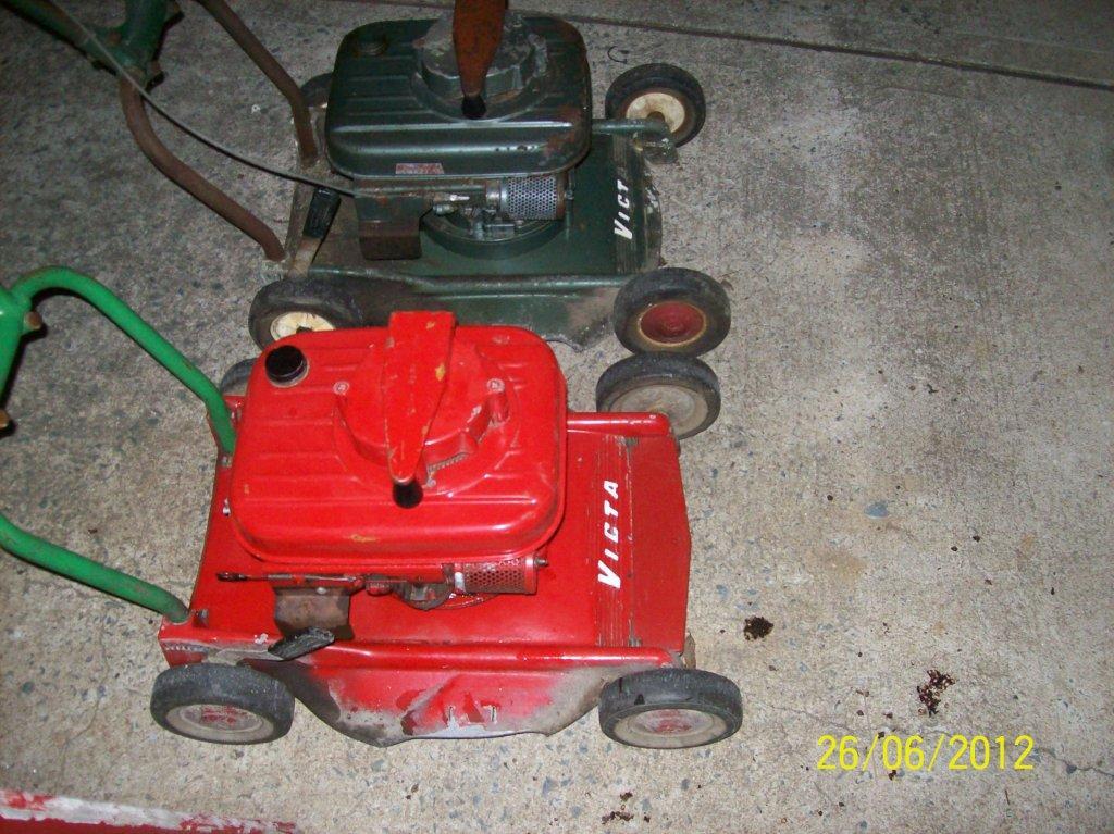

The model 7 is the red one.Also known as the Four Star.Was made in 1960-61.Should have a handle bar badge,saying Four Star.Which it doesn't.Now I need to find one.
The model 7A then is the green one.Was known as the Four Stroke (I don't know why they didn't come up with a better name.I mean how basic of a name is that?)Was produced in 1961-62.This one didn't come with handle bar badge.Which I find strange because in the Victa green book it does.However in the book it has the Four Star badge which is wrong.Also the Four Star badges where red so I guess it would look out of place.I'd say that they just copied the picture over as they are the same mower just a couple of years apart.

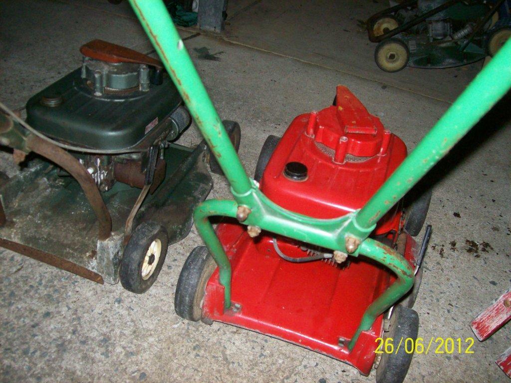

The Four Star has half of the front flap (as you can see here) There should be a metal part hanging down from the plastic top flap,but it isn't there.

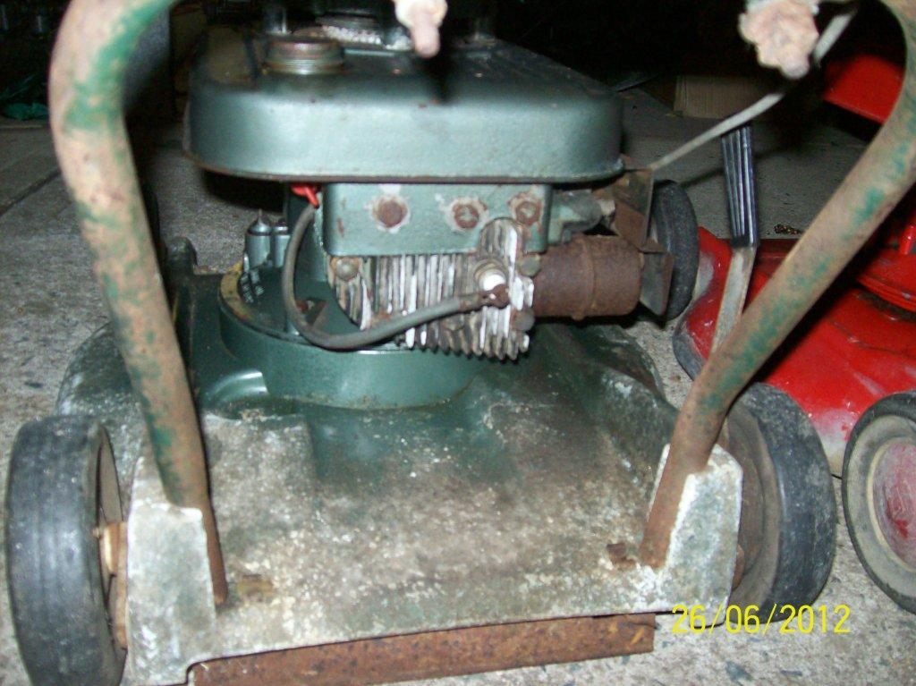

The Four Stroke has the rear flap (as you can see hanging underneath).This is a metal flap.Both the Four Star and Four Stroke should have front and back flaps,but over time they get damaged and fall off.I'm happy to see that at least I have some of them.

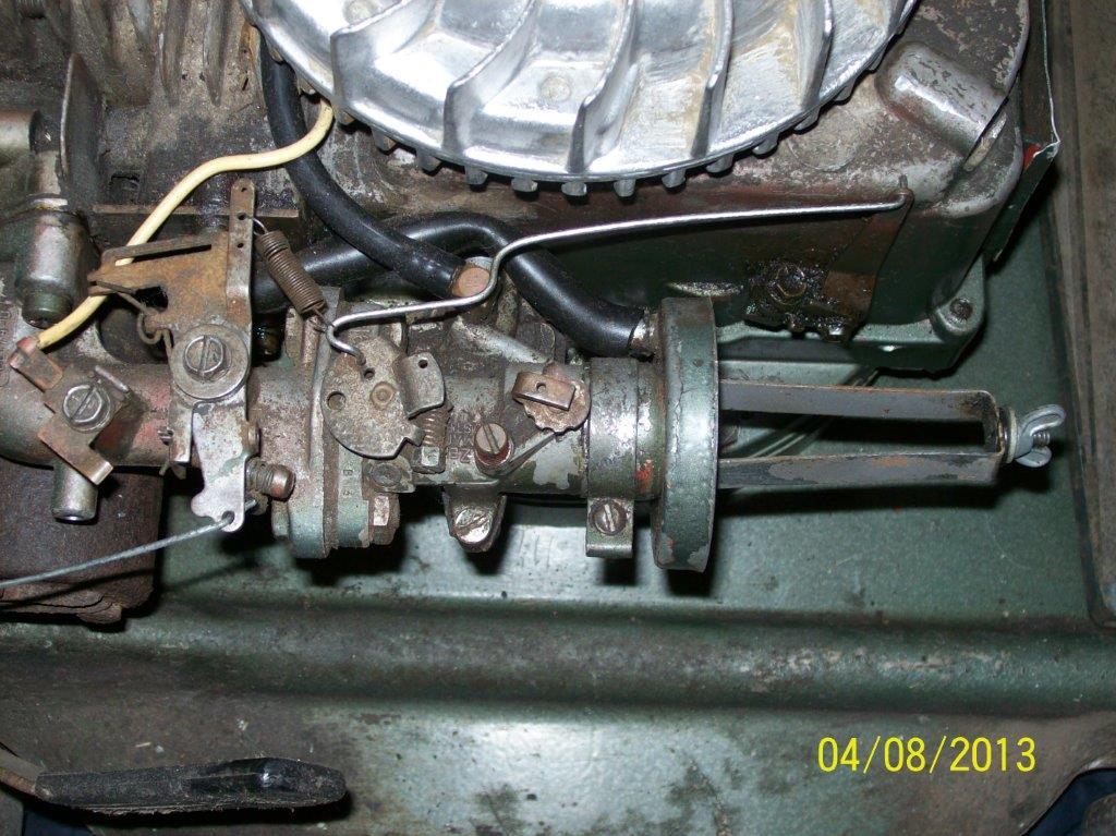

Now that I have got another flywheel for this lad I want to try and get it going.The only problem is that somebody has changed a few things around.Which has made this very difficult for me to do.
This model was one of the few that ran the Zenith carby.Now somebody in there infounat wisdom decided to put the linkage arms of the Walbro carby on it.Which I could clearly see wasn't going to and or wasn't working the way that it should.
However now the problem is I have to make up some new linkages.The problem with this is I can't find a lot of info on.
Here's what I have so far.
So I almost have this linkage where and how it is suppose to be.I'm just having trouble with the second linkage.

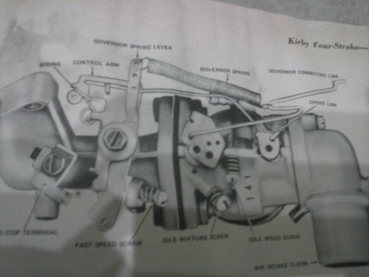

Now I have to do one from the choke,marked as 1 here.Now I don't know if it is suppose to go to number 2 or 3.Does anybody have any idea? Or better still does anybody have any pictures they could take so I could see how they go?
That would properly be better.As I just can't find enough info to show me where or how the linkage should go.

ill duck out to the shed in a while and take a photo of my kirby.
should be close to the same set up
Thanks tomo that would be great.
Choke rod goes From choke to position 3
Govenor to throttle link goes in the other hole
The spring joins what would be the centre of the govenor link rod where you have made the S bend. Just sharpen the S bend a little more and join the spring to the part of the S closest the engine.Then the other end to govenor spring lever (Your 3)in the 3rd hole(closest the engine).
The choke rod goes from the choke(your 1) to the slot/slide on the control lever(your 3)
Position 2 is not used. hope this helps.

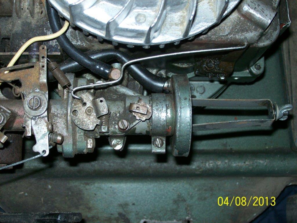

realized i had the set up in a book
Joined: Feb 2013
Posts: 194
Hope this ones helps, sorry about the quality, best I can do in the dark!
Let me know if you need something clearer.
Wow thanks guys that will help heaps.Will now have a go at remaking them tomorrow after work.Let you know how I go.
OK guys I have made up some linkages that look like they are working.I guess I won't know until I get it going.Thanks to all that have helped.I'll let you know if and when it all works.Fingers crossed.
