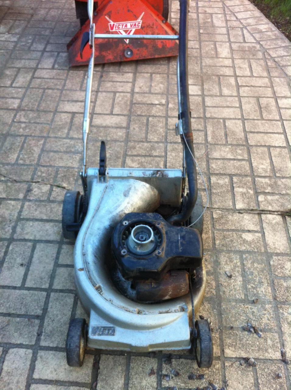

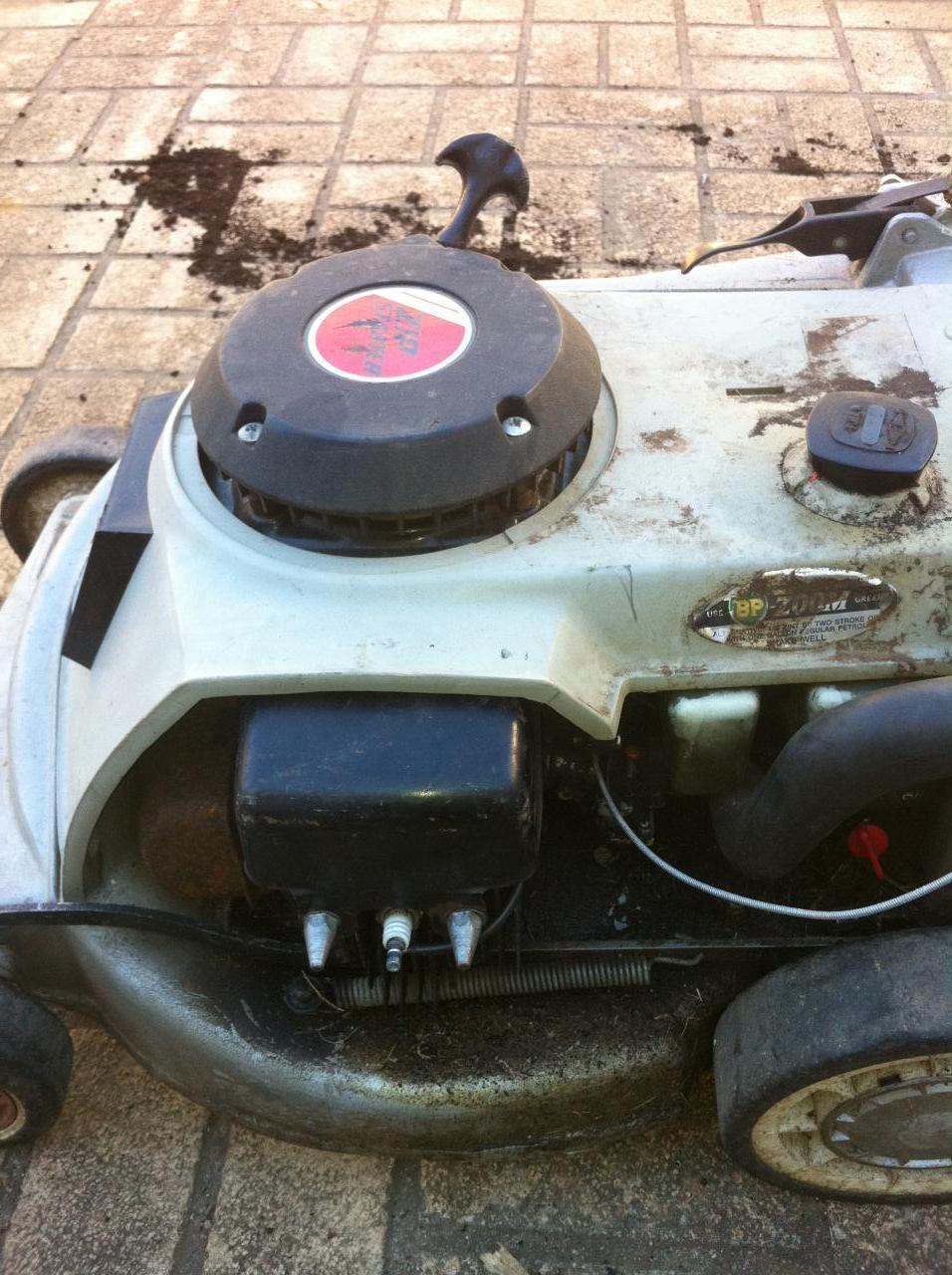

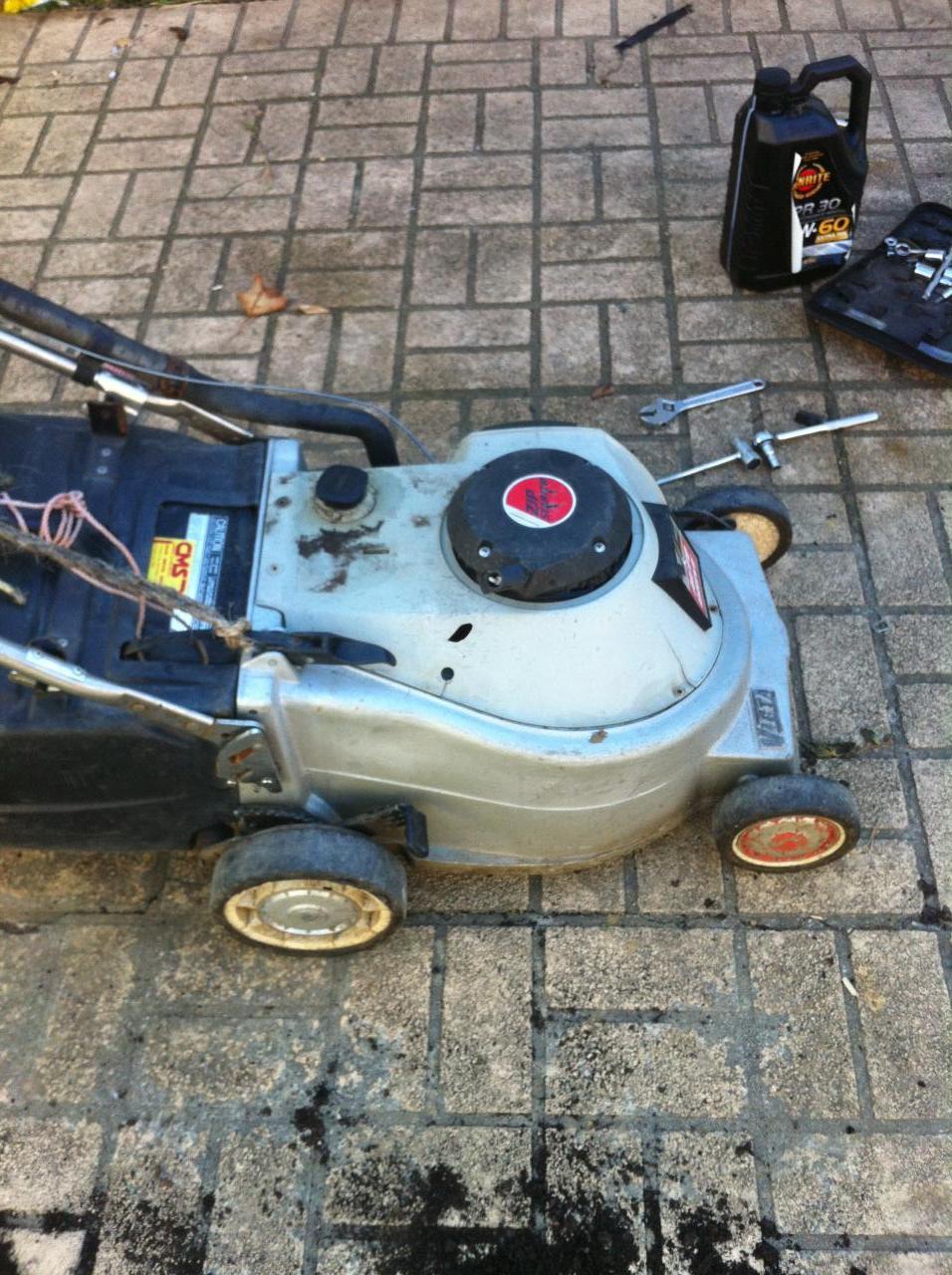

I picked up this one today, everything is in pretty good nick, gearbox is good turn over and engages, ive pulled it down to clean it back and give it a new set of seals, eveything is pretty tidy on her aside from missing a few parts such as the drive engage handle, the covers over the drive belt and the drive cable. Something to work on for the time being.
stamped in the crank----- 06 730473

OK, what you have here is a 1973 Series 2 VC-160 Auto Drive, Code V136.
Series 70 MKIII Engine, with the G3 carby and Decompression "Zip" Starting.
If you need copy's of the gearbox service manual, the engine & Chassis Manual, or parts lists for this one, let me know, and I’ll bring you some copy's.
I'll have a dig around and see what parts I have here that might be of use to you.
I could possibly post a self propelled lever and cable from a power plus victa that might suit (Ty, you are the expert here) They look like similar parts....
I dont think the lever will do it joe, this one used the full lenght metal bar type, like this:
However I'll investigate the cable dimesions, I have a feeling the cable may be the same.
