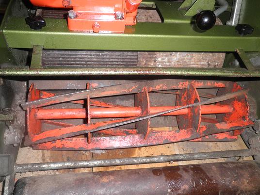

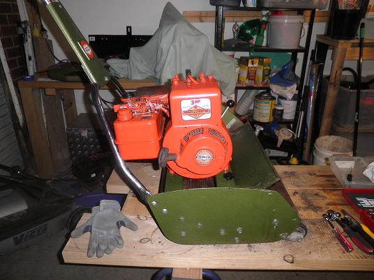

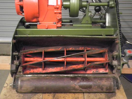

Hi scoffey86, and thanks for the pics...the machine looks in brilliant original condition for its age and obviously hasn't done a lot of work, except, maybe, for the cylinder reel. wink
My observations from the pics:
(1) The machine is a genuine Scott Bonnar Model 45; 17" cutting width, with original paint scheme, vertical chain-case screws, black plastic grass deflector knobs, plastic front roller end caps...3HP orange Briggs and Stratton....all pointing to a build year of approximately 1977 for the chassis. (Not that far apart from my own machine, which is almost identical, originally)

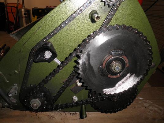

(2) The sprockets and chains are in form what appears immaculate condition for their age. They look a fraction tight in the pics, and maybe require some adjustment....easy-peasy to do; and can do with some good quality grease to keep them in great condition for the future.
(3) Looking from the front, the right-hand rubber grass catcher support block is missing....you will need to replace this...as it is important that the catcher sit level on the machine to do its job properly. wink
(4) The cylinder reel (as Rossf has said, has plenty of meat left) is correct, but the damage that has been caused...(bottom to middle blade, first pic, Right-hand, fourth quadrant; will need to be straightened by the engineer that sharpens (spin-grinds) the reel, which it desperately needs, to do its job properly.
(5) From the condition of the cylinder reel, I will guess that the bottom (knife-blade) will need attention from the engineer as well...for instructions how to remove it; (as both the reel and the sole-plate (complete with the bottom blade) need to go to the engineer at the same time...Click.... HERE wink
(6) For what happens there at the engineering workshop and some tips...Click... HERE

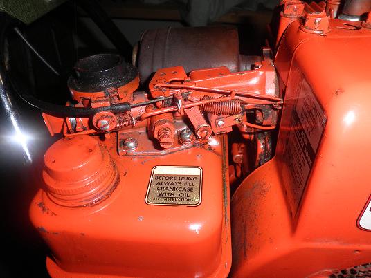

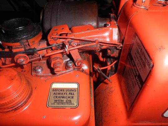

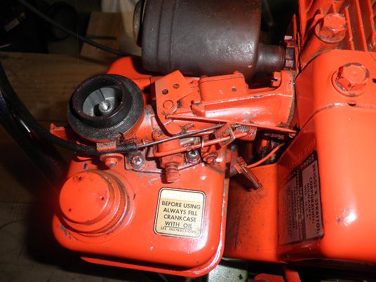

hi grumpy, tried what you said about the spark plug. No spark what so ever...
So I'm assuming that this kill switch could be the issue.
So I had a look at the choke area that you mentioned. All seems to function well moving as I move the choke lever.
I have found a wire that is just floating in the breeze, this cant be correct. Any thoughts? In the pic it is inbetween the fuel tank and the pull cord.
The first photo is with choke on, then the second with choke off.
That looks like the kill wire terminal that should be attached to the governor mechanism. However it seems to be floating around not touching anything, so by itself, that would not kill the spark, it would prevent you from stopping the engine.
It appears you will need to remove the cooling air cowl and trace that wire, to see whether it has become grounded somewhere along its length.
