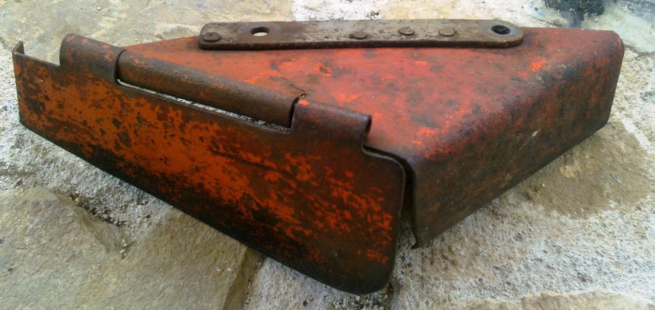

I'll get some photo's up of the one I have, and if you want it, I'll send it, Otherwise I'll keep my eyes peeled for another!

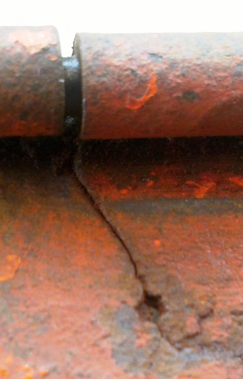

Here is the one I have, its not pretty, but it does the job, and it's yours if you want it.

Sorry to take so long to get back to a reply. Yeah that chute flap doesn't look pretty but it will do you the job. I could definitely use that old chute and possibly make a new one at some point later on.

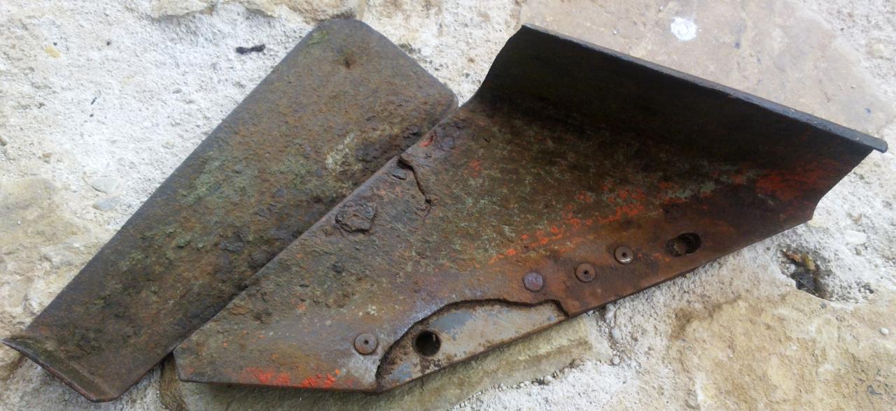

Place up the road has a machine that rolls the flat into the C perlin.
I just got an off cut, i think it was 5 inch.
Got some stainless hinges from a stall at the laverton market.
I think i made up 3 or 4 of them out of a bit about 2 foot long. I cheated, i cut them out with the plasma cutter. You could use a grinder.
Also in the picture is the height thingy with the holes in it. They split and flap around and wont hold the head of the handle bolt to do it up. I welded it too a handle mount plate for a steel base victa.
