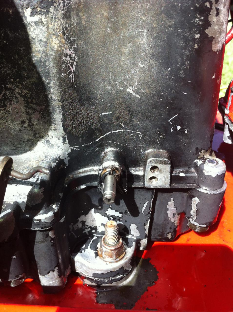

Posts: 14
PS - the photo above shows the engine after it was degreased and before running and showing the leak. The leak is around and below the governor crankshaft
I don't think your picture made it onto the internet, so perhaps you could try again. The breather is a tube that runs from the positive crankcase ventilation valve, near the valve chest, to a position at the bottom of the air cleaner, before the carburetor's venturi and throttle.
The govenor shaft should be above the oil level. The only oil it would be exposed too would be splash.
That O-ring held with the R clip like that does not look good and would never work. If you had enough room to put the o ring then a washer then the clip that might slow it down. Only thing you would need to be carefull with would be drag, too much and the govenor will not work propperly.
Breather valve is usually on the valve chest cover.
