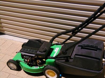

Got this Victa two stroke last week. My intention is to keep it for the odd time I need a rotary mower or if someone wants to borrow one.
The problem with it was the carby, the white plate with the primer bulb was cracked and the needle was damaged. So I swapped all the good parts off my old Victa Tilta Cut engine onto this one. Including Carby cover and gasket, fuel line, fuel tank and covers, plus throttle control assy. Plus some 2nd hand wheels.
The mower starts first pull and runs fine, but when you pust the lever into stop postion it dont stop. Looking at the carby the white cam appears to be pushing sideways on the brass pin in the stop position. Also where the throttle cable joins onto the carby it is only in the first hole. SHould it go onto the 2nd hole? (The outer spring that is)

Problem solved, after a coffee and a few Tim Tams
Was the rubber grommet on the brown wire. Had a split in it
