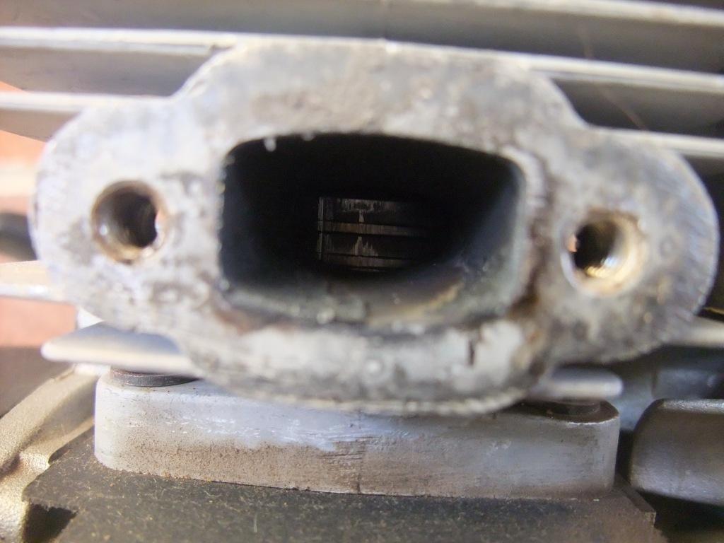

I forgot to put oil in my Victa Tornado Plus Trimmer and the engine has siezed.
Can someone please advise a list of parts I will require so i can find out the cost of them to do the repair myself?

Let's see how bad it is, Can you pull of the muffler and get a clear photo of the piston side skirt down the exhaust port?

I took a photo after removing the exhaust and this is it:
I actually got it working. It was seized and the rip chord would not move the piston. So while I had the exhaust off, I sprayed it liberally with loctite "Freeze & Release" which I use on siezed bolts successfully at work. I then removed the rip chord and tried turning the piston over manually. It worked!!
So put it all together, again, fuelled her up (with oil...........) and now she works again. I gave it a quick workout and I couldn't notice any loss of strenth.
I guess I will only know its fully OK if I do a compression test.
it is hard to see, but in the photo the piston is scored (scratched) from top to bottom on the left hand side; so there could be a loss of compression due to this.
Does anyone know what the compression pressure range should be for a healthy machine?

I'm not sure what you should expect for the compression sorry, however, my thought, for what their worth:
Considering the repair here would be to replace the Piston and either hone, re-bore, or replace the cylinder, I would suggest it is OK to keep running as-is, if you are not noticing any ill-effects.
Provided it seems to be sounding as it should, providing the necessary power, and not showing any new vibration, I cant see it becoming an extra issue.
You may well find the piston wears out sooner than expected now, but then you just take the above action when needed.
Considering it is working, if it does start to show problems, re-asses the damage by removing the piston, and possibly changing the rings.
