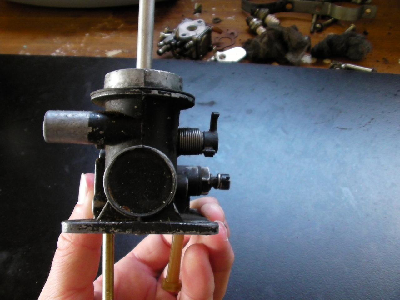

Hello everyone,
Whats a good replacement engine for a rover colt 5? The briggs that was on it had a rusted carby and i couldnt find a new one anywhere so i gave up and decided i will buy a new one. On ebay there is a 5.5hp briggs quantum that is $299 free postage and there is what looks like a chinese copy that is 6.5hp for $289 would one of those be suitable or can anyone recommend something else either new or second hand? I live in Tassie btw.
Thanks,
Jarrod

Hi Jarrod, if there is nothing wrong with your 5 hp Briggs except a rusty carburetor, that sounds like a poor reason to replace the engine. Why don't you post pictures of the engine and carburetor, tell us which parts of the carburetor are rusty, and post the full string of numbers stamped into the air cowl, so you can see whether someone here can help you? From memory there aren't many steel parts on the carburetor, you may be just talking about the governor's base plate being rusty. That seems a very small problem to be replacing an engine over, especially replacing it with one that may be inferior.

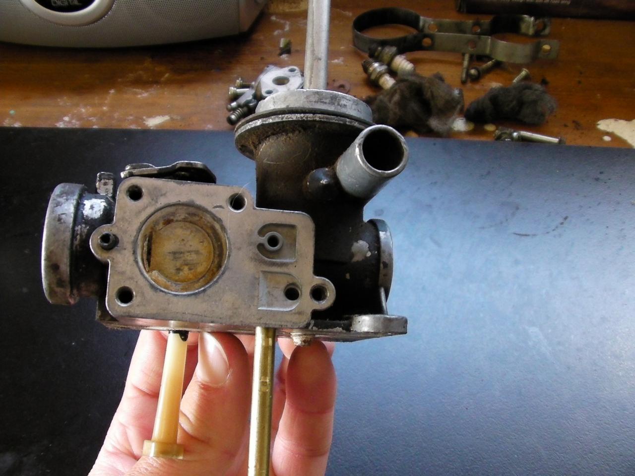

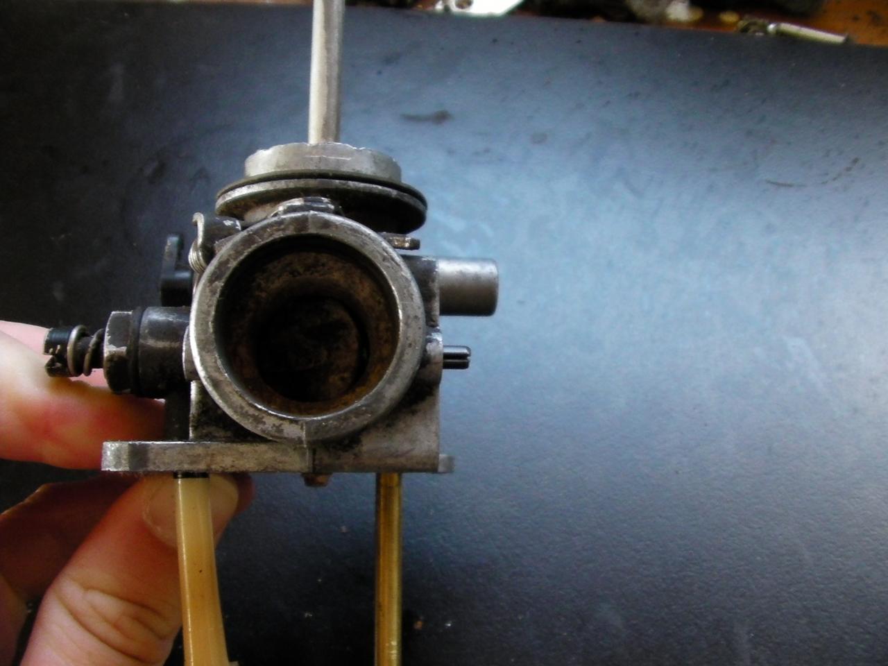

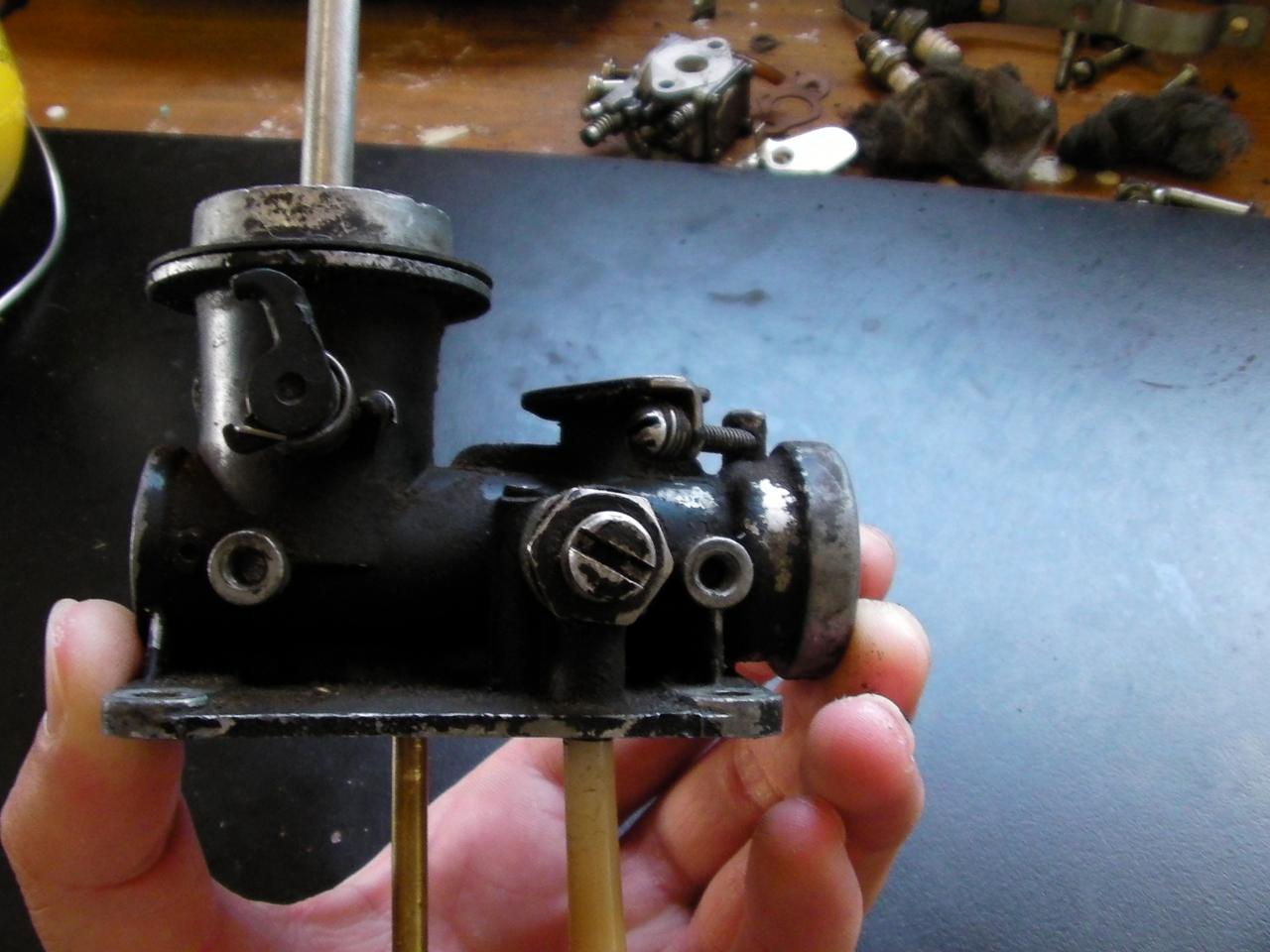

The bloke i bought it off had it sitting outside for several years and the carby had orange algae or something like that in it and the diaphragm needs to be replaced but i thought it would be a waste to buy a kit for a carby that was had it but i will still post some pics the numbers i found are Model:130902 Type:1175 01 Code:84051706 Hope that helps. I did find a new carby on a website called small engine warehouse but it doesnt say anywhere about posting to australia and im not sure if its the right one.

Jarrod, your engine is a 13 cubic inch (213cc) model of the first design generation, with vertical crankshaft, a Pulsa-Jet carburetor, plain main bearings, and a manual recoil starter. It was made on 15 May 1984. I don't see why exposure to the weather would do any more than cosmetic damage to a Pulsa-Jet carburetor, though there would be some rusting of the governor base and levers on top of it. The carburetor body is made of either zinc or plastic depending on your luck (zinc is better), both of which are very corrosion-resistant.

The carby has orange algae or something inside it but it probably wouldnt hurt to try a new diaphragm if that doesnt work i will look for a second hand one.
And now for something completely different!
Clean out that orange crud from the inside of the air passage and venturi. Also clean the mesh filter in the bottom of the brass tube that reaches down through the diaphragm. You will need to clean the interior of the carburetor and the main jet. Here is the Briggs manual for doing that, use the "next" key for subsequent pages:
http://recoveryvehicles.tpub.com/TM-5-4240-501-14P/css/TM-5-4240-501-14P_97.htm
Part of the procedure it explains is how to inspect the diaphragm. You do not need to replace the carburetor, based on what I can see from the pictures.
Thos motors are strong as a brick poohouse in my opinion, I did have one chuck a rod once and that was thanks to an owner that never checked the oil. I replaced it with another engine of the same type that was even older (mine was white and circa 1974) and it has outlasted the rest of the mower (the mower I pulled the engine from was worn out as well) lol
As to the carb, I would pull everything apart from it gently and leave it soaking overnight in either fuel or some heavy duty degreaser, try and clean every orifice you can find in it, blow air from an air compressor through every gallery and refit with a new diaphragm and tank gasket (around 10 bucks) then check the tune and go from there. smile
