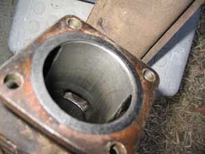

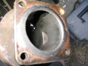

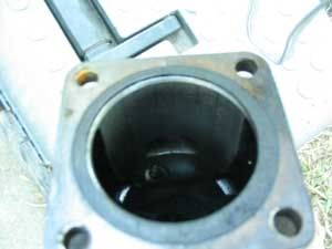

Hi James Looking at your pics I see one of the flywheel fins is broken . .I think you should consider breaking off the opposite fin to help balance the engine once you get it running . Did you get a Tank yet?/ Regards Joe

Actually two fins are broken ... if I balance them up will it affect cooling?
James
#3209 15/05/06 08:24 AM
Joined: Apr 2006
Posts: 30

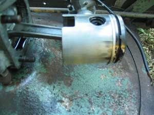

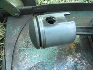

Nasty ... time for a new piston and rebore I think? One of the rings has broken up some time ago and banged up the piston ... can hear a few bits of ring rattling in the exhaust ... no bits remain in the ring recess or in the cylinder (should all the bits have gone out the exhaust?).
Can you still get a piston for these models? I will check the bottom seal like you suggested ... should I just replace it now we have come this far?
BTW if I replace the bottom seal, there is lump of round steel on the bottom of the crank (below the bottom seal) that the blade plate backs on to ... is this on a spline or is this yet another nut I am going to fight with? rolleyes

Can you please confirm the ring order on the piston ... I have one with white steel layer on black, one black and one thin kinked one. I am assuming like so:
top groove: kinked on then black ring on top
bottom groove: white steel layered ring
James
#3218 20/05/06 10:08 AM
Posts: 5,419
Likes: 36
James,
The piston ring that has a silver colour is the top ring and the black coloured is the bottom (one nearest the skirt of piston). yay

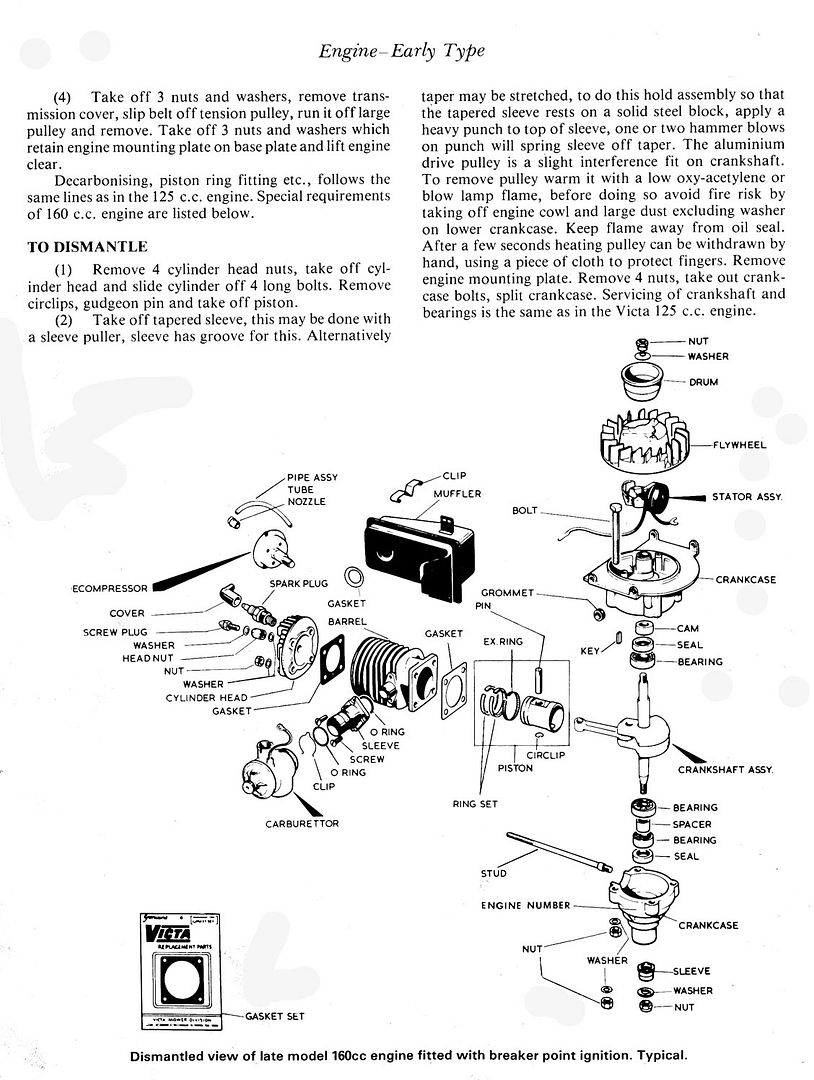

Do you have the crankshaft out of the top housing(point side)?
The top crank side should be 20mm shaft and if so the top bearing will be correct.
As to getting out the top bearing you need the crankshaft out then you get a drift to drive the bearing towards the centre as you will see in this drawing.
[Linked Image from i65.photobucket.com]
