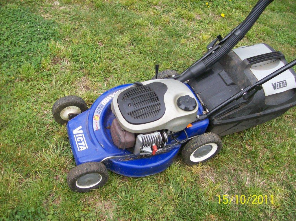

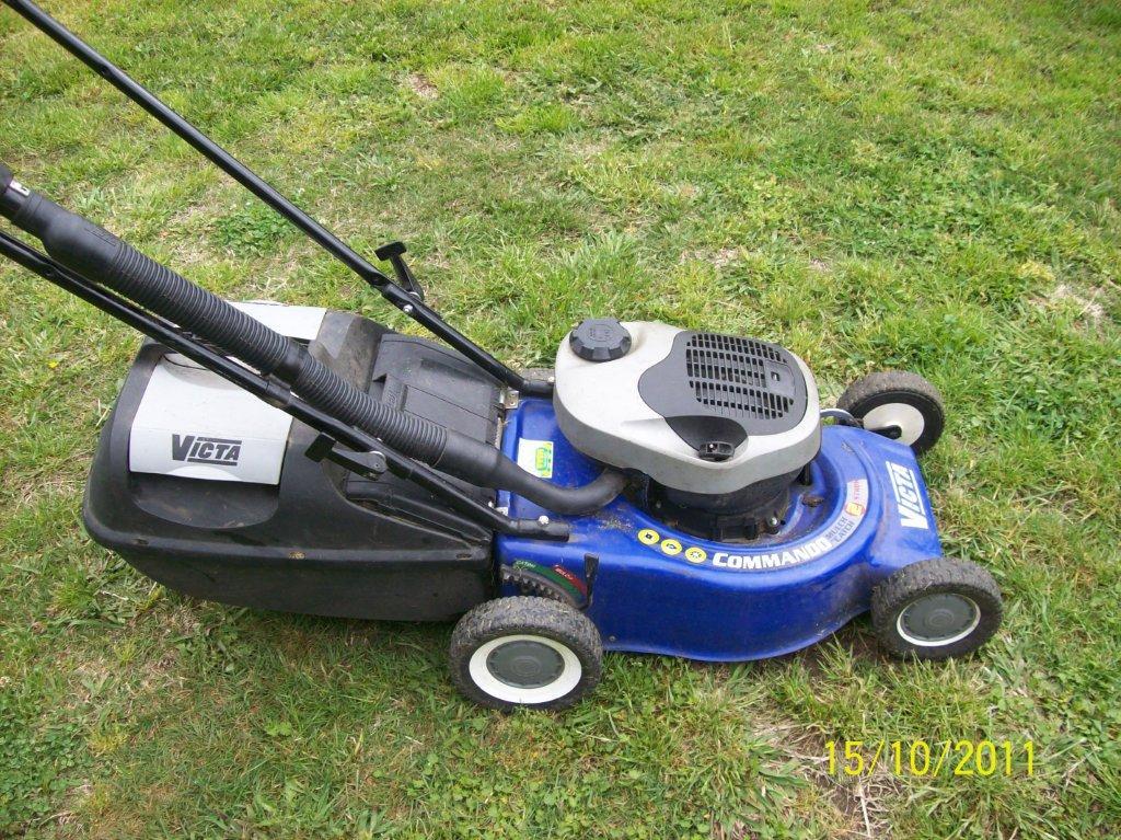

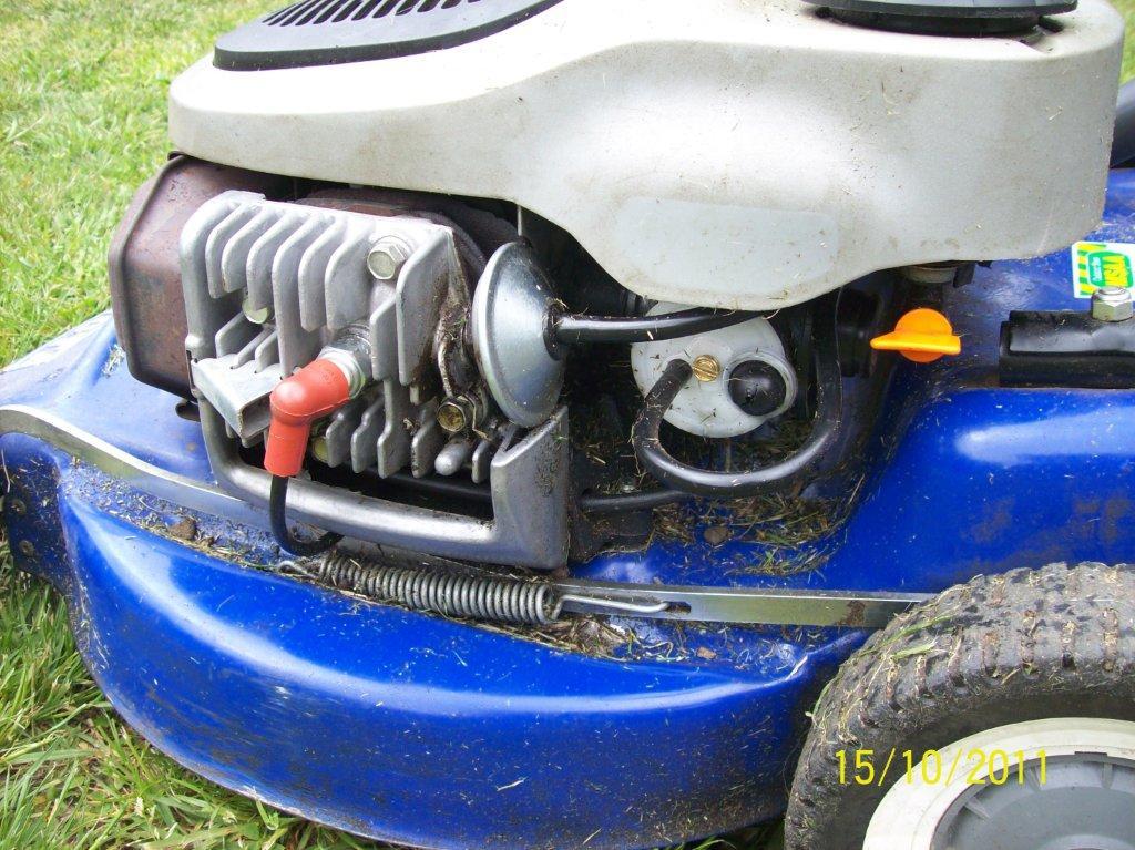

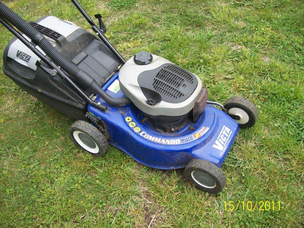

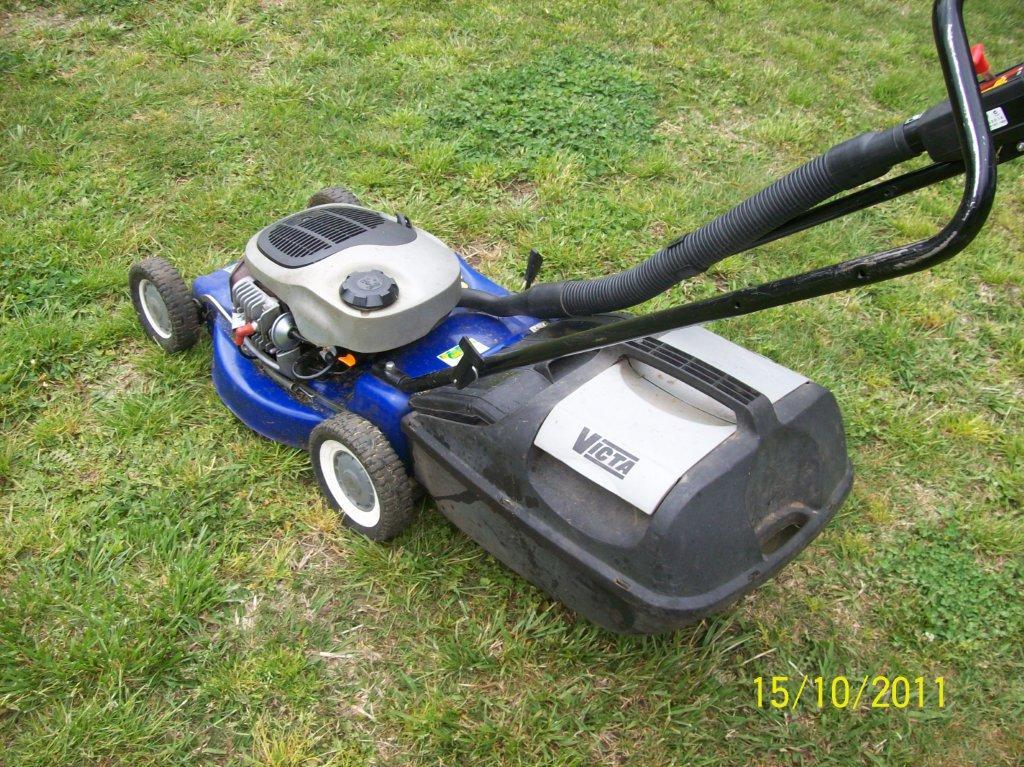

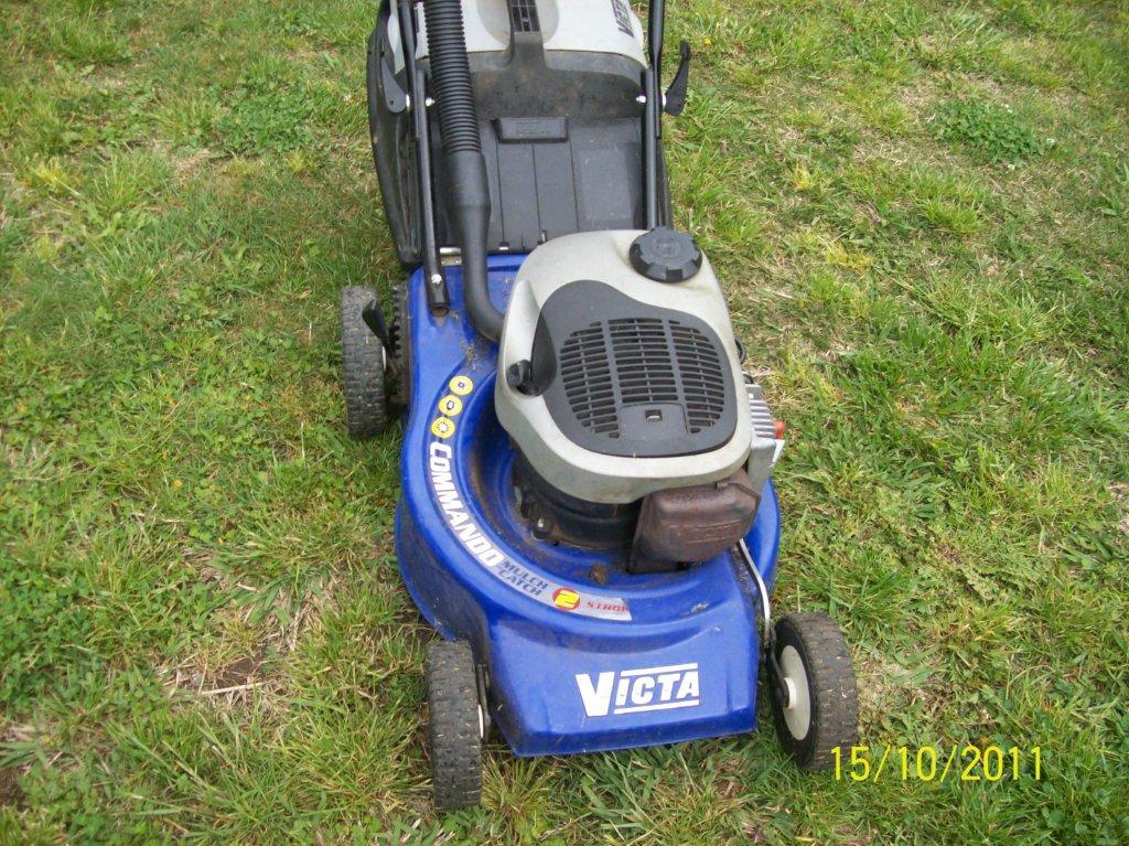

Had a Victa Commando dropped of to me yesterday.Paid $15 for it.I was told that it would start but not run.After looking at it for a few seconds,I noticed it was leaking oil.So I took of the fuel cap and all I could was oil in the tank.So I drained the oil and and the carby.Put in a fresh batch of fuel and on the second pull it run.It didn't stop.While it was running it started making a funny noise.The blade disc had come loose.After Ty changed the washer and the boss.It was all good.Not bad for $15.Here some pictures and the you-tube link.Just to show you how much it was smoking after it got going.
